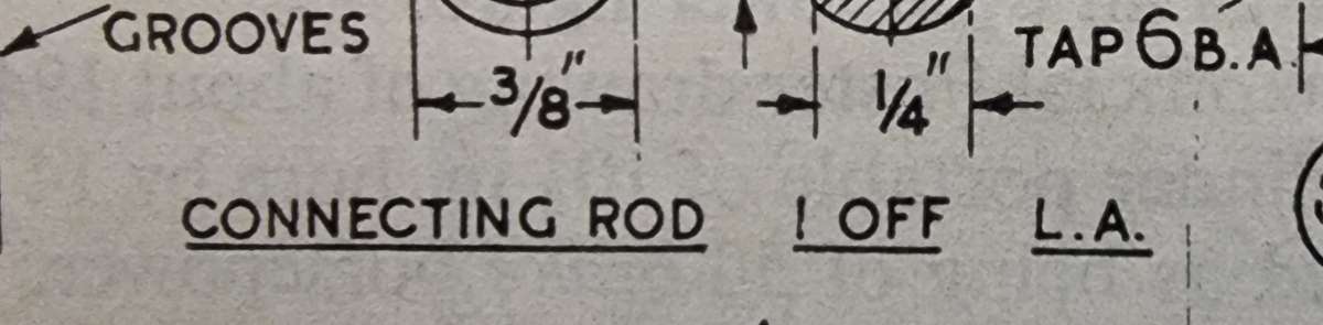

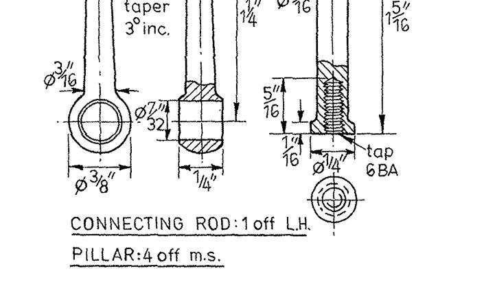

      I have been studying the plans and all is OK except for the connecting rod.  The drawing states the material as L.H.  I assume this is a drawing error and it should read M.S.  But I thought it prudent to check with the forum members that I am not missing something obvious.
      I am confident that L.H. for ‘left hand’ doesn’t apply in this case.

      #735177
        Could be Light Alloy where an H has got in.

          #735187
            That would confirm it Rod, it will be 2014 in new money, the old HE15
            The single sheet drawing that I have has the LH “Light Hlloy”
            light halloy

                    Alan Donovan
                      @alandonovan54394
                      Hello again.
                      Thank you all for your input.
                      My drawing is as per Jason B’s image.  It all makes sense now, even though I have never heard of Hiduminium either.
