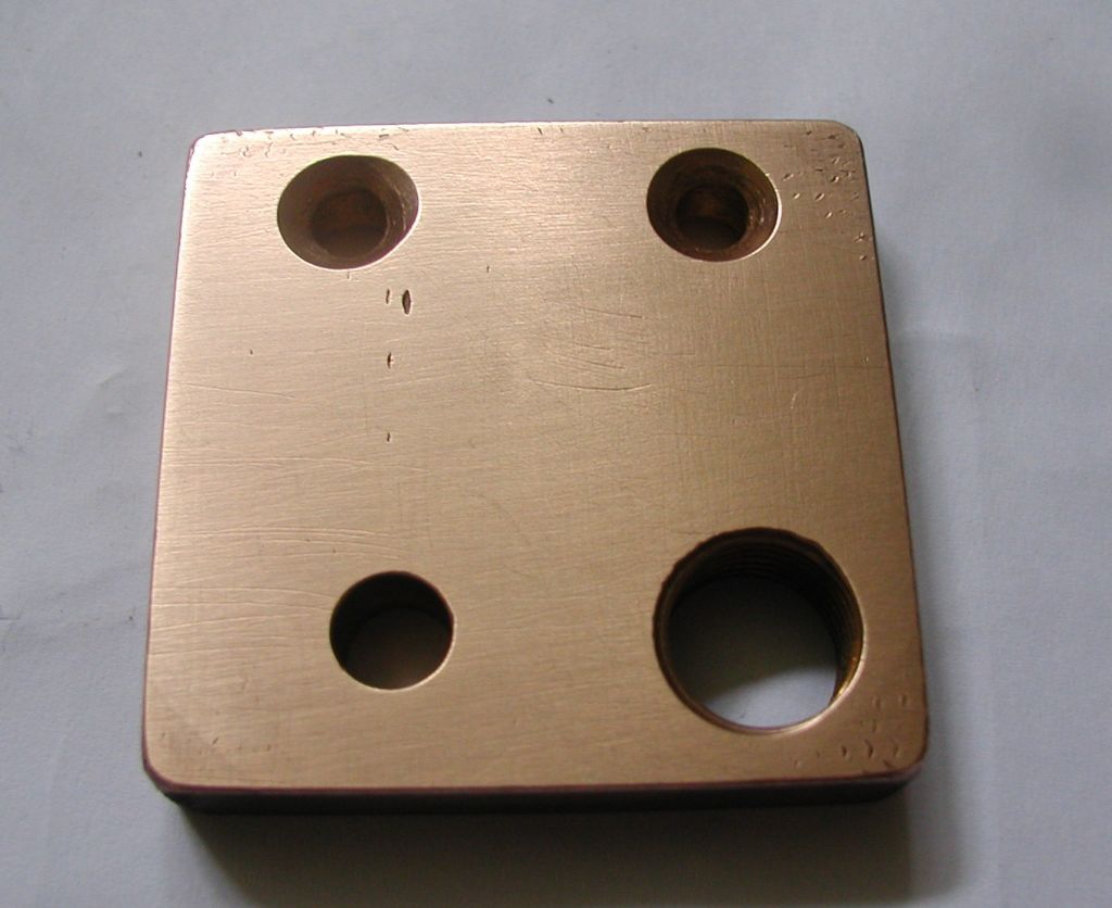

                      #158523
                      Nicholas Farr
                        @nicholasfarr14254
                        Hi, here is a piece of Ali-bronze. I don't know what grade it is, but it is a slice from a worn out nut that the turner at my old place where I used to work used to make for a palletizing machine, the big hole at the bottom R/H corner is where the grease nipple was screwed into. This piece has no magnetic attraction that can be detected with a permanet magnet.
                        Ali-Bronze
                        I have just removed it from a special camera mount that I made many years ago, and have given it a quick rub up with some of that fine scotch type of stuff, but it will polish up to a very nice lustre, but will tarnish quite quickly. It is a nice metal, but has a kinda stickyness to it when drilled and will very quickly get hot and grab the drill bit to a stop if you try to drill to fast or heavy.
                        Regards Nick.
