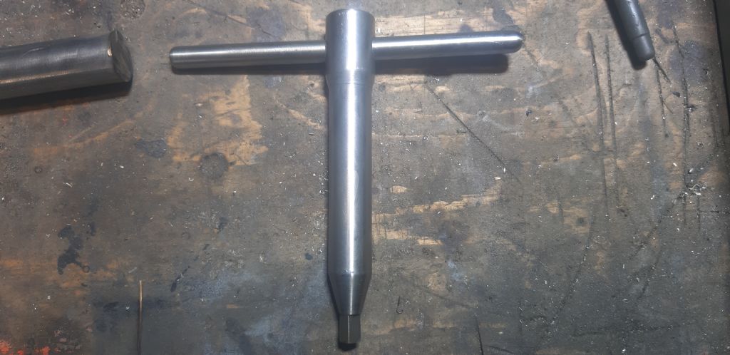

      So I'm just getting back into machining. The first thing I made was a chuck key for my 4 jaw. It isnt very big and the square end of the key is only 7mm across the flats. I forgot to leave additional length so the available material in the square end is reduced by the centre drill. I made it out of black mild steel from my local steel supplier. I used it today and the square end just twisted into a spiral.
      Should I be using a specific grade of steel or do I need to do something to it after machining to make it suitable in this application?

                  I did use larger diameter stock (25mm). Since I hand cut the square I'm wondering if I was a bit undersized and combined with the center drill just didnt leave enough stock. This is the before photo. I'll add one of the damage tomorrow.

                    That is an overly large T bar for the size of square. I would say therein lies the main problem. Half that length would suffice. That and the hollow in the square from your centre dilling.
                    regards Martin

                            T bar is way too long.
                            Tony

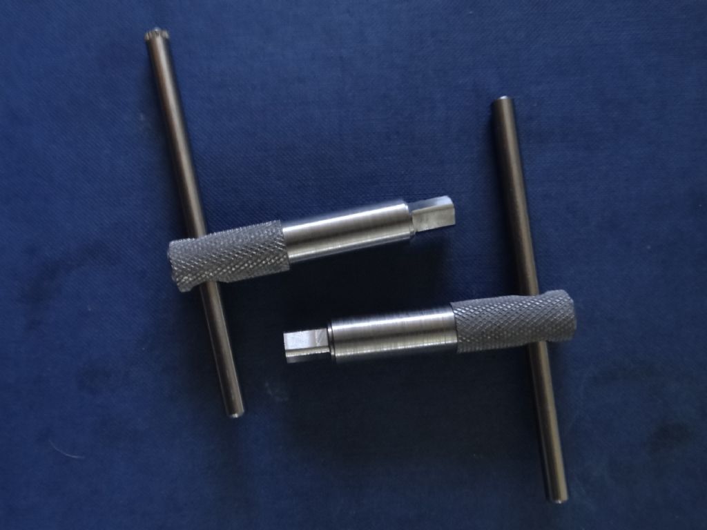

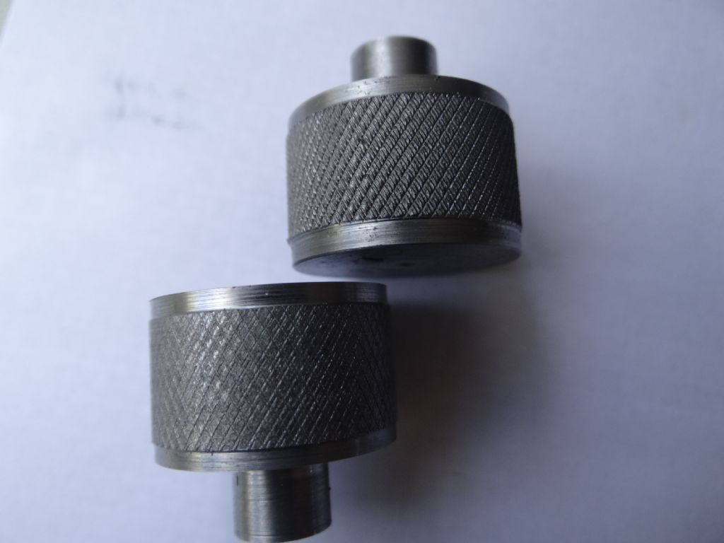

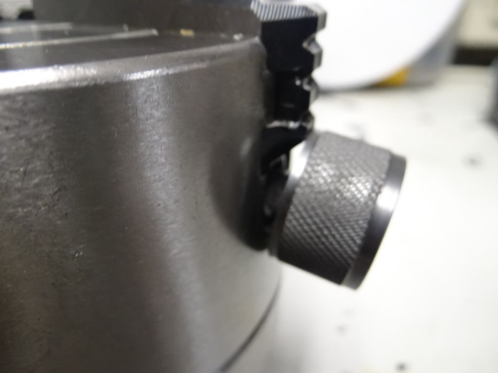

                              Too short is bad too! My genius let me down badly with these:
                              I thought short, fat adjusters would make it easier to rapidly centre opposing jaws by twirling. Brilliant, until they foul the jaws:
                              Silly me. embarrassed

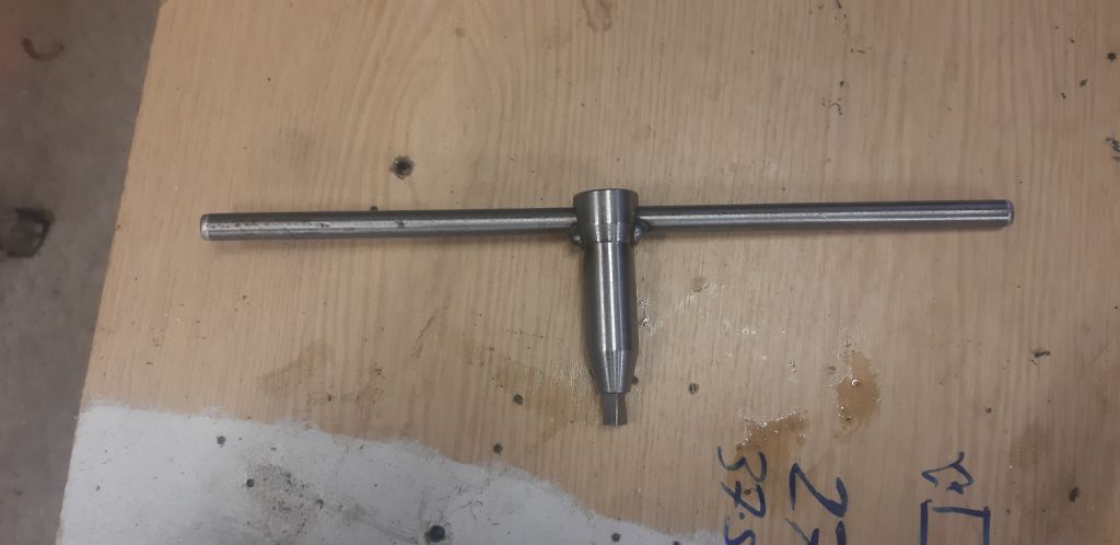

                                  So I'm going to have another go at making the chuck key this weekend. I've got myself a length of EN40b and EN8 and was going to make one from each (for practise). I'm using HSS tooling. Is there anything specific that I need to consider now I'm using these specific grades? Also as I dont have a mill will I still be able to file the square end?

                                    3 To keep the flats the same length, make a collar and clamp it to the shank, to act as a length stop.
                                    With a square of only 7 mm , the chuck would seem to be small, so a long tommy bar is not needed, and as you have found out, damaging! Probably 125 mm would quite sufficient, 150 mm max, in my book.

                                        Thanks for the input. Mk 2 in EN8 – much better!!
