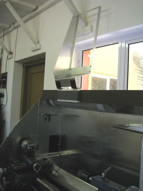

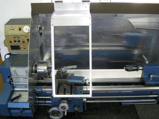

                                      Hi Martyn,
                                      I made a guard that can flip up out the way, and can also slide away to the right, on an angle aluminium section on the top of the swarf surround guard – used Perspex, which if not known in the UK is probably acrylic – seems to work well and is easily replaced and inexpensive.
                                      You can just see the slide on the upper part of the covers here:
                                      Here it is flipped up – photo taken while the Lathe was undergoing refurbishment;
                                      Joe

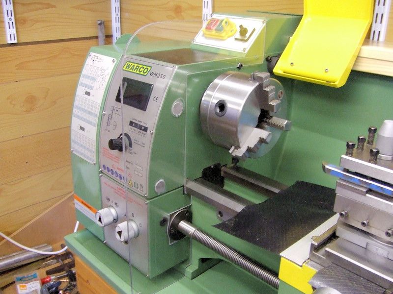

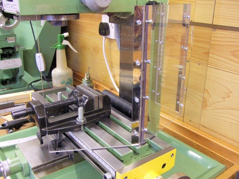

                                          Definitely polycarbonate, it can be easily cut using a jigsaw and I found that you could use a plane set to a fine cut to smooth the edges. It can be drilled easily to take bolts but it will crack. I used 6mm to make guards for the lathe and mill
                                          Gaurd on the lathe headstock to stop swarf finding it's way on to the top and under the gear box. Held in place by two magnets. It fits between the headstock and the chuck guard.
                                          Folding guard on the mill; as can be seen polycarbonate is very clear when new. It does scratch easily and gradually becomes opaque as you clean it.
