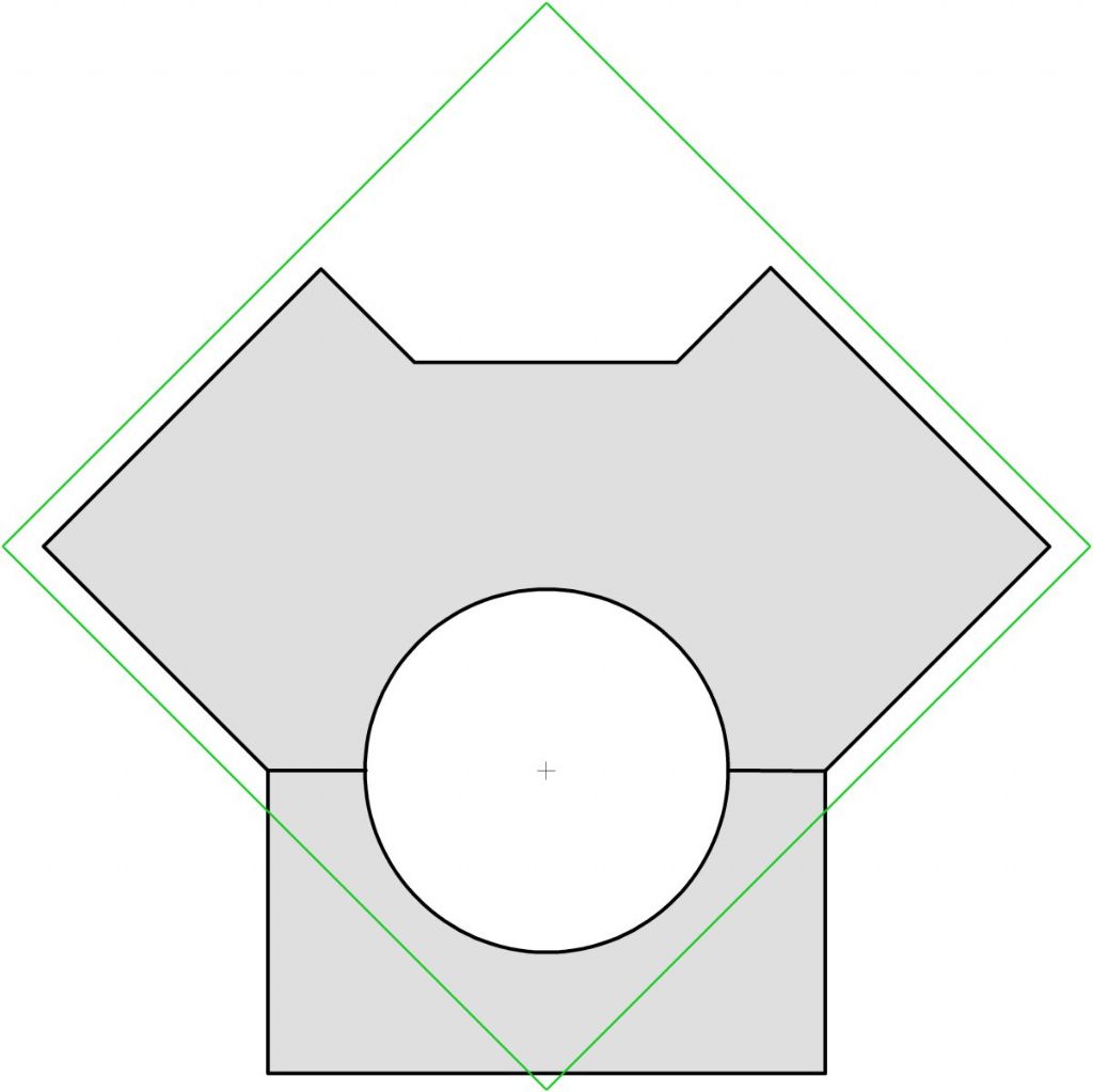

                      Another potential problem is I will be drilling/boring out the crankcase and sump out of 2 pieces bolted together. This picture should give you an idea of what I mean…
                      The green line is the outline of the 1" square bar and the sump will be made from 3/4 x 3/8 (or 20mm x 10mm) bar stock.
                      If I were to make the two pieces of different materials, would I run into problems drilling and boring? I should imagine a drill would want to wander into the softer of the two?
                      If anyone has experience of a situation like this, please let me know.
                      Steve
                      #478685
                        Drill will likely wander into the soft material but as you are going to finish it by boring that should not matter, could always drill will an end cutting milling cutter which should be less likely to wander.
                        Could you get it out of a single piece of round? really depends on whether the joint is needed for assembly or if you are just trying to save metal.
                        #478696
                        Steve Crow
                          @stevecrow46066
                          I'll be boring and drilling on a Sherline lathe and the hole is 12mm dia and 50mm long so I think I'll struggle to hold a big enough end mill in the tailstock.
                          If I can find the headroom on the mill I see that Arceuro do a 10mm 45mm long end mill that I could get away with.
                          The joint is for assembly so I can get the con rods on the crank.
                          #478768
                            As you will only be using the milling cutters to get upto a size that your boring bar will fit I can't see why you could not come in from each end so a long series mill would not be needed as you only want to go full depth with the bar.
                            What material were you thinking of for the bottom half? If just another grade of aluminium it should be OK but something like steel/ali would wander. Also what engine is it based on?

                              #478829
                              Steve Crow
                                @stevecrow46066
                                Thanks Roger, I shall have a look at that.
                                Jason, due to my method for holding the piece, I can only drill from one end.
                                I would prefer for both parts to be the same material, I'm just sounding out ideas.

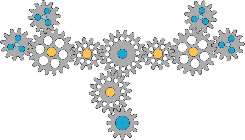

                                    I won't be attempting the quill drive and I don't even know what a "bomb" is! Maybe you can educate me.
                                    In fact, the gear train isn't strictly scale, more "inspired by". My model will be running on compressed air and will be two stroke so there is no reduction between shaft and cam. Here's a drawing.
                                    As you can see, this is a simplified version designed to resemble the original. This is with mod 0.5 gears, if I can cut mods 0.33 or 0.25 gears it would be more realistic.

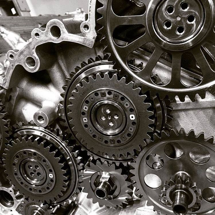

                                      Here is the front end drive with a close up of the compound spring gear and the torsion sheeves, earlier gears (upto about 1978) had the sheeves (torsion bars) displaced axially, this is the first photo, as the rev capability increased to 14,000 this became a problem so the sheeves were displaced radially as in the 2nd close up photo here.
                                      I later worked on an V10 F1 engine that in its early form could snap the nose off the cams within 1 hour of running on the test bed. We instrumented the engine up and found a +/- 15 degree of crankshaft to cam position variation due to the immense torsionals. As a development engineer I had originally commented to the designer that the cam drive should have been up from the rear of the crank. We overcame the problem by modifying the drive to the cams via a quill drive from the front mounted gear which was isolated from the camshaft (mounted on a needle roller) – the quill drive was then taken to the centre of the cam (well between cylinders 3 and 4).
                                      All the Cossies were beautifully designed! and a treat to work on – much was derived from the Merlin as Duckworth (partner to Mike Costin in the Cosworth business) was an ex Rolls Royce engine man. The crank nose gear was a tapered fit on the crank and required a 12 ton press to disassemble.

                                      The 'bomb' was the ignition distributor mounted in the centre of the vee and driven from the front geartrain. It was called the 'bomb' because of its uncannily resemblance to an item of air launced ordanance!
                                      If you have any questions I'd be happy to answer them – if I can still remember!!
