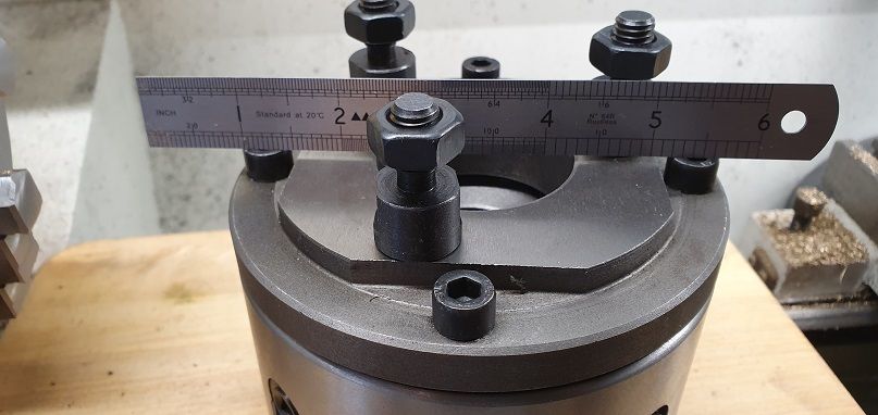

        I need to make a 5" diameter backplate like that in the photo (but without the protruding cap head screws) but cannot decide what material to buy. Despite the inevitable mess I'm leaning toward cast iron in case the milled recesses around the rim would affect the stability of mild steel, but have no idea if grey or ductile cast iron would be best.

            Ordinary cast iron will be easiest to get hold of, but if you can get the ductile iron, it is much less messy when you machine it. Steel would be third choice. Check whether that bore is tapered.

              I can see no reason why a slice off a 5"dia EN1 steel bar should not suffice. The milled flats seem only to serve as a space for the cap screws to go so could be left off just making the backplate a little thicker which would then provide plenty of room for the counterbore. If the cap screw heads in the picture are getting in the way why not replace them with countersink ones?
