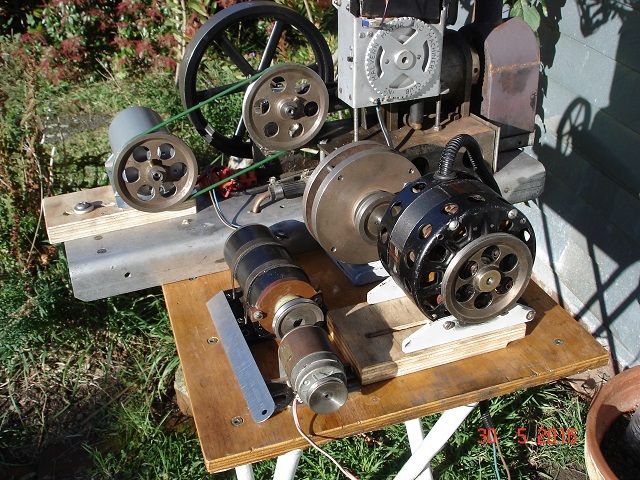

                  I would suggest a little gen set, there,s your next project, building a generator or alternator to match up. A good start just to see what it will do is to get an old treadmill motor(chuck out from gym/fitness centre), you can expect to get 50-60% of the crankshaft power out of such an alternator. You want a brushless motor for this, easy enough to rectify the out put if you want DC, or change voltage with a transformer.
                  here's a bit of a collection of alternators and generators for my hot air engines.

                    016 (640x480).jpgFurther to the above, an alternator can be made using the frame and stator of any induction motor, a 4 pole motor would be a good starting place. Remove the armature, and make a new one similar to the one in a car type alternator, but instead of a wound coil use permanent magnets (ex microwave oven, or large speaker), the alternator in the photo is a 6 pole shaded pole motor.

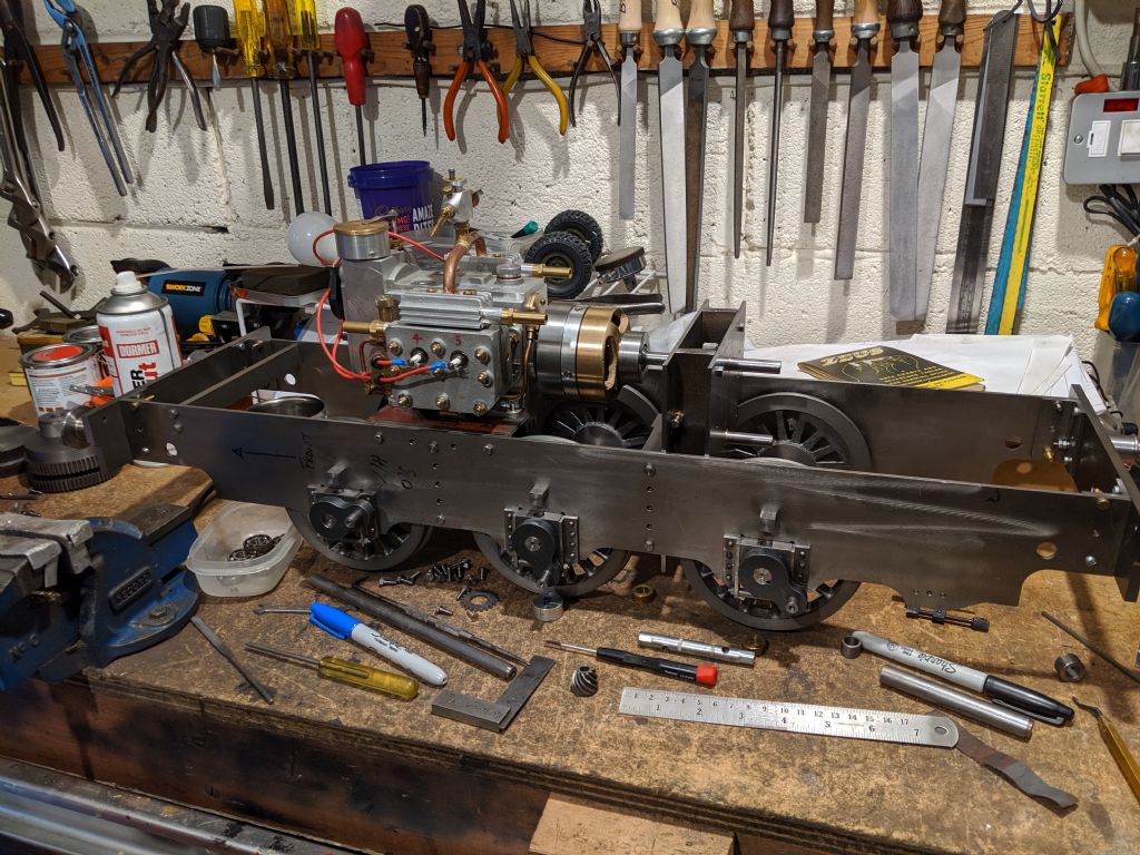

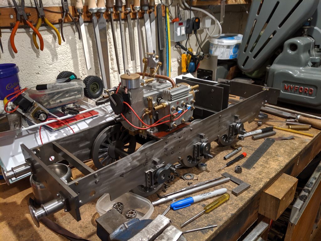

                        First of all my apologies that I have not been active on here, health and family reasons. Back to modelling again and I eventually decided on a 5" guage loco based on a Blackgates Charlatan chassis.You never know it may have enough guts to pull me around. Upload some pics soon.

                          duncan webster 1
                            @duncanwebster1
                            what are you going to use for a transmission. Electric?
                            #435202
                            Brian Selby
                              @brianselby80227
                              The bronze part at the end of the engine is the Westbury centrifugal clutch this drive into the rectangular box, which houses the reduction gearbox and a tumbler reverse. The gears I cut myself to fit the available space and drive the rear axle through an angle grinder bevel drive, thanks go to Neil Wyatt for suggesting those in his Southam loco.
