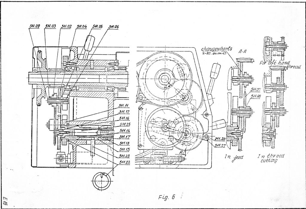

                                    I have a copy of manual on a cd but it’s not very clear especially the page on fitting the changes gears etc any help on what gear is what would be appreciated
                                    kevin
                                    #185748
                                    Nicholas Farr
                                      @nicholasfarr14254
                                      Hi Kevin, this scan may be a bit clearer **LINK**
                                      Regards Nick.
                                      #185751
                                      kevin large
                                        @kevinlarge76611
                                        Many thanks nick just have make sure I get the right z no.
                                        kevin
                                        #185766
                                        Nicholas Farr
                                          @nicholasfarr14254
                                          Hi Kevin, it's not so hard as it looks. z1 is permanently attached to the mandrel, as you may be aware, z6 always goes on the lead screw. z2 & z3 are coupled together, but sometimes they are just a single gear and the same goes for z4 & z5. The two dots : shown between each pair on the little diagram are the ones that mesh together. So on a 0.8 mm thread, in the columns z2 & z3 shows a 40 tooth gear, this becomes a combined gear and one side will mesh with z1 and the other side will mesh with z3.
                                          Hope this helps a little bit more.
                                          Regards Nick.
                                          Edited By Nicholas Farr on 07/04/2015 14:40:41
                                          #185776
                                          kevin large
                                            @kevinlarge76611
                                            Thanks nick I’ve noticed that all the change gears have bits on the back like engagement dogs but 1 just has shoulder what’s this odd 1 for
                                            kevin
                                            #185778
                                            Nicholas Farr
                                              @nicholasfarr14254
                                              Hi Kevin, if it is marked as z32, it is most likely the one that is put into the gear train between the z1 on the mandrel and z2 on the rest of the train so that left hand threads can be cut. shown in the top right of this **LINK**
                                              Regards Nick.

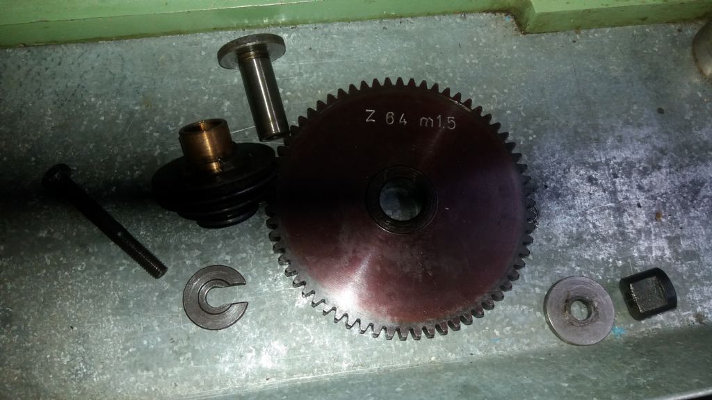

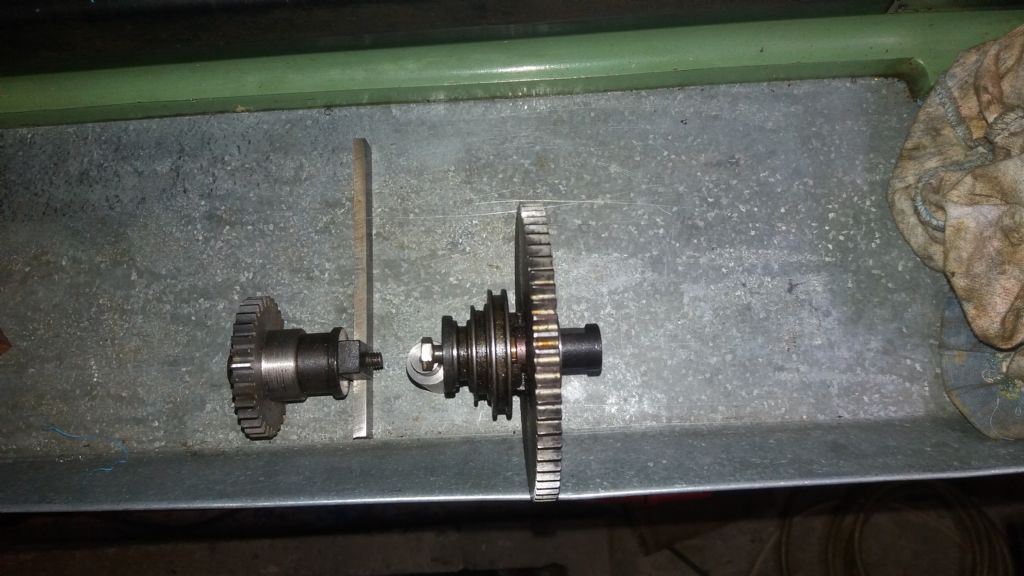

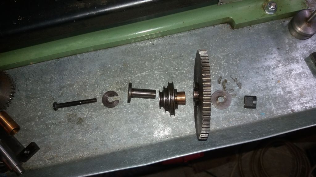

                                                  Well I am between 5 and 9 years late to this post.
                                                  I have just picked up a Warco 220 for pretty much silly money. It has come from a school and appears to have had very little use, which is always nice
                                                  The downside is that it did not come with any tooling, or screwcutting gears. I knew this when I bought it.
                                                  The second downside is that (probably for reasons of safety) the school un-installed the lead-screw drive mechanism. It is missing the gear which meshes with the spindle splines, the one with the 3 small pulleys for the 'friction disc' to engage in.
                                                  Does anyone still have one of these lathes, and if so, would it be possible to have the dimensions and tooth count of this gear so I can make up a new one?.
                                                  Many thanks
                                                  James
                                                  #435077
                                                  Tim Hyndman
                                                    @timhyndman57976
                                                    Hi James,
                                                    I think you are after a 64 tooth gear. I am installing a 220 vs and trying to work out the screw cutting gears. I found your post and took some pictures. I could draw up this gear if you still need the info?
