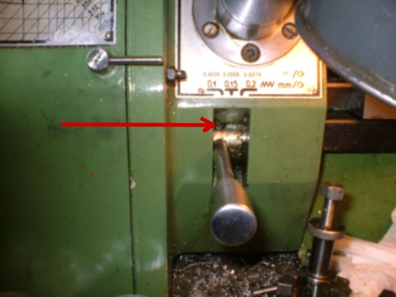

                                  Hi Ivy,
                                  Iam sorry to hear about your problems with your Warco 220. I have run one for about 15 years and hardly recognize the descripion of the lathe. I do not have to hold the saddle feed lever down in any speed and have recently used an 1/8″ indexable parting tool in my front tool post to machine 7″ diam aluminium pulleys.
                                  To address the problems you are having might here are a few suggestions.
                                  Saddle feed.
                                  Open lathe cover and check that the large friction wheel is engaging centrally in the groove of the small friction wheel in all three speeds. I believe I had to add a thin washer behind one of the wheels to achieve this in my case. Do not shim away all the all the end float on the friction wheels as there should be plenty of end float to allow them to engage properly.
                                  Dismantle the automatic saddle feed mechanism to allow the feed lever to be depressed much further than normal. After you have depressed the lever you will see a screw by the base of the the feed lever, this screw bears on a pad and provides friction to prevent the feedlever dropping out of engagment. Tighten the screw, you will now find the feed lever much stiffer in opperation and not prone to drop out of engagment.
                                  Screw cutting.
                                  During screwcutting the automatic feed is dismantled and the appropiate gear train made up.
                                  The meshing of the gears is set by feeding a strip of computer paper between the gears and adjusting for no backlash, remove the paper and lock the feed lever using the allen screw located under the gear cover ( I don’t bother and nothing has come loose yet).
                                  Parting off.
                                  Check the adjustment of the lathe slides and adjust as necessary.
                                  Check the spindle for smooth operation and end float, if the spindle operation is not smooth strip the headstock IAW the manual and replace the spindle bearings gease the bearings with LM grease (car wheel bearing grease).
                                  If the end float is out of spec adjust IAW manual.
                                  PS The headstock bearings will run warm to the touch after prolonged use at maximum speed.
                                  Hope this is some help,
                                  Regards, Roger

                                        I’m interested in your description of the feed adjustment.
                                        I have had my mechanism in bits and don’t remember finding any adjustment screw or pad at all. Which makes me wonder if your lathe is perhaps newer than mine. Mine is Factory No. 357 bought new in August 1994.
                                        When you say “Feed Lever”, I assume you are referring to the lever which projects out from the lower part of the headstock casting below the Rev/Off/Fwd switch lever and which moves up and down with a rotary movement, and which also moves sideways to select the three speeds.
                                        Regards,
                                        Peter G. Shaw
                                        #84294
                                        Roger Mountain
                                          @rogermountain33705
                                          Hi Peter,
                                          It sounds like there may have been some production changes between our machines. The screw is not visible when the feed lever is in it’s normal position, I will try and photograph it for you if I get time today. I have never inserted a photo into a posting do you know what size of image the site can cope with?
                                          Regards, Roger

                                                  Hi Peter,
                                                  I have photographed the screw in question you can just see it starting to emerge with 0.1mm/rev feed engaged. Sorry I can’t get a better picture but I would have to remove one of the friction wheels in order to get the feed lever to drop down further. Incidentaly with the feed lever pushed down in this position the the auto feed is fully engaged and shows no tendency to jump out.
                                                  Hope this is some use to you.
                                                  Regards, Roger
                                                  PS It looks like there are quite a few differences between these machines.

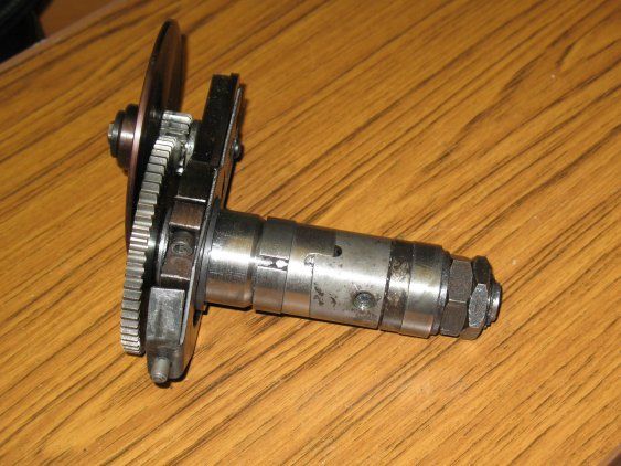

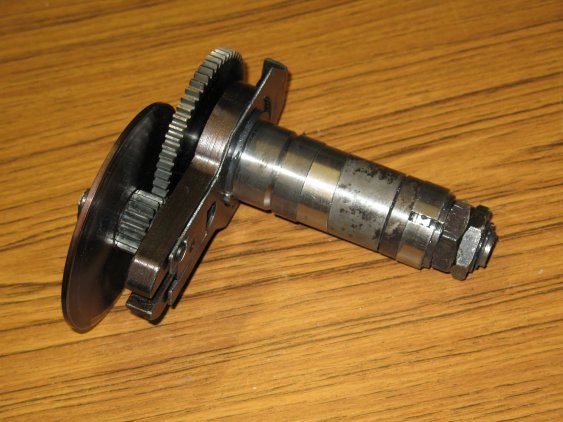

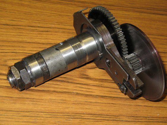

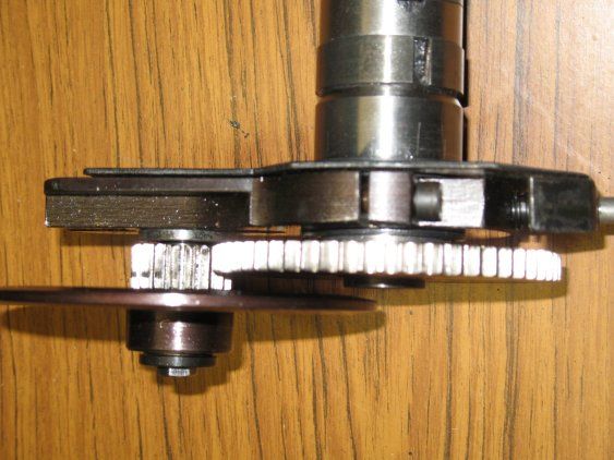

                                                    Peter G. Shaw
                                                      @peterg-shaw75338
                                                      Ivy, I’m not surprised you are confused! I’m somewhat struggling and I’ve had mine in bits, and I do mean in bits. Read on…
                                                      Ok, two photos of the mechanism removed from the lathe. I’ll describe later how to get it out, but note if you will, the screw hole where the handle or lever fits.
                                                      Now, how does this work? Ok, the manual uses all sorts of convoluted phrasing, so here is my version:
                                                      First of all, the gear wheel (64T, 61T can’t remember) on the left is bolted to a shaft which runs through the centre of what you can see here. The leadscrew fits into the shaft at the righthand end with a key. As the mechanism is moved left to right, then the internal shaft slides on the key. The internal shaft fairly obviously rotates inside the mechanism. That’s all there is to say about the shaft.
                                                      Right, the mechanism proper. If you look carefully, and I don’t know how much the picture can be expanded before it becomes unreadable, but you will notice that towards the left hand side can be seen part of a cone. Adjacent to it and to the right is the matching internal split cone. Actually, there are other photos below which possibly shows it more clearly.
                                                      Next to the internal cone is a greyish looking piece in which the handle is screwed. This part can rotate – you can see ball bearings to it’s right. Also to it’s right are another pair of cones. Now the grey part also is cut at an angle – might just be visible above. Rotation of the grey part, forces the two pairs of cones together whereupon the two split parts are forced to expand and in turn grip the inside of the headstock housing.
                                                       To continue, having just saved it!
                                                      The two large nuts are used to adjust the mechanism slackness, if that makes sense. What you do is tighten up the thicker nut, and then lock it with the thinner nut. And don’t let’s get bogged down in the argument of which way round the nuts should be – this is how Mashstroy have set it up.
                                                      These two photos are simply different views. The last one is with the mechanism upside down to allow a photo of the underneath – not that there is anything of note!
                                                      Just done another save.
                                                      This photo is just the external part of it, but it does show the fixed external cone and the split cone – with a short key.
