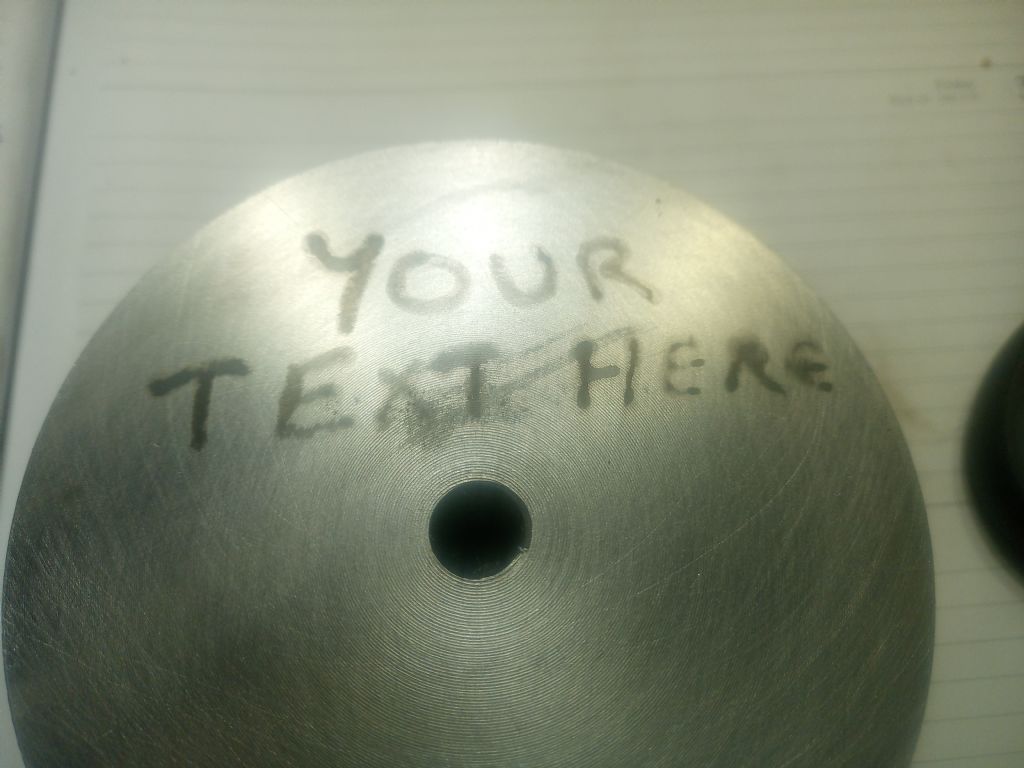

I have a need to be able to mark steel. Paint markers are okay but on my Coventry die heads this soon wears off. I don't want to etch or engrave and whilst I could fix some kind of tag this seems like bother.
The idea came to me that if I put some Blackfast solution into an empty marker pen, I could end up with a pen that would produce black writing that would not easily rub off.
It works… Sort of!
There are some issues.
Firstly it is too thin!
Secondly it doesn't stick very well.
The only thing I had to hand to try and thicken it with was some clay. This produced the result in the photo. I wiped the surface with IPA (not the bitter!) Then wrote on the steel. I waited about a minute and wiped it clean.
The writing can be taken off with scotchbrite but would appear to be pretty resistant otherwise.
Does anyone have any ideas on how to improve this?
