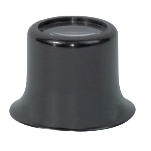

                                            My two penn’orth goes like this …
                                            Up north t’other side of Manchester we called the greasy blue stuff ‘bedding blue’. (Nothing to do with nuptial discord.)
                                            On page 2 of this thread (about five years back) I related a story that went like this …
                                            When an apprentice was learning to read a Vernier [scale], bedding blue was often [discreetly] smeared inside a doll’s eye magnifier for the unsuspecting learner.
                                            Getting them to change eyes for a better look brought on more laughter. If you haven't seen a doll's eye magnifier (jeweller's loupe), they look like this. dolls eye magnifier.jpg
                                            ‘Marking out blue’ is commonly used as a very quick reference by Chris of **LINK** especially when he is setting shoulder lengths on the lathe. However, as can often be seen, marking out blue will flake and rub off quite readily.
                                            For extremely fine, close up work, toolmakers in my apprenticeship era would apply copper sulphate to steel. It allowed a much sharper scribed line and, although less clear than marking out blue, the copper coating didn’t rub off easily.
                                            Sam
