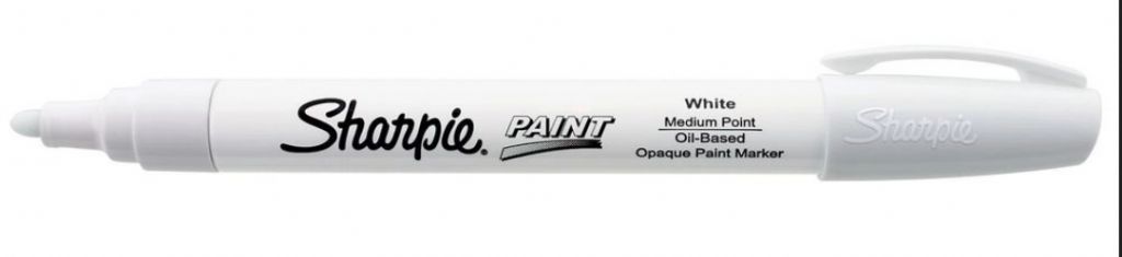

      looking to buy some sort of white marking fine point pen for sheet metal, and looking on the net its a mine field looking at the Sarpie extra fine point it has bad write ups. Can anyone recomend some thing for under £10 I have scribers and every thing but I cant see the lines very well. Thank You

            The traditional method is to "blue" the surface so that the scribe lines are more visible. I use a wide, felt tipped felt pen (Texta) instead of blueing ink.
            Many of the fine tip marking pens will not write on metal. Sharpie (and others) sell paint pens, containing oil based paint which will write on almost any material but not available in fine point.

              My local engineering supply shop sells paint pens with a very fine tip that can draw lines 1mm wide or less. But they do tend to clog up if left unused for too long. The tip is like a small metal tube that keeps the line thin.
              For other marking out, I often use whatever paint is left in the bottom of spray cans. Red or blue work well as layout "blue" then scribe the lines in it with a scriber. Very durable too. But can be cleaned off with paint thinner or brake cleaner etc afterwards.
