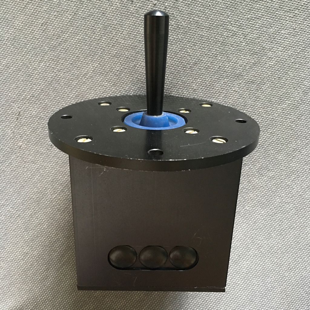

                For info.
                For Scale: The top plate is 4.25" diameter, and the box is a 3" square extrusion.
                The stick has large angular travel, so [for Pete] it's unlikely to be strain-gauge based.
                No idea what the rubber bungs are for; there's a matching set on the opposite face.

                    Posted by Alan Vos on 24/08/2018 21:37:17:
                    To get back to the original question, which pins are wired? That may offer somebody a clue.
                    All nine pins, plus a separate connection to an earth tag
                    … all in pink wire, with tiny Hellermann sleeves over the solder joints.
                    A proper job, but a tricky guessing game !
                    Edited By Michael Gilligan on 24/08/2018 22:00:32

                          The fact that all 9 pins are wired does not really help identify the method it uses to communicate, other than to say that the most, maybe all, of RS232 equipment I have seen never had 'all' pins connected. Its unlikely that a joystick would need all RS232 lines anyway.
                          Whether this product was industrial or just commercial, it was made to aerospace type of standards and as such was surely designed to be serviceable or MOD-ifiable. I would suggest that it should be possible to access its innards without doing and damage and it would be the best way of finding out how it works.

                              Posted by Michael Gilligan on 24/08/2018 12:32:16:
                              For info.
                              Far too robust and agricultural for an avionics system. Civilian, ground or naval radar maybe? An interesting read here. **LINK**

                                is it a servo controller fed by 2 signals in phase quadrature feeding two coils, the joystick moving 2 pickup coils arranged in quadrature – many aeroindicators used similar servo mechanisms
                                #368932
                                  Posted by Doubletop on 24/08/2018 23:01:21:
                                  Far too robust and agricultural for an avionics system. Civilian or Naval radar maybe an interesting read here. **LINK**
                                  Thanks for your continuing interest, Pete … but that ^^^ is where we came in.

                                          Its a log time ago, but I worked at Marconi Specalsed Components in Billericay, sat next to the guy that made these.
                                          If I remember, they had two 'pots; / variable resistors in them, one for X one for Y, I thought they also had a button on top,
                                          They were designed at the time that nuclear bombs were though survivable, Very rugged, designed to be used by Milterary personel "under conditions stress", when excess force might be applied. …
                                          A quick go with a ohm meter should get you which pins are which.
                                          #389672
                                            Thanks for the note, Andrew … and welcome aboard the forum.
                                            My understanding is [was] that mine is a 'contactless' version that uses something more exotic than simple pots, but I may be wrong … I have so far resisted the temptation to open it up.
