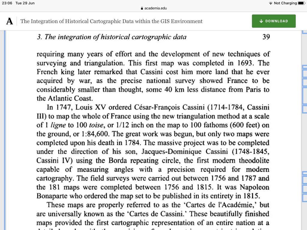

              Shortly after posting … I found this: **LINK**
              https://www.davidrumsey.com/blog/2009/10/11/national-survey-of-france-1750-1815
              [quote]
              The Carte de France was one of the first national surveys completed on the same scale, 100 toises (a toise was equal to 6ft and the equivalent scale today would be 1:86,400), according to a specific plan.
              [/quote]
              which in turn, led me here:
              So now I know smiley … nearly
              84,600 or 86,400 ?

                Thanks, both … you got there before me blush
