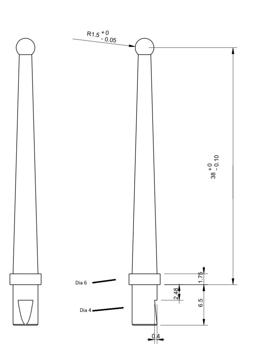

      Can anyone recommend a company that could help me get some small components made that I cannot make myself, preferably in the East Midlands.
      Every where I’ve contacted have said the parts are too small for them / there lathes. Im sure there must be a company who can help me.
      If anyone here can manufacture this I would be happy to pay them. I need 4 off.

            I`m not sure the size of the part is the issue, maybe the tolerance…
            I have a small CNC lathe that could make a part similar to that but I would not be confident I could hit the numbers without fettling after or be able to measure to the ball centre that accurately to confirm. Also the ‘sharp’ edge at the base of the ball would require special tooling so allowance for a rad (0.2mm) would be required.
            I use machine shops that could make them but I suspect the cost will be prohibitive, PM if you think I can help.

                is it me or are there two or three dims missing?

                    The only critical dim is the 38mm to ball centre, a blend rad at the base of the ball is not a problem.
                    I will pm you as I have to get them manufactured somewhere.

                      There are some dims missing.  I just wanted to give an impression of what was needed.
                      I have a 3d model (stp) and a Dwg of the completed part.

                              silver steel is ok for it dimensional accuracy but a bit of a pig at these dimensions

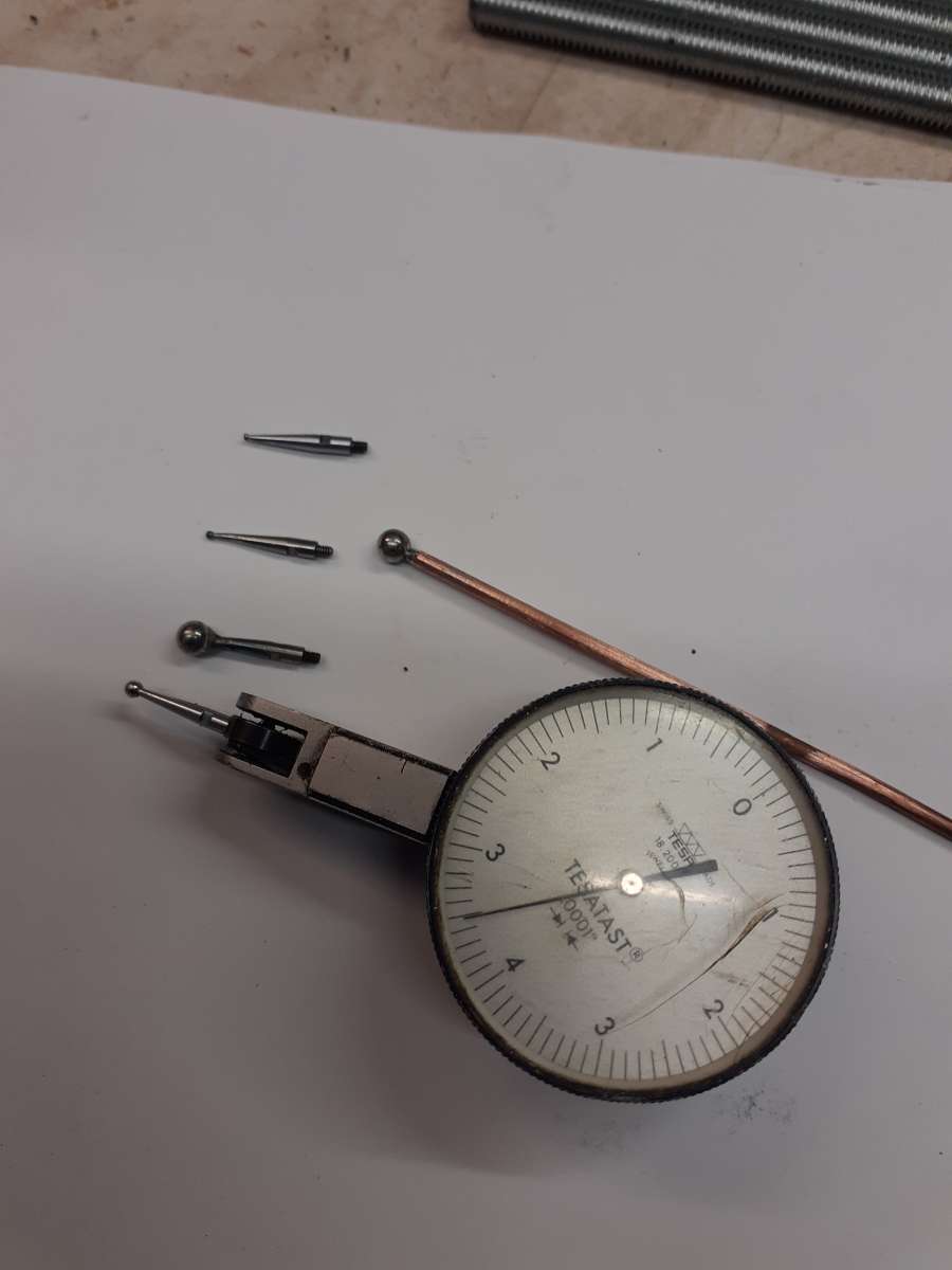

                                Hi I  used to make similar parts as these when at work. I made the stem from steel with a dimple on the end and then soft soldered a ball bearing on. The stem was warmed with a jewlers fine torch up and with some bakers fluid and solder was applied to the dimpled end to give a small amount of solder. Pick up the ball bearing with tweezers and warm up and dip in soldering fluid then heat the stem again, place ball on top and it will sit there. Warm up again and press down on the ball and alow to cool. It just needs a slight clean up with a needle file and wash off any flux restdue. These were to replace lever dial indicators some with 1.5mm diameter balls  up to 6mm diameter which would wear measuring ceramic cores etc. The ball hardness was not effected by soldering and fairly easy to replace once made.
                                David

                                  Jason, i’d also thought about cmm stylus but it need to look something like the drawing, Ive looked for stylii with steel balls instead of the synthetic ruby but without much success.

                                      The component is a stylus for a guage but i think the design is a bit over complicated around the sphere. Essentially there needs to be a contact point 38mm from the face and 1.5mm from centre. it really doesnt need to be a sphere, i would think an elipse would be easier to machine if the only critical dim was the r1.5.
                                      If it were made so the 38mm was around top limit the datum face could be machined to change the dimension. I could measure this on a shadowgraph.
                                      Maybe if i adust the drawing to reflect this it may be easier find someone to make them for me.

                                            Agreed.  For a request like this the drawing should be complete because the devil is in the details!  It’s important not to set close tolerances unless they really are important, because meeting them is seriously difficult, requiring extra time and measuring equipment.
                                            The originals were certainly made using interchangeable part manufacturing methods, typically where a tool-room with high-skilled workers and advanced equipment spent a lot of time and money producing a bunch of high accuracy jigs, fixtures and gauges that were then deployed on the factory floor and used with ordinary machine tools and unskilled labour to bang out gazillions of near identical parts, more the better.
                                            This contrasts with home-workshop methods, where a skilled machinist struggles to produce anything like identical parts. I generally work up to ±0.02mm, but I couldn’t do Paul’s ball end at anything like that accuracy.   (Might be possible to cheat by substituting a ball-bearing.)
                                            Both approaches tend to be expensive for making small numbers!  A CNC maker service is a good option, but don’t expect cheap.  Setting up a CNC machine is dirt cheap compared with jigs and fixtures, but still pricey for anyone who thinks £20 is big money!   The economics matter: if 100 parts cost £100 pounds, they are a pound each (if you can sell them!), but 4 parts would be £25 each, oh dear.
                                            A CNC service will need a proper 3D-CAD plan, the lot I linked to above say: We accept 3D CAD files in STEP, IGS or Parasolid format for CNC machining. We cannot use STL CAD files. If you don’t have a 3D CAD file yet, we recommend designing in OnShape as it is free and sometimes easy to use. The other option is to find a freelance design engineer to help produce the CAD file for you. We can recommend someone if you require help. The wording suggests they are happy to deal with beginners, which can’t be said of all companies!   I suspect their jaundiced view is caused by getting enquiries from chaps who need a lot of support and, expecting much, much cheaper, are off like whippets when they get the quote!
                                            If a ball-bearing were allowed, the main show-stopper I see apart from time is the object’s small size.   I’m in the ‘buy the biggest machine you can‘ camp, which makes holding something that small in my lathe and milling machine tricky.  Not impossible,  but much easier on the sort of gear used by clock-makers.  Chances are I’d have a high error rate too, making it difficult to quote a price.  It’s the sort of job I only do for myself, and for close relatives only!
                                            Turning a decent 2D-drawing into 3D-CAD suitable for CNC wouldn’t be difficult if that helps.   I’d do it in SolidEdge, but the forum has plenty of Onscape aficionados too.

                                                    << There are other manufacturers of course, such as Mitutoyo, though they seem to jump from 1 to 2mm >>
                                                    He wants 3mm diameter.
                                                    £8.00 headline price (plus VAT plus delivery plus minimum order plus ULEZ plus TV license fee etc.) here:
                                                    https://www.allendale-metrology.co.uk/mitutoyo-20-9mm-metric-dti-3mm-diameter-ballpoint-carbide-long-stylus-103014
                                                    It would be easy enough to make a parallel 4mm diameter notched extension for this with a female thread the other end. Make a 6mm OD 4mm ID ring and superglue it on using a jig (gauge blocks set to 39.5mm from the extreme end) to set the 38mm length. The notch could be filed also using a jig.
                                                    There are other 3mm diameter Mitutoyo stylii available, some longer than required so shortening one of them might also be an option. The challenge is finding part numbers and dimensions. This might be a good starting place:
                                                    https://mqs.co.uk/mitutoyo-21cza045-3mm-contact-point-for-513-401e-indicator.html
                                                    N.B. check above link because it says 3mm diameter, but also says 1mm diameter.
