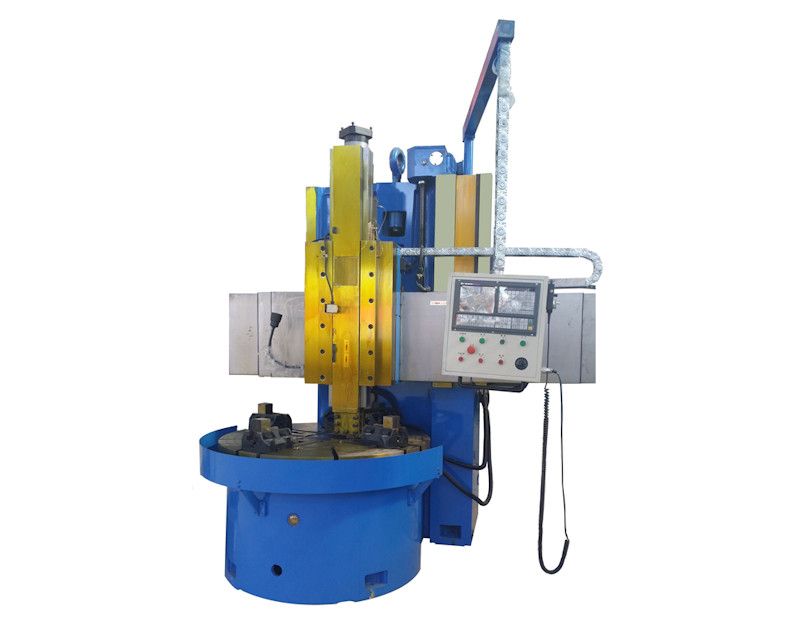

          Vertical borer? Would be more compact, but may not be a fast enough cycle time.

            Thanks, ill have a look in to a vertical borer, I think that is how they are being machined at the moment. I have asked admin to delete this thread as the title is wrong. not sure how my name got in there.

              This is called a vertical lathe may be the same as a borer, could be the tool for the job?

                Vertical borer looks interesting especially if we could fit a drilling spindle to the tool post as there are some holes to drill on a PCD

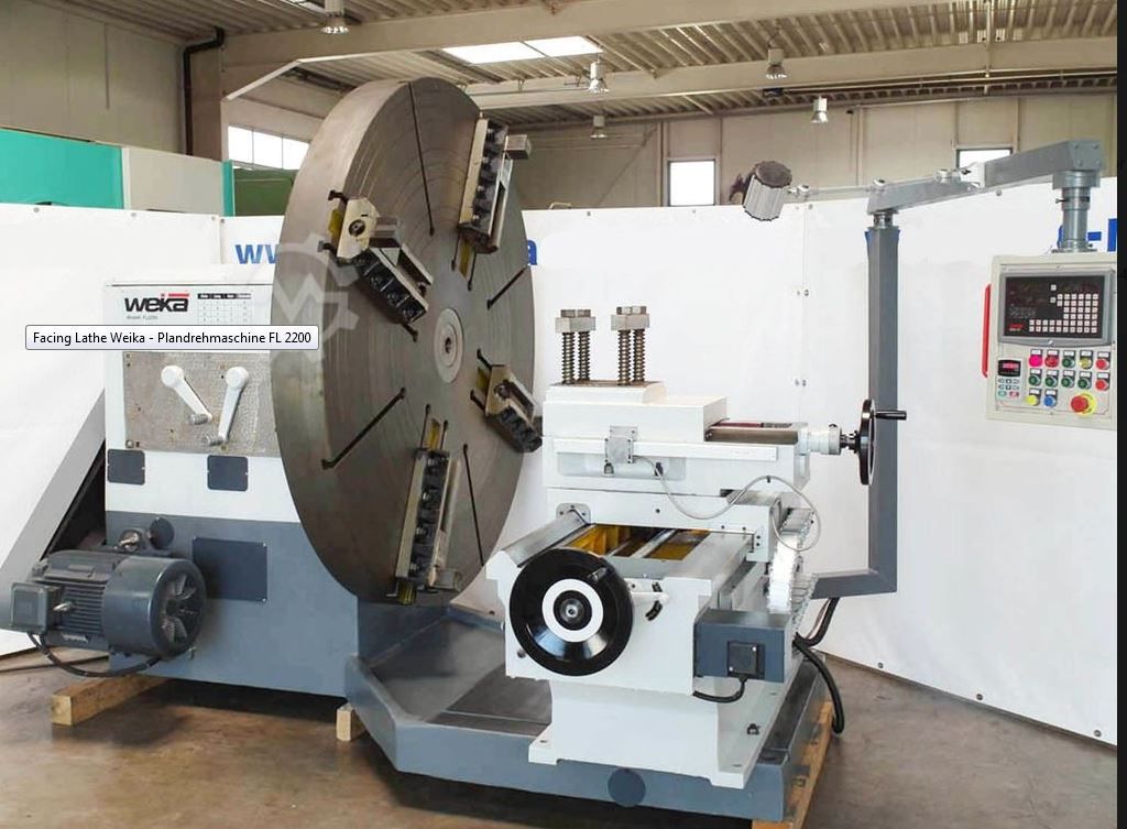

                    sound like you need a facing lathe of some kind such as:
                    or has been previously mentioned on the other thread:
                    http://www.ebay.co.uk/itm/Binns-and-Berry-short-bed-facing-lathe-9-750-VAT-/263232210839?hash=item3d49dcc797:g:KFwAAOSwep1Zy2~i
                    Edited By mark smith 20 on 21/10/2017 12:40:42

                      A Binns and Berry machine would certainly do the job, not sure we have the floor space for a machine that long though.

                        Vertical lathe was what was used at RARDE / DERA / DRA for such jobs. As I recall matters the guy who drove it didn't consider it unreasonably slow but never saw it in use myself.
                        Setting up on a facing lathe will be a PIA. Not a one man job. Probably crane involved too. Much easier to slide around on the horizontal faceplate of a vertical lathe.
