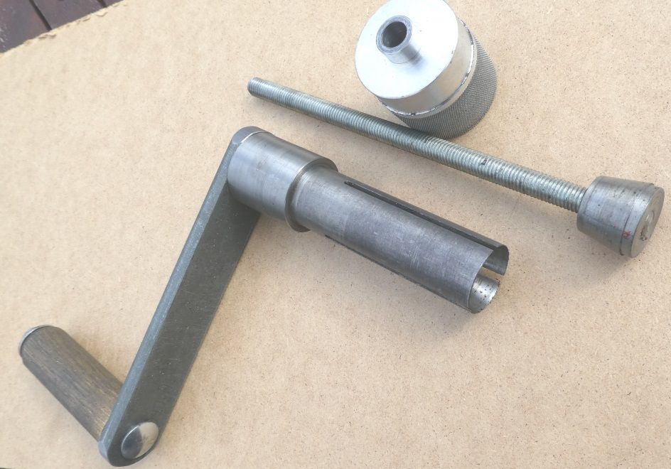

                Jon Gibbs
                  @jongibbs59756
                  Hi Jonathon,
                  My mandrel handle is based on the design in Ian Bradley's book on the 7 Series Myfords…
                  and here's a picture. It's just made out of BMS and after 2 years of regular use it's still going strong.
                  Mine uses M6 studding loctited into the outer knurled nut and four slots (easier to drill the relief holes). The inner nut with tommy bar hole is used to tighten up the tapered plug into the socket. Note: that the male taper is only threaded and is free to move – it doesn't rotate in use as might be expected.
                  After it's been tightened it does take a light tap on the slackened off outer knurled nut to free up the taper.
                  HTH
                  Jon

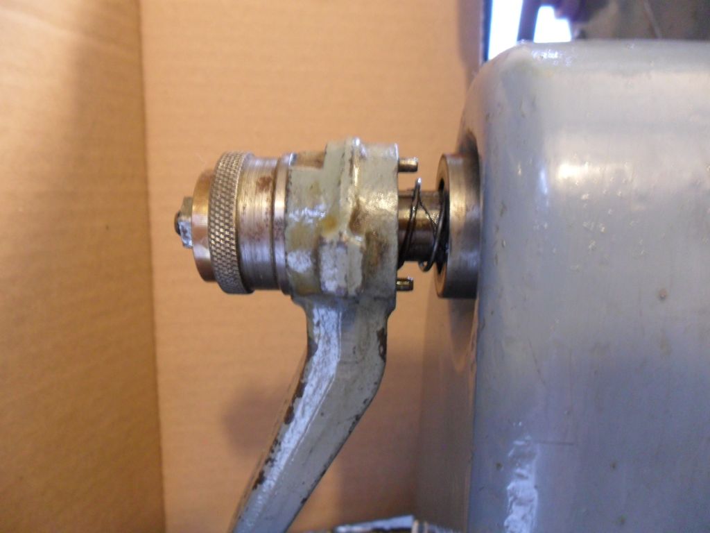

                                        Nobby
                                          @nobby
                                          Hi Guys
                                          My mandrel handle is sprung loaded like a milling machine handle if youMandrel handle let go it pops out . for safety . as its heavy it stays in place when my Myford S7 is running
                                          Nobby
                                          Edited By Nobby on 10/08/2016 14:40:32

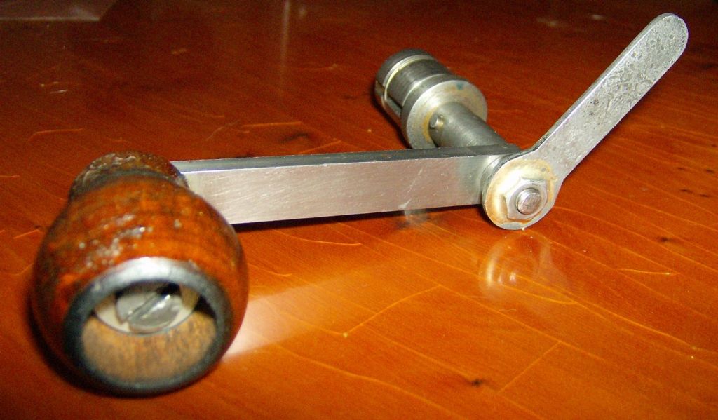

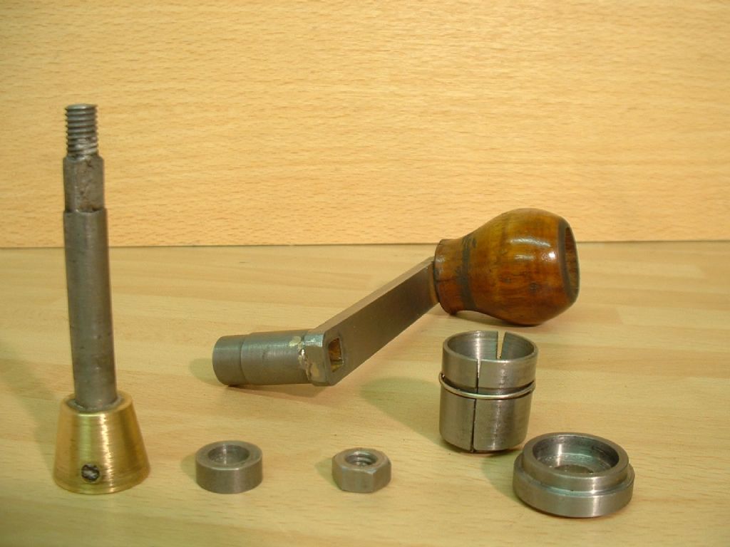

                                          #250174
                                            My version uses a fully spilt collet about 1" long, the two collet halves are kept in place with a circular spring from a keyring.
                                            handle 1
                                            handle 2
