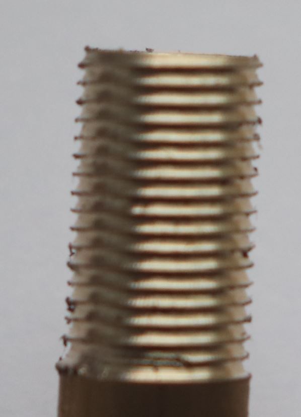

      I'm a beginner at this, and need some help. I have just tried turning a 0.75mm pitch thread on a piece of brass bar. I gound the tool myself, using an angle of 60 degrees. I used a slow speed (backgear using pulley 2). At the end of the threaded section I just turned off the lathe, since I don't know a better way of doing this. Of course this is not precise, and I may have stopped the lathe a fraction too early or too late at the end of some cuts. After each cut I just started the lathe in reverse until the tool was back at the beginning of the cut. I could not disengage the half nuts because I was cutting a metric pitch on an imperial lathe. I did not back out the tool for the reverse pass because I thought this would make it difficult to advance the tool by a few thou from its previous position for the next pass. The problem is that the thread has come out very lopsided, with a much sharper angle on one side than the other, which I hope you can see from the picture.
      Why has it done this? How do I correct my technique to get a properly shaped thread?

          The problem with not backing to tool out is that any slack in the half nuts or the axial location of the leadscrew will cause the tool to be a bit to one side of where it was in the 'forward' direction. That will make the flanks of the threads narrower than they should be.

            You must retract the tool before running the lathe in reverse as the tool will not follow an exact path due to backlash in the change wheels and lead screw.

              Did you angle the topslide to put on a cut? if so you mat have got the angle wrong, it needs to be 29.5deg from a line at right angles to the lathe axis not 29.5 deg from the lathe axis.
              Should look like this

                Not backing the tool out of the thread before reversing has created a positional error between the thread cut going forwards and that going backwards. Basically due to the backlash in the half nut and drive which has to be taken up before the tool moves when the machine is reversed.
                If you are worried about advancing the tool a few thou for each cut after moving it clear of the work to reverse I suggest you adopt the technique I was taught as "zero-to-zero" or "zero-2-zero" as the lathe keeps track of everything for you automatically.
                Basic idea is to use the top slide to apply the cut and the cross slide to withdraw the tool before reversing and bring it back to a base position ready for the next cut. With some refinements so it keeps track of total depth of cut and sorts out the angle of attack of the tool.
                Start by setting the topslide at a little less than the half angle of the thread. Anything close will do. I use 25° for both UK (whitworth) 55° and metric / American 60° threads. Mount the tool with its tip at exactly right angles to the work. As usual a lovely picture from Jason showing the fundamental set-up but I'm too lazy to bother getting the angle dead nuts and figuring out exactly what the in-feed should be. So I make the lathe do the maths!

                  Although I agree about the need to back the tool out, backlash would not affect the angles of the thread it would just have a wide valley yet OP says
                  "the thread has come out very lopsided, with a much sharper angle on one side than the other"
                  A picture of the tool and one of the overall setup would help

                    That likely means there is slack in the carriage, from back to front and front to back causing the saddle to ‘slew’ on the return. It is important that tye lathe on;y cuts in one direction.
                    #612249
                      That's going to need a lot of slew to produce what's shown, it's almost a buttress thread so about 25 degrees of slew

                        In a situation like this where we have wonky results from an admittedly imperfect technique its not very profitable to try and figure out exactly what went wrong.
                        Far better to combine a proper set up based on Jasons first photo with the known to be near as possible bullet proof zero-2-zero screw cutting technique and build from there.
                        I've known that approach work for several folk who initially had problems with screw cutting. Never did figure out exactly what they were doing wrong initially. I suspect they didn't actually do what they thought they had done so their initial descriptions of the technique were incorrect.
                        Jasons last picture shows no run out groove to "contain" the tool as the lathe comes to a stop. I wonder if one of the last few passes drove the tool hard up against the full diameter step at the end of the thread causing it to swivel and alter the effective flank angles being cut. With only a few passes left the inadvertently revised flank angles may still have left an adequately clean cut in a nice free cutting brass. The butressy like shape pointed out by Jason certainly looks as if the trailing flank of the thread has acquired a steeper angle which could have been caused by the tool swivelling back a bit on hard contacting with the step.

                          Firstly as others have said, backlash in feed so retract tool before reversing – number one rule!
                          Second how did you set your 60 degree tool in the tool post so it was accurately aligned to the job? Fish tail gauge or guess work? Any screwcutting tool needs to be properly set at 90 degrees (axis of the centre of tool) to the job. Looks like you had your 60 degrees biased 40/20?

                            You need some clearance when you grind the tool. The thread is cut at a small angle (helix angle).
