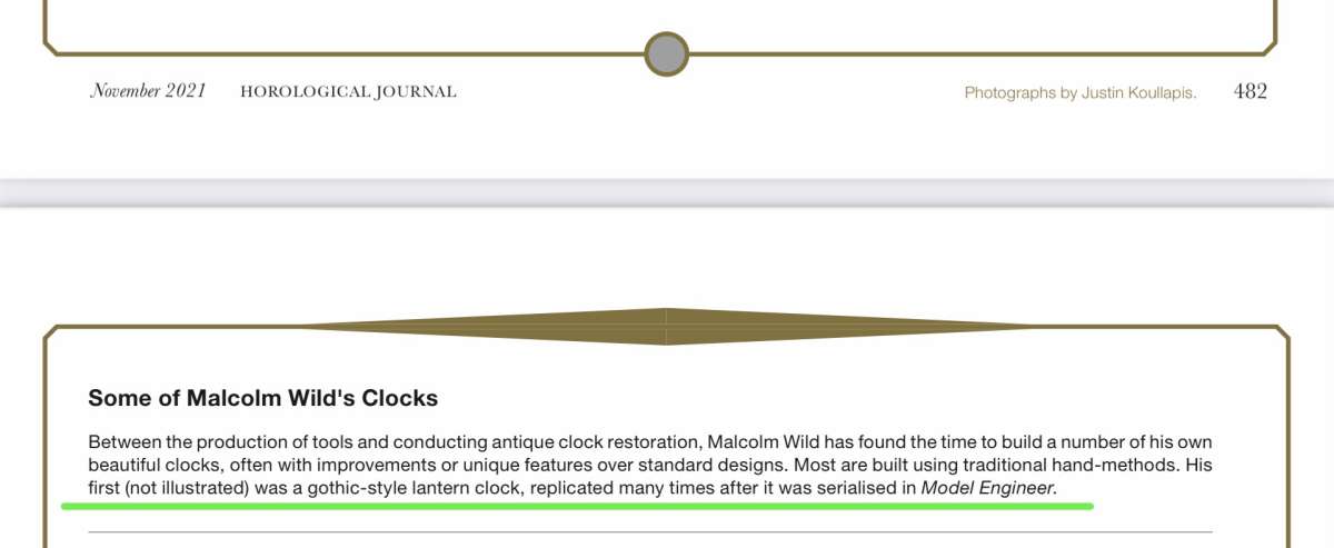

      Anyone know rough overall size?
      #716038
        This doesn’t really help … except to tell you not to bother looking in HJ

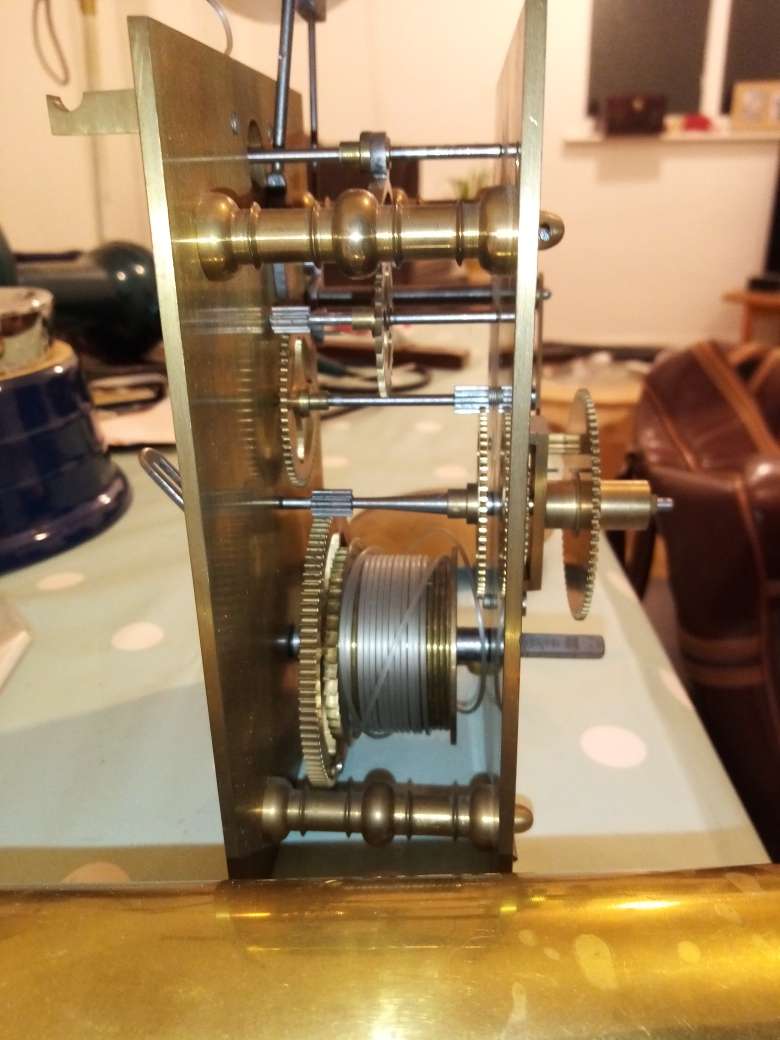

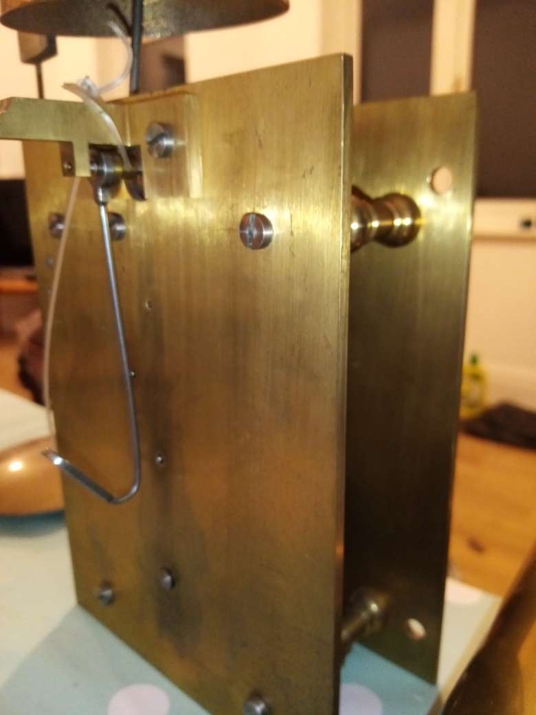

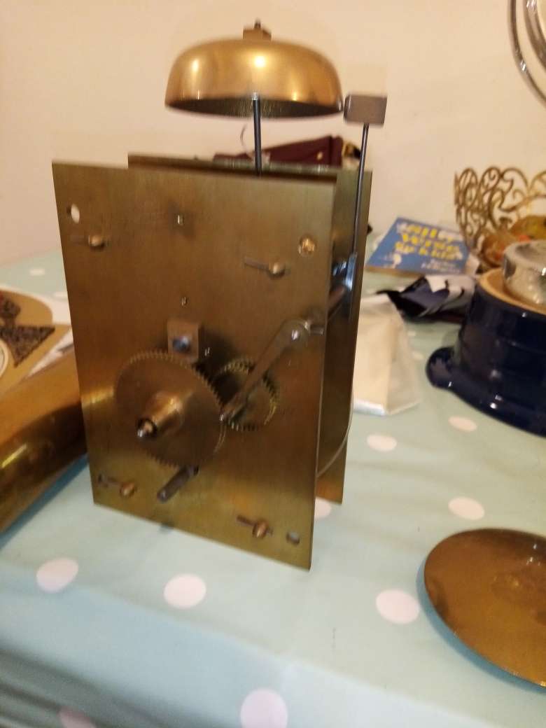

                  As explained in the other thread I was offered a part built one from a deceased clock maker, he died some time ago, but his widow has only just found some more boxes of stuff as she prepares to move house. In with it is what I think is a grandfather clock movement, but I’m very new to this mechanical clock business. Anyone recognise it? It looks completely new. The weigh is very heavyIMG_20240225_183150_resized_20240225_064421171IMG_20240225_183210_resized_20240225_064420664IMG_20240225_183217_resized_20240225_064421628
                  #716307
                  roy entwistle
                    @royentwistle24699
                    Could be Wilding’s wall clock as it’s only passing strike
                    Roy
                    #716316
                    duncan webster 1
                      @duncanwebster1
                      It’s similar, but I found a posting from Nov 21 which shows Wilding clock. It has a lantern pinion driven off the wheel on the barrel, and the wheel on that shaft is next to the pinion. In mine I have a “proper” pinion, and the wheel is at the other end of the shaft. Thanks anyway
