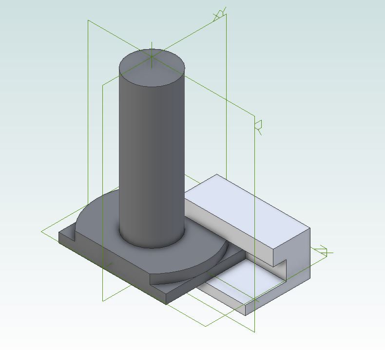

        As Michael points out unless you are using undersize coach bolts then the head dia is too big to fit into the "head" of the Tee.
        Taking a typical 12mm slot and M10 stud the coach bolt has 80% the area of my Chronos Tee nuts and 87% of my ARC tee nuts which are a little shorter. So the slight loss is not really worth worrying about for our uses.
        This shows the rounded head of a M10 coach screw with the footprint of the Chronos nut below, as you can see small loss of contact in the corners once the bolt head has been narrowed

                      As Jason points out above, very little difference in size between a modified coach bolt and a T-nut. Most coach bolts I have come across also have a short square section immediately under the head. I try to get bolts such that this square section fits in the 'neck' of the T-slot – simple enough to file it down if its slightly too big – this then helps takes the pressure off the head when tightening. This generally means that shank of the bolt is the same size or even bigger than any nut/stud which would fit in the T-slot. And the head of the coach-bolt is correspondingly large, so when the sides of the head are filed to fit in the T-slot, there is plenty of meat on left on the head, as per Jasons post above.
                      And how tight do you make these studs/bolts in use anyway?…never seen a machine damaged by a modified round-headed (actually near-elliptical) bolt pulling through the T-slot in more than 50 years of use.
                      I guess it is just as easy to overtighten a standard stud and T-nut, such that the stud goes through the nut, into the table, and 'jacks-up' the nut so it breaks the T-slot – and I would hazard a guess that there are far more studs/T-nuts in use than modified bolts, so I'll keep using my coach-bolts.

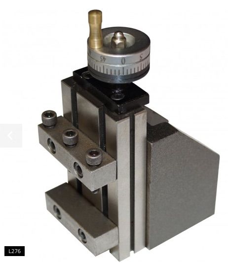

                          Wow, thanks for the detailed replys everyone. The t nuts i need to make are 5mm ones for this mill slide. very small ones. Im also going to make some bigger clamps with some grooves in the centres to hold round stock as well.
                          cheers all
                          lathe mill slide
