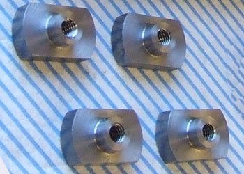

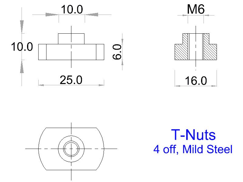

                            Yes T-nuts from bar stock are quite useful, I made some to fit the slots on my WM250 lathe.
                            More detail *** HERE *** not that you really need a description of how to make them.
                            #573190
                            Nick Wheeler
                              @nickwheeler
                              That's exactly what I made, as I needed four for the better compound slide clamp.
                              And another four for the vertical slide mount – I want each tool ready to fit without having to faff about removing fixings from the previous tool.
                              The 25mm diameter is probably the smallest you want, but bigger wouldn't matter especially if there's some scrap available.

                                Journeyman's pattern is the same as Myford's.
                                I confess that I have used hex material to save the milling operation.
                                NB also GHT's tubular tee nuts>

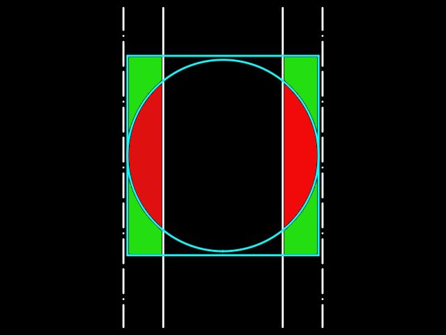

                                    I suggest round headed t-nuts, such as coach bolts, should be used with caution. Tables are often made of cast-iron which is weak in tension. In consequence, they're rather easily broken, especially thinner lathe cross-slides.
                                    In the diagram below, the bearing surface of a round nut (in red) is compared with that of a square T-nut (red AND green):
                                    When the round T-nut is tightened all the pressure is taken by the red area and increases the risk of breaking the table. The problem is exacerbated because the round form also concentrates stress at one point on the table. Conversely, a square T-nut increases the bearing area considerably and shares the bending stress along the slot.
                                    Dr Stephen Hawking observed that each appearance of a mathematical formula in a book halved the number of people prepared to read on! Such slack-shouldered cowardice would never happen on a forum full of engineers. To us maths is just another tool so being asked to do the sums won't cause mass-desertions. Therefore, today's homework is:
                                    In the diagram above, the open slot is 15mm wide and 25mm wide underneath. What's the bearing area of a 24mm square-nut (red and green) and what's the red area under the diameter of the round head?

                                      Using allowable engineering approximation:
                                      area of square t nut 576, area of slot 360, so area in contact 216mm square
                                      Area of circle 452, area of slot approx 360, so area in contact with circle approx 92.
                                      Or under half…

                                                Posted by SillyOldDuffer on 27/11/2021 13:02:20:
                                                Might I suggest that ‘caution’ would start with lopping bits off the circle, making the shape more like Journeyman's bar-stock version
                                                The proportions of standard Coach Bolts [more strictly, it appears, Carriage Bolts] surely lend themselves to this.

                                                  Posted by Michael Gilligan on 27/11/2021 16:03:28:
                                                  Might I suggest that ‘caution’ would start with lopping bits off the circle, making the shape more like Journeyman's bar-stock version. The proportions of standard Coach Bolts [more strictly, it appears, Carriage Bolts] surely lend themselves to this.
                                                  Two tee bolts of exactly this kind came with the tool kit supplied with my Warco milling machine. They don't seem to be available separately on Warco's site.
