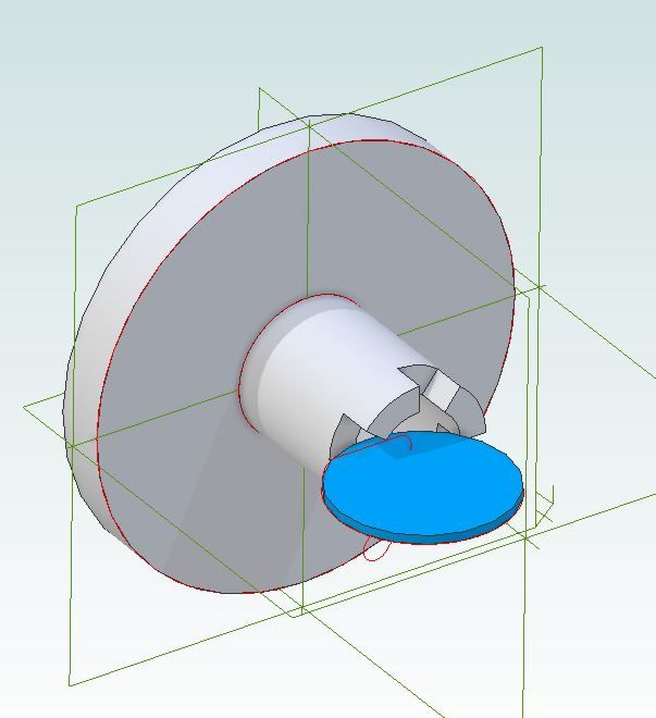

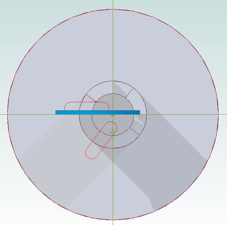

                                  I finally got a rotary table, and so these were the first bits we (son and I) tried on it. Started by turning the spigots for the bearings and castellations:
                                  Made two blanks:
                                  Clocked up in the R/T:
                                  Then milled the castellations with a 1.5mm end mill:
                                  Took three angles to mill all the slots clean: 0, 22.5 and 45 degrees, with the cutter offset to half the diameter:
                                  Finished:
                                  Very nice fit on the output shafts and bearings:
