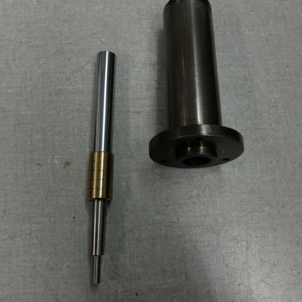

        hello all,
        id like some information please on the best set up and method for making spindle bearings. i need 2 from bronze .
        i have a spare spindle which can be made into a toolmakers reamer and my lathe is a hobbymat md65,i also have the milling machine attachment.
        i was thinking of buying a floating reamer head attachment as id like to get a good tolerances.
        what do you think? whats the best way forward please?
        cheers.

            ok,
            the spindle measures 10.985mm so im thinking an 11mm h7 reamer work do it? the spindle only turns at 33. 1/3 rpm.

                      jamie creighton 1
                        @jamiecreighton1
                        sorry i should have been more clear,the bearings im hoping to make are not for the lathe,the clues in the rpm of the spindle, 33 1/3
                        #596702
                        jamie creighton 1
                          @jamiecreighton1
                          thanks hopper,yes it for a turntable.
                          im measuring the spindle with a digital micrometer whic is reading 10.985,is that classed as 11mm norminal?
                          anyway i believe an h7 11mm reamer is the correct size?
                          sorry for the dum questions but id like to get this as accurate as possible .

                          Hopper
                            @hopper
                            Sorry, brain fade on my part, yes 11mm h7 reamer should do the job for you.

                            Paul Lousick
                              @paullousick59116
                              Also be aware that a bronze bush will squash slightly if it is a press fit with the housing. Commercial bushes are designed with a specific size/tolerance for the hole in the housing and the bore of the bush is made oversize to allow for the compression when it is installed. A reason to ream the bore to size after pressing in the bush.
                              An alternative is to machine the bush to the required bore diameter and make its OD a slide fit with the hole and use Loctite to secure it.

                                Versaboss
                                  @versaboss
                                  No reamer used for my turntable bearings, just carefully turning/boring (and some 3M microfinish foil)

                                          One aspect you might consider is that while it might be possible to better Oilite tolerances in a custom made bushing, in use the Oilite would more likely wear better and stay within its tolerance due to the self-lubricating nature of the oil-soaked sintered bronze material.

                                            Hi Jamie,
                                            That is a lovely piece of work, you should be justly proud of that.
                                            Using an H7 reamer will give you the same size hole as the Oilite bush. These are normally supplied to give an H7 bore when they are pressed into a hole which is itself H7.
                                            Hopper has the best option and it is something I have done in the past. That being to machine a custom Oilite bush. Billets of solid Oilite used to be available and this would give a better self lubricating bearing solution.
                                            Torlon in my experience takes on moisture so you might have problems with this material. Especially if it is machined in a humid atmosphere and then lives in a relatively dry environment.
