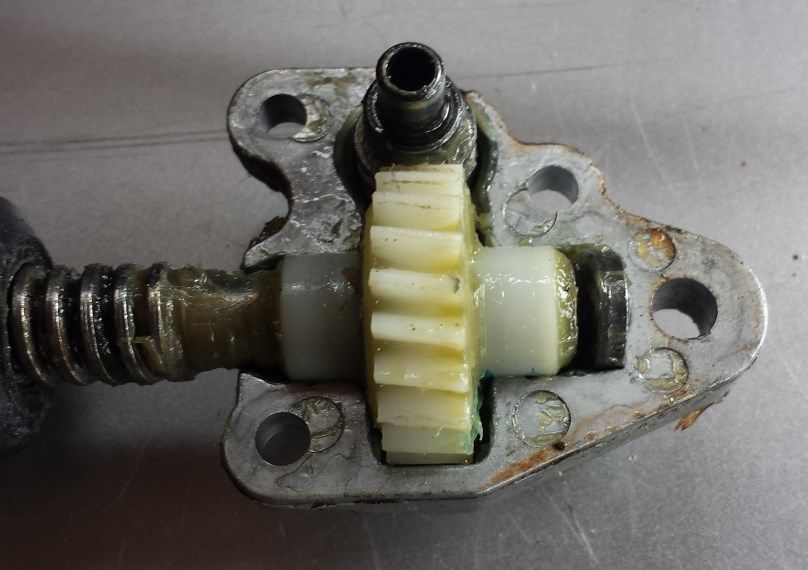

    Dave Smith the 16th
      @davesmiththe16th
      Tried a load of the gear lists and nothing seems to match my gear. The closest is a 20DP gear, but the OD is 1mm smaller than the gear in the picture below.

          As I said earlier the diameter will vary depending on teh helix angle so unless you can find a gear with the same algle you won't get an off the shelf match.
          How does the gear fit to the shaft as that is something that may also need to be correct especially if it is splined or otherwise shaped internally.
          Hoppers option sounds good, what is it off?

            The plastic gear must have been formed on the shaft. I think the thread on the left part extended the entire length and they ground some off and then sliced some to lock the gear into place.
            Searching a wreckers wont help find a solution to a weak part. Thats why i need to make a gear our of something else.
            Thanks.

              Measure the angle of the teeth with a protractor. Cut the gear like you would cut as a straight spur gear with whatever module cutter matches the original, or make your own flycutter. But set the gear blank up at the same angle as the teeth on the original. This will give you the angled teeth to match your worm. Yes it is not a true helix but it works, especially for low load and infrequent load applications like this.
              For indexing, use a lathe change gear or similar mounted on the end of the spindle you mount the gear blank on for machining, with a pointer engaging with the teeth to lock it in position for each tooth.
              Make the new gear out of bronze and drill, pin and loctite it in position, after turning off the remains of the old moulded-on gear.
              To avoid future wear on the gear, keep the "leadscrew" that it powers lubricated with a non-stick teflon spray on lubricant. The failure of teh original gear was probably not down to "weak part" as to unlubricated screw causing overload (unless you weight 300kg or something !)

                The issue is nothing matches the original gear. The equivalent would be a mod 1.314 ?? A DP20 is the closest but the figures suggest that its 1mm smaller than the gear i need to make. I made a tool which seems to fit but whether it cuts who knows
                I need a straight flycutter no an angled one.. Silly me.
                Plenty of grease in there normally and its in a sealed part of the motor, so not a lot of space for the grease to escape. Although i have not seen how much grease there is in one thats broken.
                Its a common failing point on these cars, so i think the part was slightly under specced. Although they last well beyond the warrranty so to them they got it right. Why spend more when it fails out of warranty and you can sell them a new motor because the gears are not sold on their own.

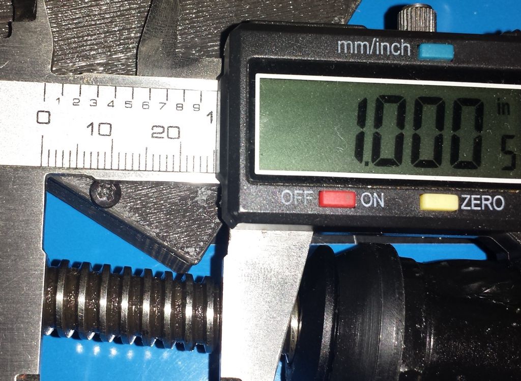

                                    Dave are you sure it's 8tpi as that diameter and the sizes of crests and vallys you mention could make it a standard 12×3 trapizoidal thread.
                                    Might be possible to get a flanged nut and cut the gear teeth into the flange, solder on an extra bit of brass/bronze for the other side.
                                    Or you can buy taps for under $20 on the net which you would soon recover if making for other club members

                                      Never sure of anything but with a bit of parallax error

                                        I couldnt find an 8TPI tap under 12mm diameter. 0.468 i think? I put that measurement in a previous post.
