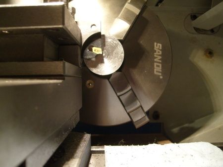

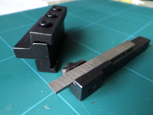

          It's usual for parting off blades to be held in a holder:
          The one behind is for a carbide insert blade, but similar can be done with HSS. The lower is for a shop bought 2 x 8 mm HSS blade – the sides are wedge shaped to provide side relief, not parallel.
          The height is adjusted by the shimming the holder in the usual way, but make sure the holder fits your lathe.

            Parting on an old lathe with a home-made tool could be a recipe for frustration. Parting off is a rite-of-passage for lathe owners. I never had any luck with HSS parting tools. You can buy excellent carbide-tipped parting tools such as these:
            https://www.rdgtools.co.uk/acatalog/8MM-Shank-Parting-Tools.html
            **LINK**
            which use inserts. I have a similar one actually made by Sandvik which I have used for years and it is excellent – in fact I just parted off a bit of 1" square steel using it running at 200-odd rpm.
            In my experience parting off goes better with quite a high spindle speed and a fine X feed – I was feeding at 3mm/minute for my bit of square bar. This makes sure that the "tooth load" is small but there is plenty of heat being generated at the tool tip to soften the metal. The temptation for beginners is to use back gear and try to feed very slowly by hand – inevitably the tool digs in, the lathe stalls and the air turns blue.

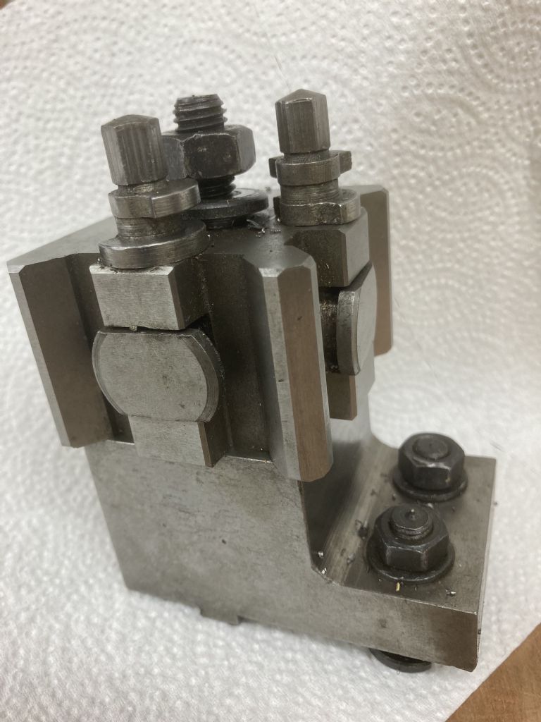

                  This is my M Type rear parting off tool.
                  The tool holder is at the rear on the carriage with the blade upside down. It is solid with a 2mm blade and it has the original tip in I fitted when j made it at least 18 months ago. You can just unclamp the top and slide the blade to the right length for the job in hand.
                  David

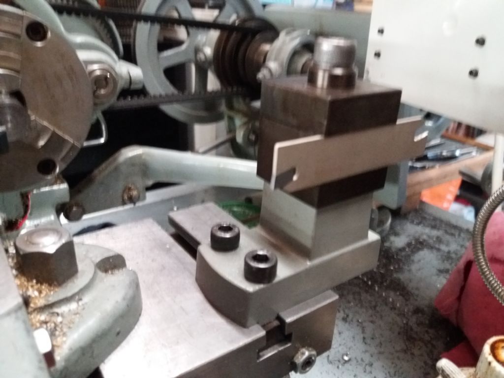

                      I never managed to part off in my lathe(s) because my bench type lathes are just no rigid enough. Since I reversed the the tool position parting off has become an "easy job" using a 1.2 mm HSS blade or a 2 mm SP200 insert.
                      I make my own tool holders to keep the blade as close to the tool post as possible. I set the tool height by grinding the bottom of the tool holder until the height is accurate. I check the heigth by facing a piece of aluminium until the "pip" at the end has gone. Be sure to check the pip is removed by turning and not breaken off by a to low tool.
                      The top of the parting blade is supported by the tool holder to make it more rigid.
                      On the mini lathe, I also lock the top slide gibs for a more riged setup.
                      Parting tool upside down

                        sorry Chris but you need to have a good look at GHTs rear tool post design, it does no strain the T slot as everything is sandwiched together making it an extremely rigid affair. Funny how there hasn't been any designs to supersede it!!!

                                    If I remember correctly the parting blade slot on GHT's rear tool post is machined on an incline providing easy adjustment of centre hight. The slight lifting/flexing means that the tool is disengaged from the work slightly which prevents digging in.

                                                I too made the GHT rear parting toolpost many moons ago & found it a great bit of kit held down with 3 bolts, I just Googled the OEM Myford offering which is held down with 1 bolt so fail to see how it can be a better prospect in the parting & rigidity departments.
                                                Tony

                                                  That's odd mine has 3 bolts. Neither Myford or RDG are showing stock for rear toolposts at the moment but thats where I got mine.
