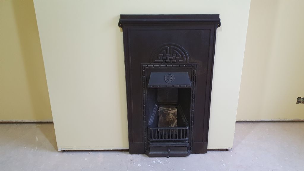

        Far from model making but im sure some knowledgeable people on here could advise. Long story short, I have restored a couple of these fireplaces for my house and unfortunately the mantel shelves have been lost to the sands of time and I would like to fabricate some out of mild steel. No problem there however the fireplaces are the bare, raw cast iron dark grey colour/finish and I would like to try and match this for the mantels if possible.
        They will obviously be manufactured from mild steel, welded and ground/dressed etc. Just wondered if anyone could offer any advice on how to make them look like an original cast item. Painting is the last resort really, but will paint the mantels if necessary.
        Thanks, Craig

          Sand blasting might provide a finish you like better?

              Possibly with some steel shot mixed in
              The Black finish may be Zebrite

                  The black finish is not as-cast. It's probably a phosphorus dip, (like jenolite) which will turn surface rusting black and give a hard corrosion resistant phosphate finish.
                  You can simulate this on mild steel by allowing it to rust, wire brushing then treating with a phosphate rust treatment.
                  Another alternative is a fireplace 'black lead' like Zebrite (which is actually graphite based).

                            Let it go rusty, then soak it citric acid – which should result in mild steel taking on a grey pitted appearance.

                              To colour it after adding some texture, you could use cold blackening solution, on items too big to submerge, it actually works very well if brushed on in a flooding type of manner, you'd need to hold it over a plastic tray or something.

                                  As mentioned above steel shotblasting gives a good representation, At one time I worked for someone fabricating replica vintage/ veteran car parts and we had them blasted with steel shot ,it's quite hard to find places that used it, I found a marine company that did it as a favour and a donation to the tea fund. You must carefully mask any threads or bearing seats before blasting, It's a very convincing effect. Normal sandblasting didn't have as convincing an effect, but works for replicating forgings quite nicely.

                                        I knew a fellow stationary engine owner who set out to make a cover for the hot bulb of an 1890s Hornsby hot bulb oil engine,the original cast cover was long gone ,so he welded and fabricated a cover from 1/4 steel pate ,its box shaped about 8/10 inches cubed ,open sided with 3 flat pieces and one curved part. to get a cast iron effect on the steel he got a 3/8 twist drill bit broke off a piece off the sharp end,put in an electric drill and with drill running just let the drill bit rattle around on the steel,when it blunted ,a bit more was broken off the drill and the process restarted and he carried on until the cover looked like a casting,and he made a very good replica of an iron casting,he was very skilled and had lots of patience. I have found that when making replicas the welding has to be very good and then ground down to a smooth finish to hide all the welding marks,if not the welds will show through any grit or bead blast finish . Though thinking back to my childhood,the fires in all the bedrooms were all cast and had a fairly smooth finish,should you bite the bullet and go for the pattern /then casting route,ask the foundry to avoid any runner and riser marks on the top visible surface and not trim too closely with an angle grinder when the risers are cut off by the fettlers,they are usually on bonus pay. Another way to get a cast effect would be glue or bond a layer of very fine sand over the surface and then paint it with blackboard paint,or semi gloss black paint which I use on large engine flywheels.A matt or semi gloss does not sparkle on the spokes like black gloss paint does on 3 ft cast flywheels.
