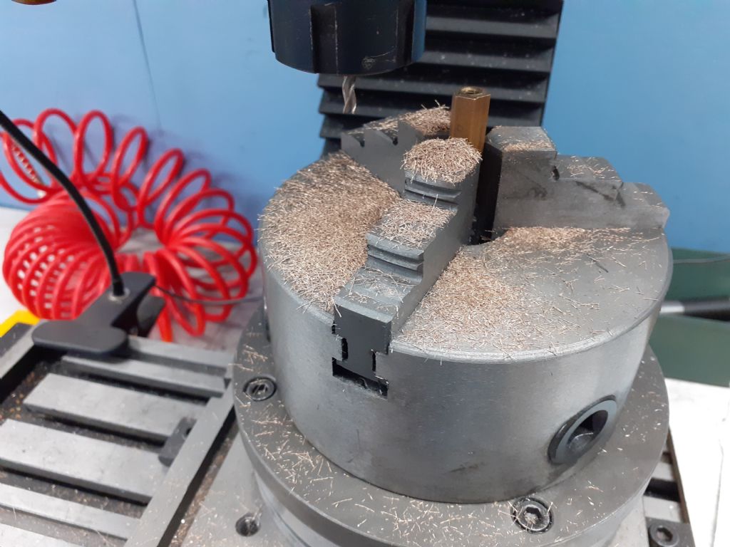

                  Easiest way is to mount your lathe 3-jaw to the rotary table and hold the stock in that. If you disengage the worm you can quickly spin it round and just use the graduations on the edge of the table and lock it every 60deg. Faster then having to keep resetting an ER block in a vice.

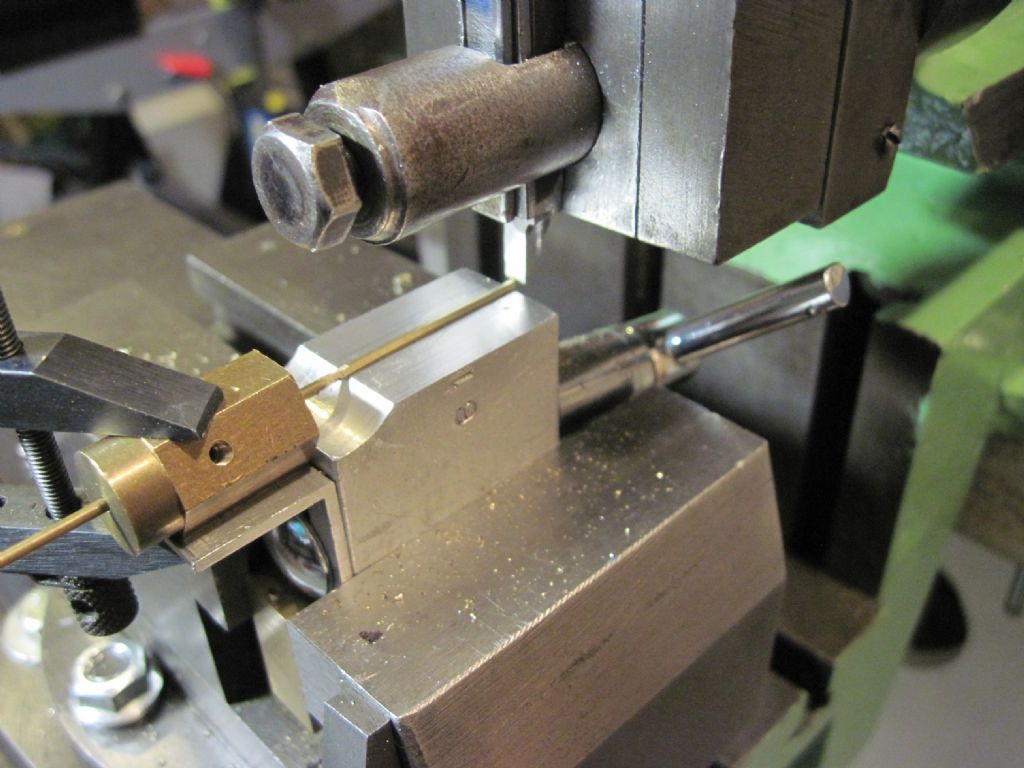

                    Depends on the size of 'hex' bar you need Phil.
                    I haven't been able to find very small hex-section brass bar, so if I want to make 14BA nuts (which are expensive) or 16BA nuts (which are unobtainable), then I have to make my own. It's a problem for me, as a scale G3 wagon can use a lot of these small parts. A 5/8th (pre-war) Whitworth nut is 0.7mm AF in Gauge 3 for instance.
                    One problem with thin materials is that they will simply move/flex if they are extended too far without support. One solution is obviously to only extend the material out a little but then this greatly extends the time required to make a usable length of hex bar.
                    My solution (whilst far from perfect) uses a hand shaper and works, although it's still not as fast as I'd like. As I need to get a uniform part thickness, I first machine the aluminium support to ensure it's perfectly level – which is much easier than trying to set a small part in a vice. The small Hex block is simple to turn after each cut and sometimes I just hold it in place – with a fore finger pressing on the part. No problem with a manual shaper but certainly not advisable with any form of rotary or powered cutter – although with a toolmakers clamp (as shown) a mill could be used.
                    My next experiment in this area will probably be to try a Hex draw-plate, using a small Allan key to make the hex-hole punch.
                    smiley
                    Regards,
                    IanT

                          Phil, did you miss the bit where I said mount your 3-jaw chuck to the rotary table, work then held in chuck

                            #534203
                              What is your lathe's chuck fixing?
                              #534204

                                Posted by IanT on 15/03/2021 18:04:03:
                                smiley
                                Regards,
                                IanT
                                That looks a good way of making very small hex barstock. Machining the ali 'bed' first to get a reference plane makes good sense. If you start off with round rod and do three faces you then presumably have to raise bed for the next three?
                                Is the cut taking place on the forward or reverse cutter stroke? In normal shaper usage it looks like the small diameter work could easily buckle as its pushed towards the indexing hexagon block.

                                  Posted by JasonB on 16/03/2021 15:06:01:
                                  1 1/8 12 tpi, Jason. It's a 1947 Myford ML7. The morse taper shank can be removed from the headstock.
                                  Mike.

                                      IanT
                                        @iant
                                        Posted by Ian P on 16/03/2021 15:11:15:
                                        Ian P
                                        It's cutting on the forward stroke Ian – but the cut is very light in these sizes. A finger helps prevent any lifting/buckling – but I wouldn't try that on my 7B. The angled 'shelf' (the hex holder is sitting on) can be moved to level the holder with the block's cutting surface – there's a clamping nut on the rear side of the block. In terms of the 3rd to 6th cut, you are correct to observe that either the cutter needs to be lowered – or (as I now tend to do) a thin shim inserted underneath – meaning the cutter height is unchanged (locked) for multiple lengths. The material is simply advanced by unlocking the grub-screw in the hex holder. You can't really see it but there is also a slight relief filed at the end of the material where the 'cut' ends – to help the tiny swarf slivers fall away.
                                        There are other ways to do this work of course – just with a file for instance – but a hand shaper can make quite delicate cuts (with a sharp tool) and is well suited to work where you don't need to remove large volumes of material.
                                        If I didn't have the shaper – just a lathe – then I think multiple lengths could be set on a shellac (wax) plate and faced – then turned and faced again. Using a heat gun and tweezers it would take six rounds of 're-setting' the lengths but you'd get a larger quantity of small hex at the end. Not sure if it would be any quicker but I think it would be possible with care. Larger hex can be done as others have suggested of course.

                                          Posted by Phil Meaken on 16/03/2021 15:28:14:
                                          Mike.
                                          Something like this fitted to the R/T's slots or onto a sub plate if needed. You can also get similar with a Unimat thread if you want to mount the smaller chuck onto the R/T

                                                Looks like I forgot the link in my previous post. This will allow you to mount the lathe chuck onto the R/T
                                                You can then have the table horizontal to do a longish length of hex or vertical for short lengths
                                                Edited By JasonB on 17/03/2021 15:17:47

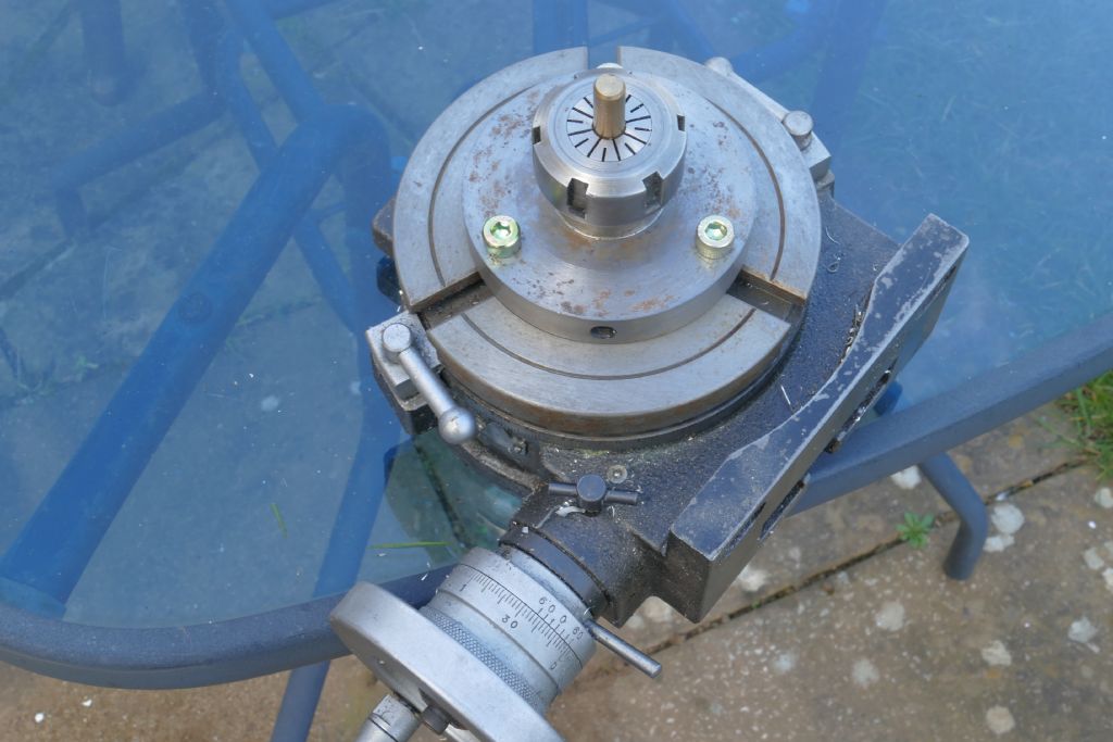

                                                Martin Connelly
                                                  @martinconnelly55370
                                                  How about this as well. ER chuck on a rotary table. Does not even need accurate set up if you only cut on one side of the stock and the stock is oversize by a small amount. Drill, tap and use a slitting saw to cut off.
