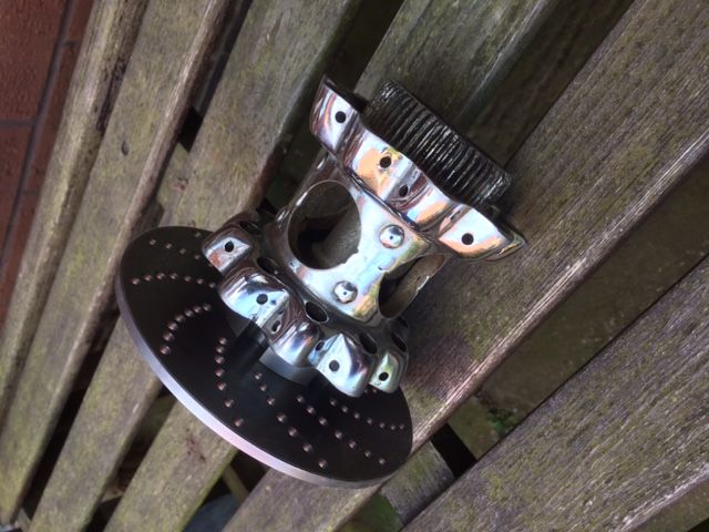

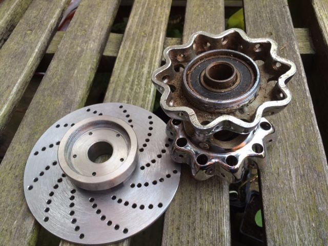

                  Here is a photo of the rear brake on my Classic Racer from 1966 – a genuine fitment at the time. Quite capable to haul the bike down from 'flat out' to 10mph on the IoM!
                  Disc mounted on Gold Star 'Crinkle' hub
                  Disc carrier and hub

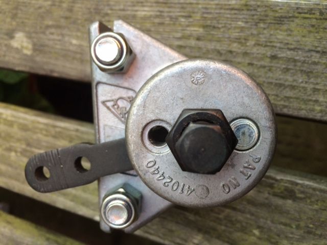

                  The Air Heart calliper with cable operation.

                      No Probs! I like photos to be clear and well defined – that was taken by my main camera (Apple iPhone!)
                      The cable operated calliper is a simple 'ramp' system with adjustment by way of the central bolt which acts as the pivot point. The actuating lever can be reversed for either left or right hand 'pull' – simple, efficient and practical.
