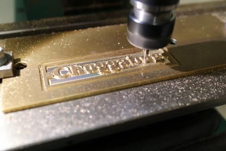

            f-engrave works well and is free. You can generate g-code from text (it includes a simple text editor) or from bitmap files – the latter might be better for this application. I have used it to engrave two commemorative plaques and also for a couple of loco nameplates – the latter from a bitmap.
            This is a picture from my albums, I posted on the workshop progress thread at the beginning of the year. It would be interesting to know how you get on, I've got to make a clock face sometime soon.

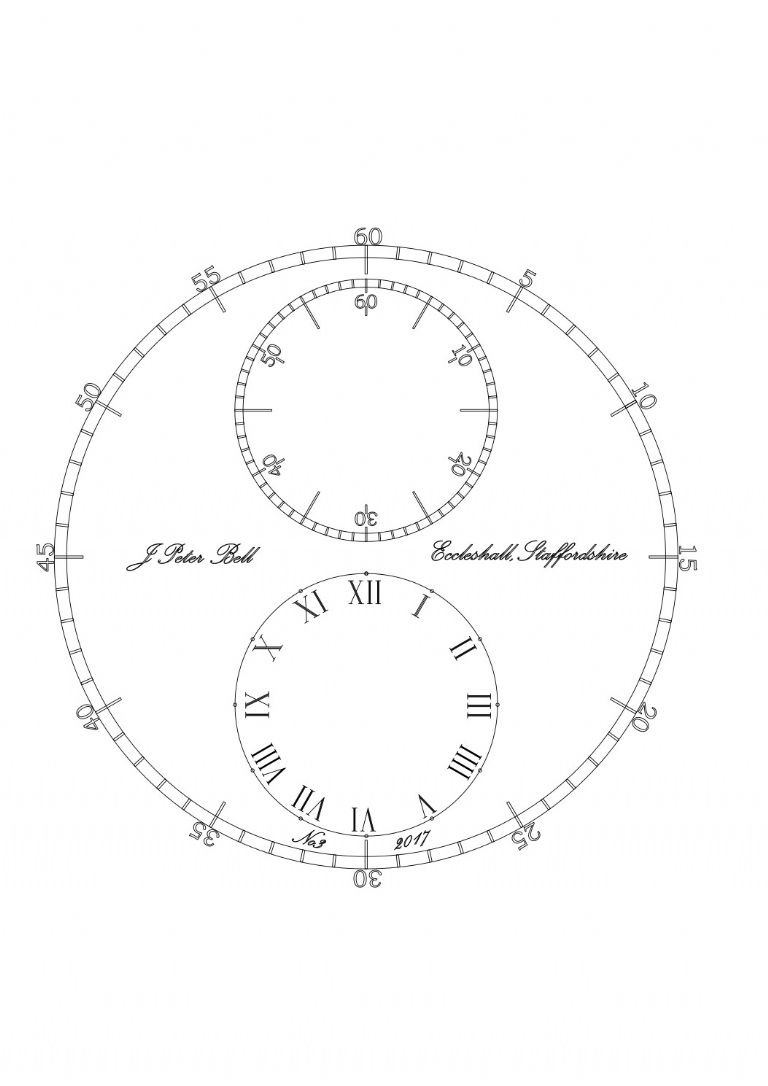

                  I use Vcarve pro on my KX3 (trail version is free) and I have drawn the attached dial but havent got round to cutting it yet. Looking forward to having time!

                    Peter, that's a very nice looking dial!  What clock is it for?

                        The dial is for the John Wilding Regulator, its been running nicely now for a couple of year, it really deserves finishing off, only been on with it since 1988.
                        Seeing other nice examples of this and other clocks on this forum has truly inspired me.
