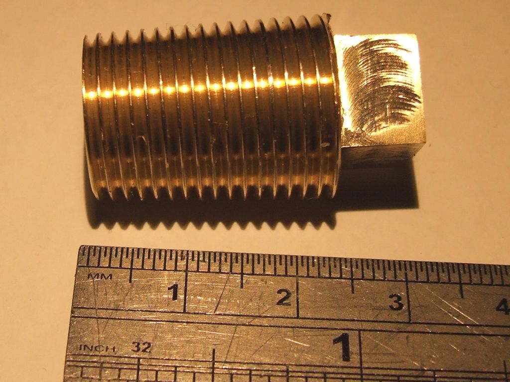

                      Use a hydraulic copy unit with a simple tapered pattern:
                      In this instance set up for cutting 3/8" BSPT threads:
                      Andrew

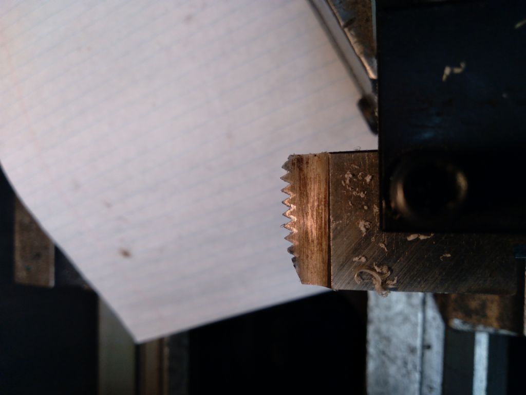

                                    Here is a hint for Someone Who does not have a taper attachment. This pipe chaser is put on square against the tool post,20230616_175440.jpg

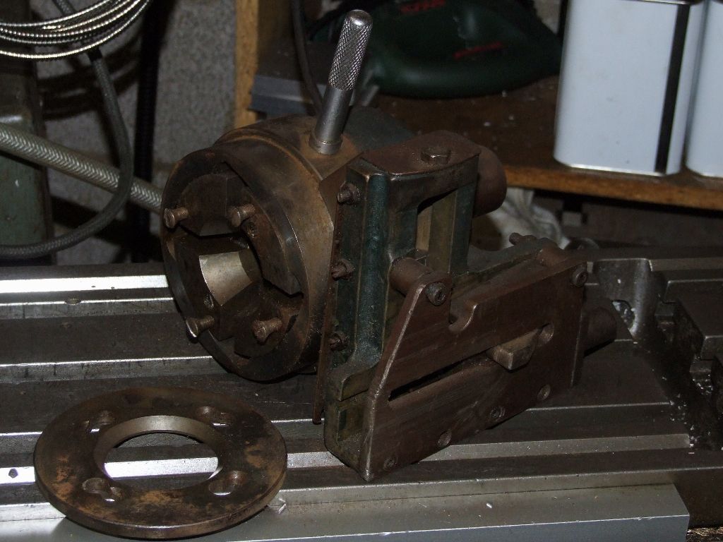

                                      Even better use a Coventry diehead that opens up as it moves forward thus cutting a tapered thread:
                                      Andrew

                                          This is just what hand chasers can be used for to great effect. Put a piece of square bar in the toolpost at the angle you want and then cut your thread by allowing the chaser to cut the thread, sliding along the bar.

                                            I did try using a chaser as described above by Speedy Builder. I wasn't too confident that it would work, but it did the job! Then Speedy neatly confirmed it
                                            The thread profile was nothing like the old fashioned sawtooth (Same as on ripsaws) that the original had, however it held the mop securely enough. I will probably use the commercial variant in anger. But it is ego boosting when you get a result and it satisfied my curiosity.
