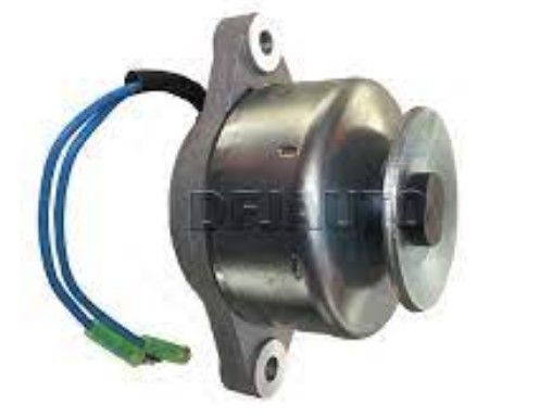

      John MC
        @johnmc39344
        No idea what size or output alternator is being discussed, I'm guessing the article refers to making one? To be driven by steam or IC engine of what size?
        Rather than make one, how about using one of these.
        screenshot 2023-07-12 at 14-57-05 title kubota 12 volt generator 175316401 155316401 dfjauto.jpg
        Known generically as a "Kubota" alternator, I think it has an output of around 150watts. Would probably need 1/3hp to drive it. Will give useful output at around 1500rpm. Price would be around the £90 mark with a suitable rectifier/regulator. The largest diameter is about 85mm. The mounting bracket can be easily modified.
        Clearly no good for a Stuart10V/H but good for the larger engines in their range. Could easily be dressed up to look "period". Or sat on the front of a showmans engine?
        If anyone needs dimensions of one of these let me know and I will measure one up.
