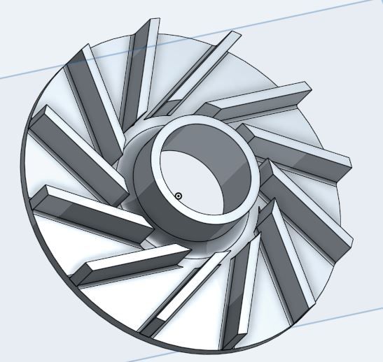

      I need to make a number of small fans. These are around 52mm diameter and at the thickest part are 10 mm thick. The blades are approx 6mm high and are around 1.5mm thick. There is a metal insert in the centre with a reamed hole.
      The fans are for some smallish motors rotating at around 5-6000 rpm.
      I had considered making an aluminium mold but its very tedious cutting the slots for the blades….
      I have the central metal inserts recovered from the original fans which were destroyed when they were removed from the motor shaft….
      So what is the best approach to manufacturing a few of these fans?

          Could you take a silicon mould of the one illustrated and then cast them in G26?
          #294398
          Journeyman
            @journeyman
            Looks like an ideal candidate for printing if you only need a few.

                At 5-6000 rpm as stated I would be concerned about 3D printed parts (by any method) staying together. Balance of parts, particularly large diameter parts, is critical at those sorts of speeds.

                  CNC mill…? Take quite a long time but just leave the machine to get on with it. Material aluminium or perhaps corian. The latter mills beautifully and quick, have just been making a part in it.

                    I had considered taking a mold from this example…..still pondering, but what is G26? Some kind of casting resin I guess?
                    I had thought of injection molding, but have no IM facility, thought of reinforced polyester resin ( chopped fg strands?) but not sure if there would be enough strength in the little blades….
                    Journeyman,
                    Yup thought of 3d prints, not sure if they could capture the blade detail…..besides it would require a 3D cad program thingy creating for the printer ( stl file?)

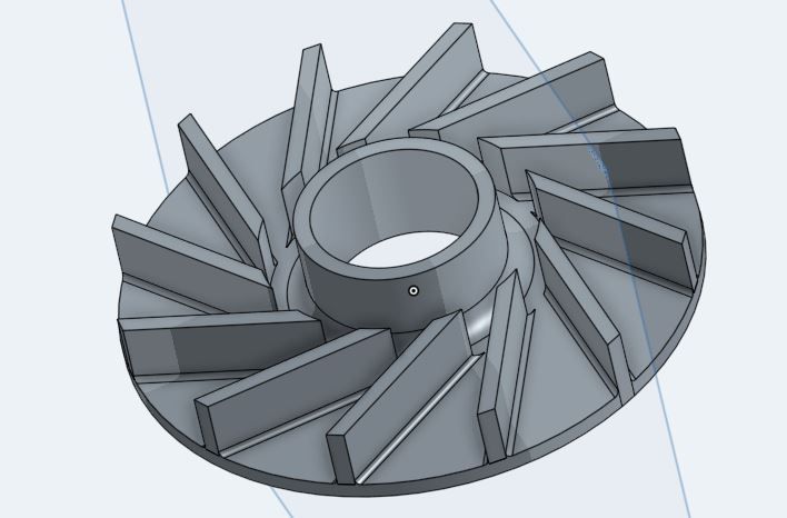

                            The aluminium bore was insert molded in the plastic fan so that the fan didn't slip on the shaft. The rest would have been plastic for ease of getting them balanced (light weight) and of course cost.
                            Later drills had straight knurls on the armature shafts I think and had fans that were just plastic. I'm thinking that GFN would have been a likely material …… high softening point and quite stiff and strong for a plastic.
                            The thing is, if the fan bore cracks and slips, or the fan breaks, then it's not good news – the motor will burn within a very short time if being used in anger.
                            So really, if you wanted make fans that would allow you to actually use the drills in anger, then I agree with JH, the simplest way is to CNC a new aluminium fan of thinner section than the original to keep the mass down, unfortunately. I think Corian may be too brittle to reliably press on the shafts though, but I 'm only guessing here.
                            3D printing may be a light duty possibility, perhaps, if you never want to use them to do any real work and keep them cool, but they are not going to last long in my opinion. Perhaps that would be acceptable for you however, since they really look too good to get dirty.
                            One last point . perhaps some of the fans are repairable ? If for example the bores were destroyed, perhaps sleeving could work ?

                                me again …… just realised the fan blades are straight, so no problem to machine new ones with a rotary table and a normal mill. No CNC needed.

                                      Yup, Already tried that….took a looooong time…..looked good when finished, but my little mill couldnt cope….the motor packed up!
                                      Might have to revert to that method of production and take more time…..

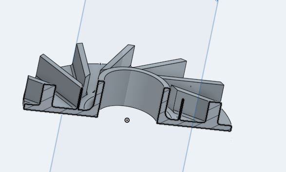

                                            It's still a thermoplastic nylon, but filled with glass fibers. should be still OK at 200 to 240 degrees c.
                                            You can tell if it's nylon by taking a small bit it and setting it alight. Blow it out and it would smell like burned wool. Of course, that assumes you have previously held a sheep over a flame as a reference ……….
                                            If you gently cut a sliver off the fan with a snappy knife, you would feel the fibers cut if it was filled.
                                            If it's not GFN, perhaps something with a lower temperature like ABS ?

                                              Having both CNC and 3D printing equipment, I would do these in 3D. From your description and some rough guesses, I drew the attached in about 20 mins, stl file comes out from the drawings (in Onshape, stored in public under "small plastic fan" if anyone wants to play further with them). Dimensions taken from your text plus some guesswork to be roughly right.
                                              Get them printed at a 3D printshop from the web in 'whatever' – probably ABS or nylon would be best.
                                              Definition is down to 0.1mm so detail should not be an issue.

                                                    How many do you want I can CNC machine them Ali, Acetal or what ever, if you provide the original as a patern,
                                                    if they come out of offcuts you just need to pay the postage etc
