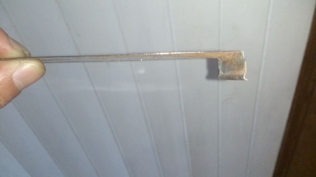

        My venerable Bosch belt sander gave up t'other day – the 'slide plate' (Bosch terminology), which is the steel plate the belt runs over between the rollers, has worn through. Can't complain, I've had it maybe 25 years! An OEM replacement is (unsurprisingly) unobtainable. I'll probably just buy a new machine, but as it works OK apart from this plate thing and I have an aversion to chucking stuff that can be revived. I am wondering if I can make a replacement myself.
        The plate is 0.5mm spring tempered steel – I hope the pic below will make it clear how it fixes to the machine. Question is – given that I have no metal folding machinery other than a vice and hammers, and no experience doing this sort of thing, what are my chances of succeeding in this? On a scale of one to ten if you like!
        Daft perhaps to think about spending an hour or so repairing a 50 quid machine, but I just feel bad about skipping stuff. Still using my late Dad's metal-bodied power drill bought in the 1960's! Works fine.

          You could make a replacement from "Band-it" strapping. The steel straps that are used to tie heavy materials to pallets etc. It is about 0.5mm thick and springy steel. Available in different widths. I have some offcuts 1/2" & 1" wide. Very useful for various projects and free if you can find it. Check industrial sites in their rubbish bin.
          A vice, hammer, hacksaw and a file are all you need for manufacture.

            You would be amazed what humans can make when they don't know what thay are doing – how do you think the wheel was invented ?
            Some pics of the piece you need to make from a few angles might be helpful and some of how it mounts to the machine like wise .
            if it just the support surface for the belt to run over it was more than likely not hardened and i suspect it was nothing more than a piece of angle iron and zinc plated.
            A hammer , vise , a saw , afile and a drill should get you by

                I inherited a couple with damaged plates……no replacement parts avail…….I used some stainless sheet for the job, just enough spring, still using them 10 years on……clogs……..

                    As said, Stainless Steel sheet, or perhaps some thin Gauge plate?

                          Thanks, I'm encouraged by responses that it's doable with primitive tools.I have some stainless sheet so shall have a bash (literally) at it. I'll buy a new machine for myself, but if I can get it going again maybe it'll serve someone starting out.
