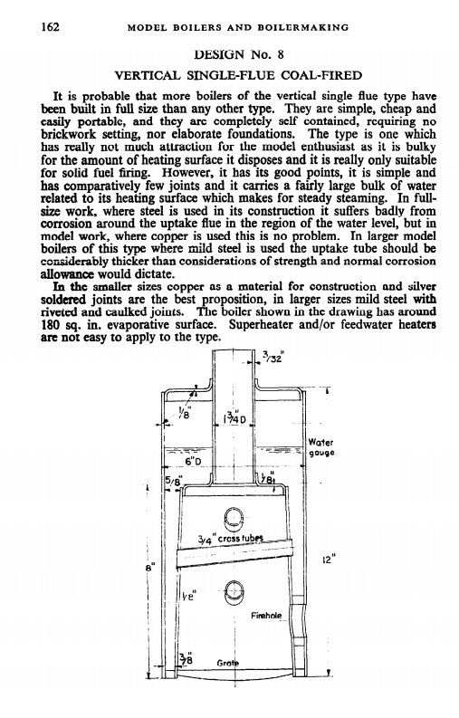

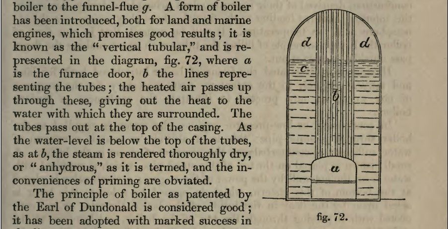

                                        Ajohnw
                                          @ajohnw51620
                                          I came across an interesting thought on a vertical boiler so thought it might be worth posting here to keep it all together.
                                          It looks like an interesting mix of water content and heating area to me plus a fair chance of super heating if the space at the top is big enough.
                                          #199345
                                            Plenty of vertical boilers like that about John, they usually have a "smokebox" at the top that gathers all the fule gasses into one chimney
                                            #199373
                                            Ajohnw
                                              @ajohnw51620
                                              I thought that the general proportions of space tor the fire, flue tubes and water are a bit different to what I have seen at the model engineering end. Probably not as efficient but maybe more convenient.
