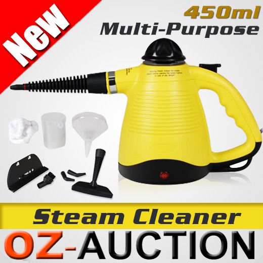

                    Hi Peter,
                    Sounds like you only need a small boiler at very low pressure if it will run from an old kettle. Making a boiler as you have described could generate far more pressure (depends how much you heat it) and could be dangerous. I would not recommend building one unless it is from a certified drawing and made to a design standard.
                    A friend of mine runs small engines from a steam cleaner. Available for less than $30 on flee-bay or hardware stores. (This was shown in an earlier post about using compressed air to run steam engines). Use a plastic hose that is pushed over the end of the steam outlet. Not clamped so it will blow off if there is too much pressure.
                    Paul.

                      Some others have used a coffee machine.
                      I suppose you could use the boiler suggested in the article you used to build your engine.  A pipe nipple, with caps screwed on each end, can't remember if you have that drawing.

                          A wallpaper steamer is ideal if you want a fair volume of low pressure steam, noting that the 'boilers' have a built in safety valve (in some cases a an old style radiator cap). A heavy duty dimmer switch could be used to 'regulate' the steam rate.
                          #198348
                          Ady1
                            @ady1
                            The wallpaper steamer is a good low pressure starter, particularly since they have a built in safety valve
                            Easier than using say, an old pressure cooker yer mam used to make stew
                            edit: don't use this system indoors until you have some experience, the mess on the ceiling if it suddenly blows may irritate the missus slightly
                            Edited By Ady1 on 29/07/2015 15:02:13
