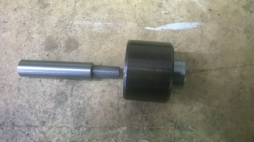

      I recently decided to replace my aged revolving centre (with a simple cone point) with one fitted with a modified double-cone to give more legroom for lathe tooling. I pondered what to do with the old centre and remembered reading about a rotary broaching tool on Mike Cox's web site, here .
      It occurred to me that instead of the broaching bit rotating in the mounting block, I could "re-purpose" the old revolving centre to achieve the same result. Chucking the centre in the lathe, I proceeded to remove the point, which turned out not to be very hard at all. I then centre-drilled the resulting flat end 6mm and was then able to press out the Morse taper, leaving me with a small collection of pieces:
      Component parts
      Scavenging around the spares boxes turned up a piece of 12mm silver steel which was turned to suitable dimensions to make a new spindle.
      New spindle parts

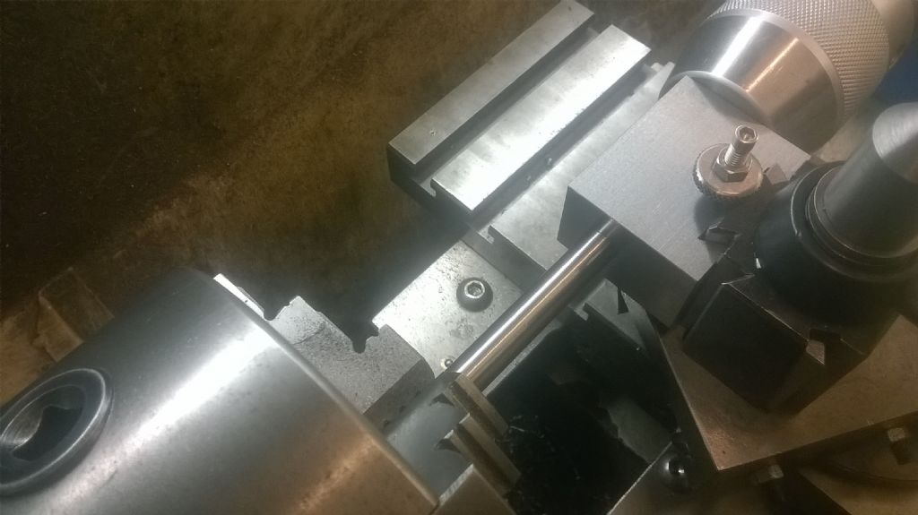

          Further, steady progress today. I've finished machining the dovetail in the mounting block, drilled for the height adjustment screw and made the height collar. Mounted on the QCTP, it was aligned with the lathe centreline, the outer side being parallel to the piece of silver steel rod used for the purpose.
          Aligning the block to lathe centreline

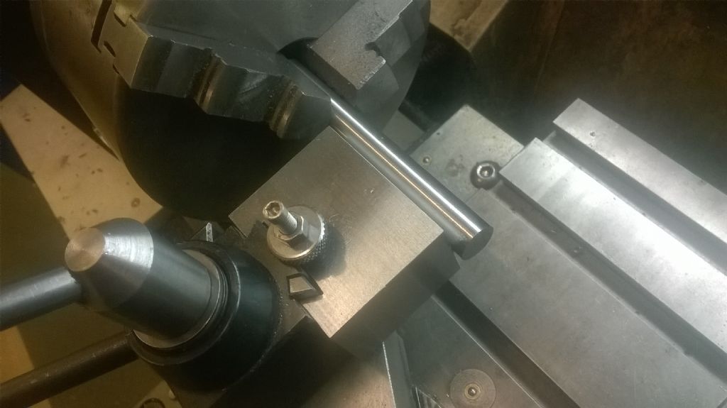

          Next job will be to drill the hole for the spindle. To that end, I set it up as below. With one hand, I'll be moving the cross slide, with another I'll be providing the thrust with the tailstock and with my other hand applying lubricant!
          This is the set-up I'll be using, though with a drill, or series of drills, not a piece of drill rod.
          Drill set up
          Tomorrow will see me doing the drilling and I think I'll put in a grub screw to retain the spindle in place and maybe add some sort of thrust bearing. The design is evolving as it progresses.

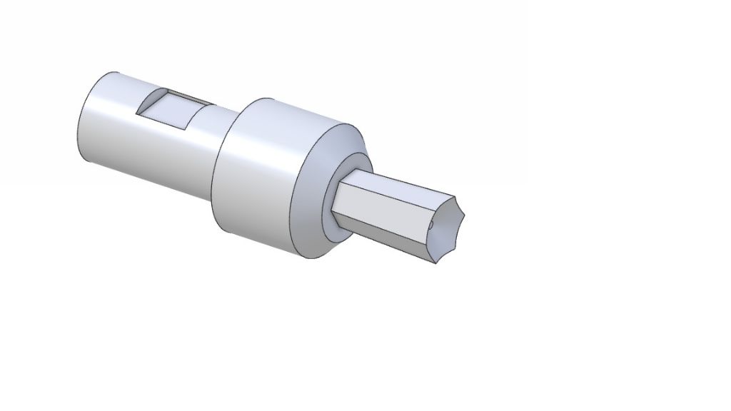

              I've knocked up an Alibre Atom 3D image of the cutter. Hopefully make one in silver steel tomorrow.
              Cutter 3d image
              This to make a cutter 6mm tip to tip diameter, for scale.

              Roderick Jenkins
                @roderickjenkins93242
                Hi John,
                I would put a good radius at the root of the hexagon. I didn't on my first attempt and it snapped off at the transition.
                HTH,
                Rod
                #494921
                John Hinkley
                  @johnhinkley26699
                  Good point, Rod. I'll give some thought to how I can achieve that. I think I've got a small hss radius tool somewhere that I made for a job I did for a friend a couple of years ago.

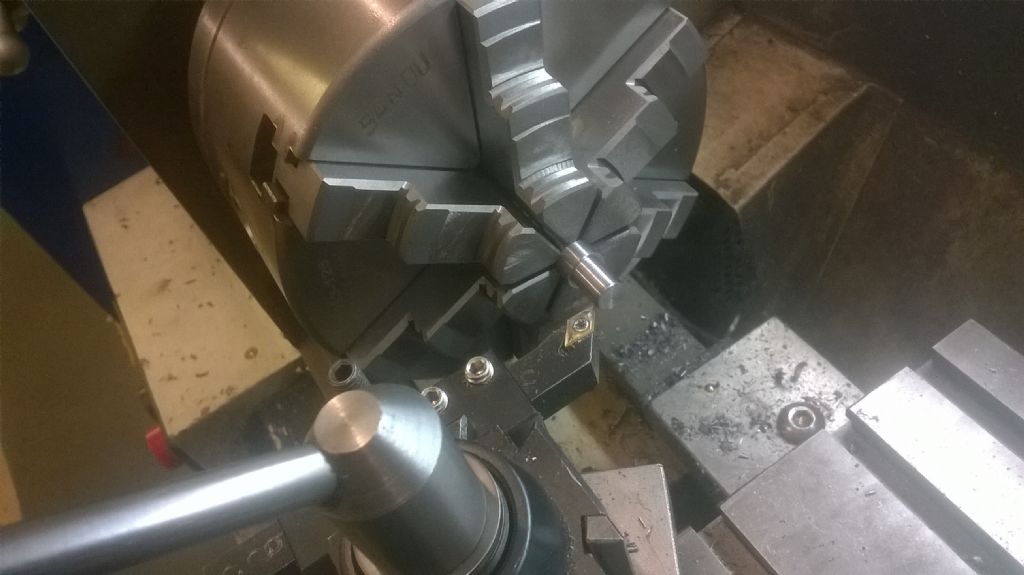

                    I decided to try out my latest extravagance – a 6-jaw chuck – to hold the stock for the cutter tool blank.
                    Turning the cutter blank
                    I just screwed it to the backplate with no particular attempt to true it up and the TIR was minimal – about 0.02mm at 25mm from the chuck jaws. Pretty darned good for a chuck that cost me a gnat's under a hundred quid brand new including postage! One of my better buys! Anyway, back to the plot:

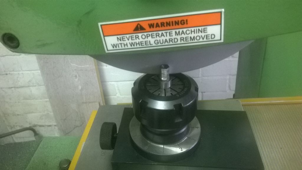

                    I eventually settled on using a Stevenson's milling cutter fixture to hold and index the cutter. The standard angled faces meant that there was a ready-made 2° angle available for the side relief on the cutter.
                    Grinding in progress:
                    Grinding the cutter

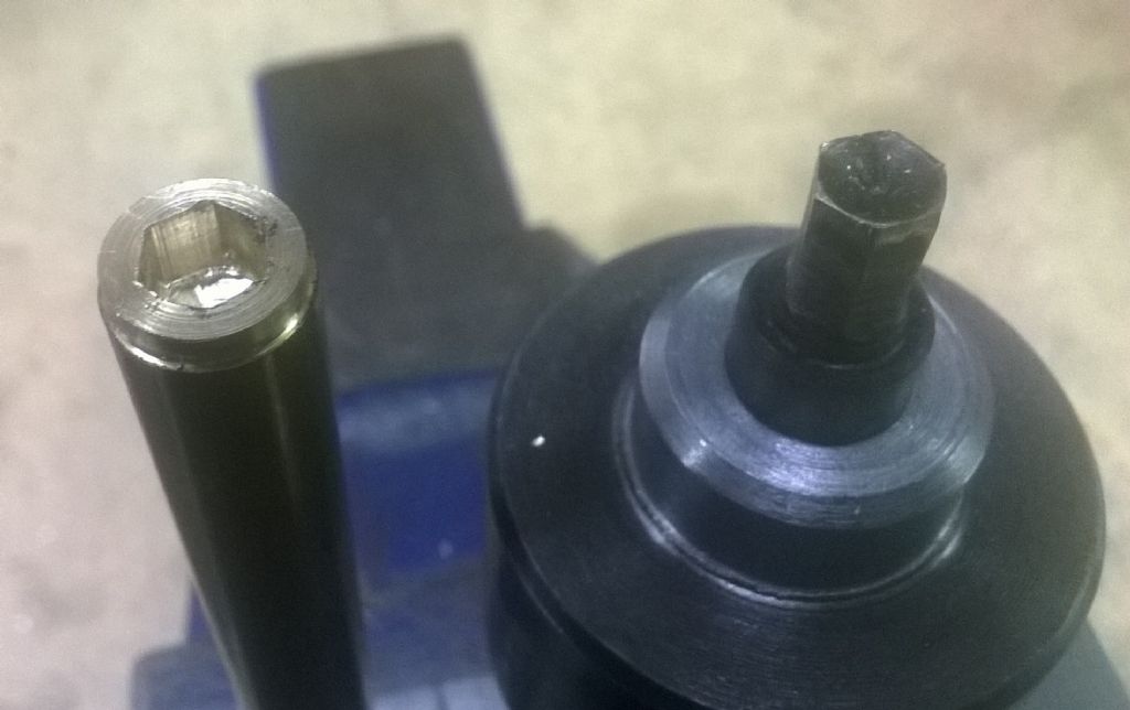

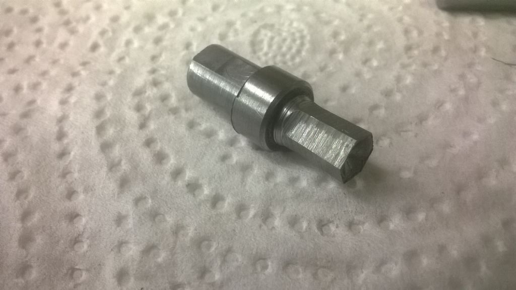

                      I watched a couple of YouTube videos about hardening and tempering as well as re-reading Mike Cox's how-to on his web site. Fired up the blowlamp (a Butane-fuelled one) and got the broach tool as hot as I could. Nowhere near as cherry as I thought it should be, but quenched it anyway, Straw coloured also eluded me for the tempering so I decided to try it out, anyway. Nothing to lose, I thought. The result is shown below:
                      The end product
                      Not a complete failure, but, as you can see from the state of the broaching 'bit', my efforts to harden and temper it were, shall we say, "less than optimal"! Perhaps I should have invested in a considerably bigger blowtorch rather than the frippery of the 6-jaw chuck! Doubtless the latter will get an awful lot more use than the former, however.
                      Despite the slightly disappointing result, I'm quite pleased with the outcome and will continue to experiment with other shapes and sizes of cutters from time to time and try to improve my heat treatment skills, or lack thereof.
