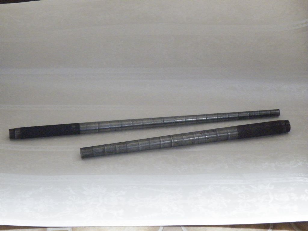

                      Hi John,
                      To make a ring that way you will need a ring triblet. One that I use tapers from 25mm to 8.5mm over a length of 310mm. The half angle of the taper is calculated as…
                      arctan(25-8.5)/(2*310)) = arctan(8.25/310) = arctan(0.027) = 1.55degrees
                      When I started making jewellery I made my own triblets; but instead of making a smooth taper I made them with a number of short steps with each step corresponding to a specific ring size.

                        Thanks Gary, that's something else to think about. I've just had another look at triblets on Cookson's website and frightened myself at the prices… I think I'll be doing some taper turning over the weekend! Thanks for the detail about the required taper, I also note your earlier point about there not being any 'set' taper and that triblets can vary.
                        If I get anything worth reporting, I'll post on this thread.
