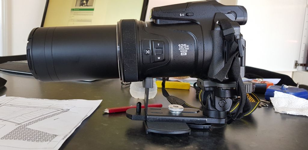

      Making a Nikon P1000 more stable
      #35959
      Steviegtr
        @steviegtr
        My take on making a large zoom camera more stable

                If ir works for you that is fine but…… The centre of gravity of the whole assembly is a long way behind the the support point of the tripod head. In my mind the whole thing is just too flimsy to give a stable support. You don't show your tripod but I wouldn't mind betting that it is not that rigid. For 12000mm lens you need absolutely rock solid support. A normal photo tripod can't do it.

                    Whoops , yes, you could call that a tripod but that is what I was talking about. It is far too flimsy, you need to get a substantial tripod, mount the camera near to its balance point and then you will get shake free pics. Trust me, I am an expert.laughlaughlaughangry

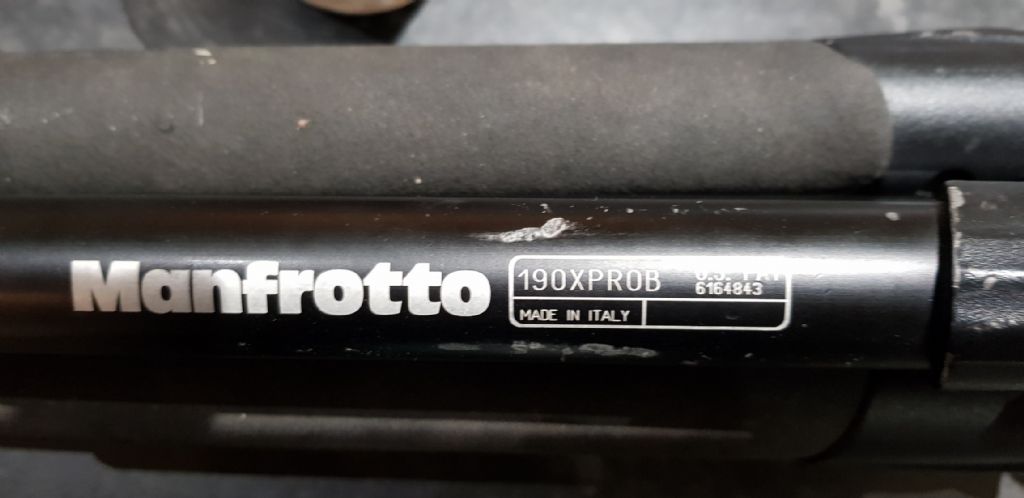

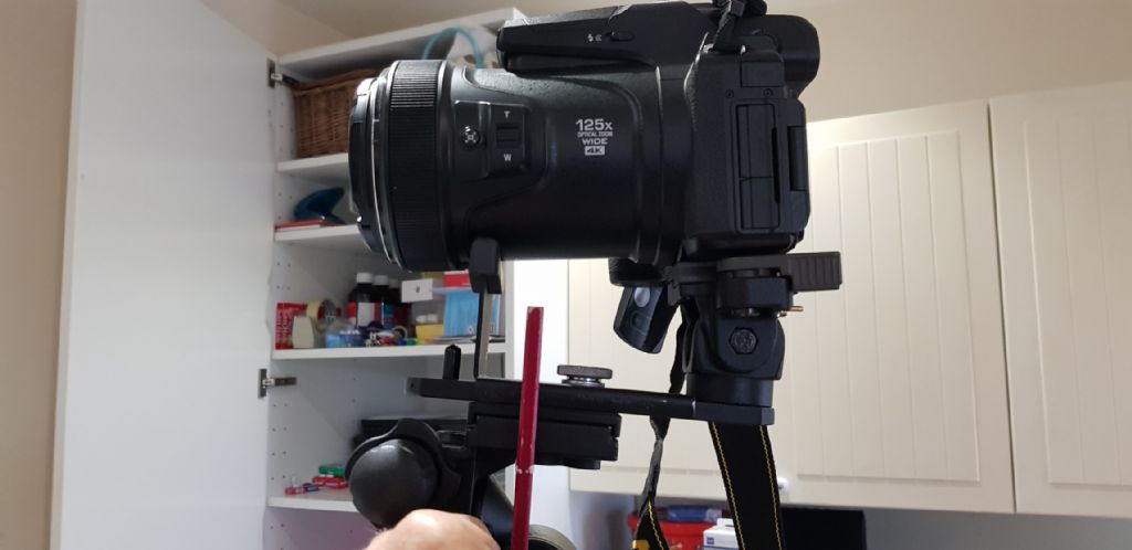

                          Thanks for the comments. I originally used my Son's tripod but it was very flimsy. This one is a cast alloy & quite firm. It is a Manfrotto model, well see the picture. Other than that I can confirm it is not bad. Before doing the mounting mod it was so front heavy , nearly impossible to stay on an object when zooming in. It does not dip any more. I do however have the remote control for it so I do not touch the camera when taking shots. I would love to get a star tracker motor drive but ( More blooming money). I did manage to photograph a sparrow on a chimney about a mile away. Before zooming in you could hardly even see the chimney stack. I do know the limitations of such a camera though, only being 16mp.
                          Norman the balance of the camera at half zoom is exactly where the fixing point is. Or am I missing something. ??? .

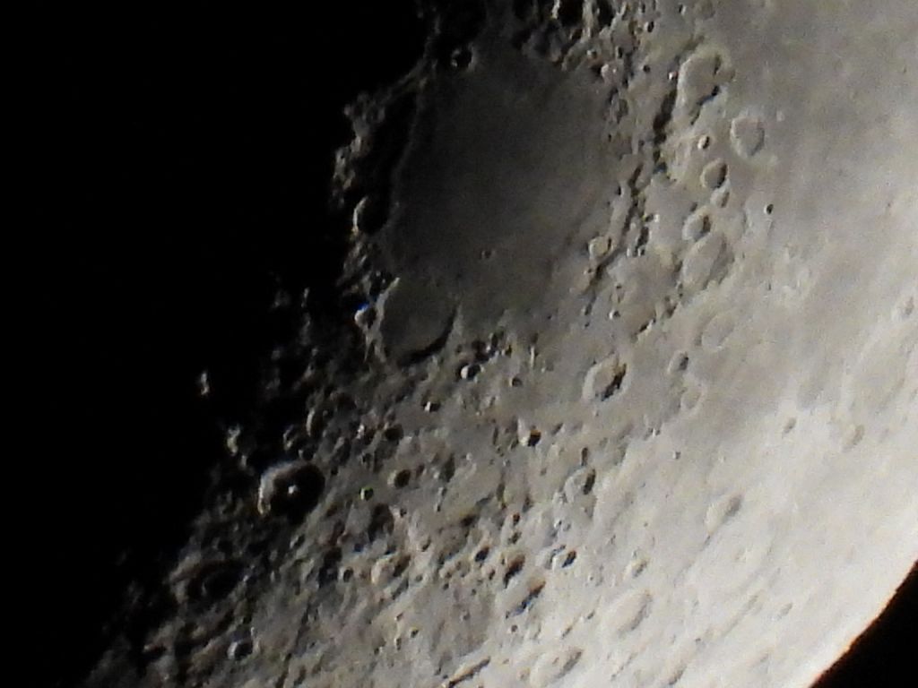

                            Some pics taken tonight with the flimsy tripod.

                              Steve, in your video, when you are pointing at the mount to show the centre of balance you need to take into consideration the top plate of the tripod. In fact your thump is pointing at the position that you should balance the camera around. Norman
                              At least that is how it appears to me, I could be wrong.

                                A bit confused here. The pic is where the centre point of the camera balance is, & that is where I have mounted it to the tripod. Ignore the alloy thumb wheel above it, that is for the slide to adjust.

                                  Yes, that is my point. I believe that it should balance directly above the large round shiny bit some way in front of your red line. At the moment it is hanging behind it which will encourage vibration.

                                    Hi Norman. When setting this up I did quite a bit of balancing to get a happy medium, as you can see with the camera on full zoom it becomes front heavy. By trial & error I came to the centre point where the camera was best balanced. See picture on full zoom. I have tried sliding for & aft & came up with the position in now.

                                            Sad to say, your pictures look great until you compare them with the view through a real telescope, even a cheap one.

                                                      That's not fair, I have seen far worse taken with far better equipment. This is an image taken with my Nikon bridge (not DSLR) camera:
                                                      Steve, to get results like that you take short videos to get between 100 and 1000 frames.
                                                      You can these use various free programs to stack the images and achieve results that will blow Old Mart's socks off:
                                                      For pre-processing (not essential but does make everything easier, it will crop your images to an area of interest or centre a planet/the moon and crop images to size:
