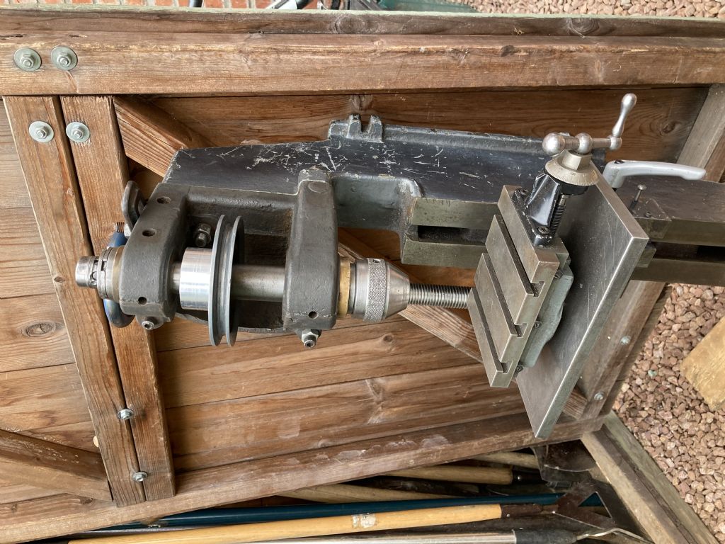

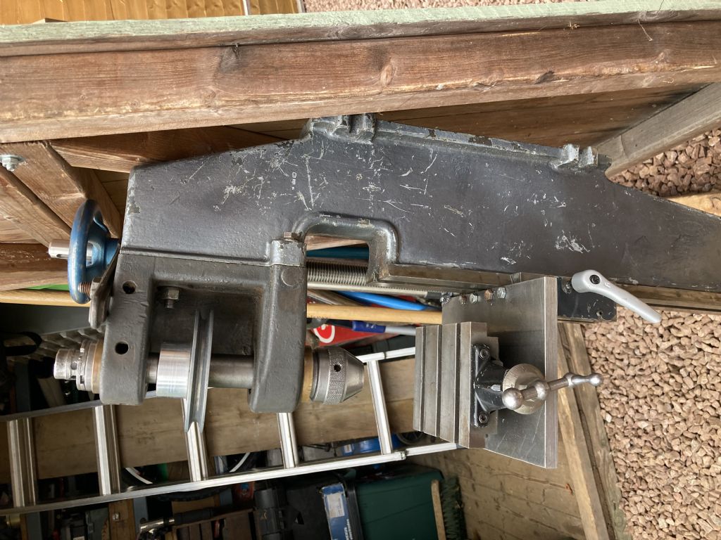

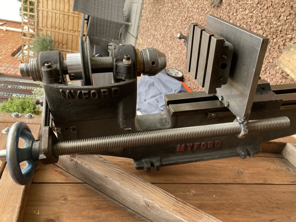

      69557da1-9f67-4083-b76d-bfbbe75258f4.jpeg8024411d-b1eb-4e67-92cc-1343f6ec997b.jpeg48a4c135-fe67-4f3b-9b5b-4bc445f0436f.jpegHi all I have some left over parts from several ML4 projects and wondered if I could make a small mill out of it see what you think it’s just roughly put together

        Bit and bobs

          I didn'trecognise it at first, just the name MYFORD. It shows promise for small work, just hope the purists don't get to see the pictures.

            Oh I know but it has had a good life and was no longer useable as a lathe so I think it will with more work turn out ok for my needs

              Is there any Y movement?

                Ah, the Y movement does need a lot of thought. The knee would be smoother if the leadscrew could be fitted underneath on the centreline,or maybe behind the spindle running between the bed ways.

                  At the moment I have just the ability to rotate the slide but I intend to get something better on the table.

                    Maybe it'd be better to stick the table onto a very solid and heavy base, and use the leadscrew to move the (whole bed & ) head up and down for Z?

                      Top many flimsy/badly positioned items, e.g., leadscrew.
                      'Orses for courses.
                      Your cheapest bet would probably be to join a club that had a workshop including a mill.

                          Yes I have done this but it’s always a pain so as I had a collection of odds and ends I thought let’s have a go remember it’s just a mock up and would need stiffening up but I think with a proper X an Y setup it will work three phase motor and speed controller as good as a cheap bench mill

                              The throat depth would be easy to increase if necessary by having a spacer between the head and the bed.
