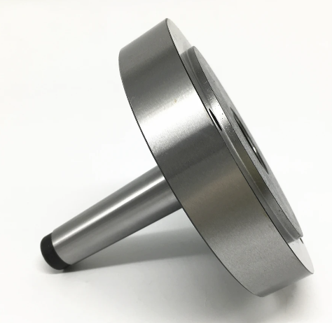

              #725452
              Sonic Escape
                @sonicescape38234
                This must be the simplest way to make a fly cutter. A thick chuck flange with an MT5 arbor already attached to it. Unfortunately is also the most expensive option…
