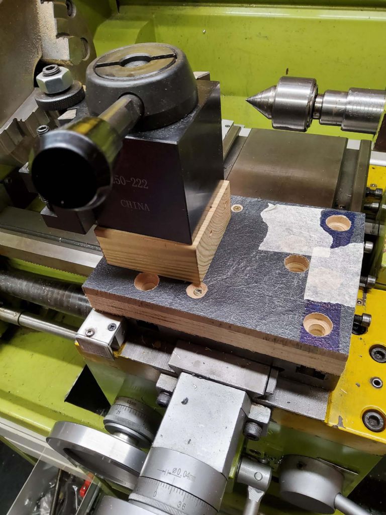

      Posted by Clive Foster on 26/02/2023 11:31:08:
      The OPs idea of using wood will do as a quick way of seeing what works and verifying useful positions but anything other than the lightest cuts will prove disastrous. Maybe with a piece of delrin as a test piece. On metal. How lucky do you feel today?
      Clive
      Not very
      #635087
      petro1head
        @petro1head
        Posted by Tony Pratt 1 on 26/02/2023 11:31:42:
        Why not make it square as per the 250-222 tool post [if you can]?
        Tony
        I did wonder and its just as easy to make.
        I wonder if I go back to the wider plate would be batter, ie easier to remove/slide if needed as the locating holes with not be obstructed by the tool post?

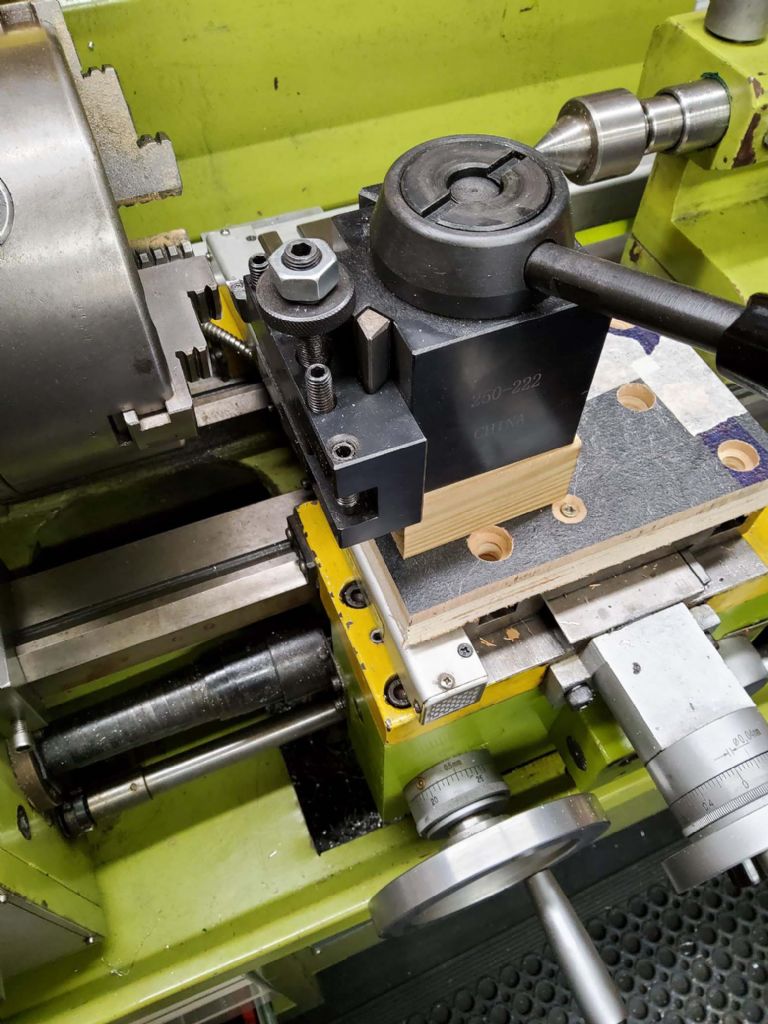

        #635095
          How close to the chuck can you get with that wooden block there? don't think it will pass under the chuck like the DRO does.
          I'd make the riser a bit bigger dia than the wooden one so it goes out to the corners of the toolpost.
          #635109
          petro1head
            @petro1head
            Posted by JasonB on 26/02/2023 13:06:01:
            Cant see that being any different than having the compound slide on.
            I think this is my final design
            #635122
              Not so much in that position but try it when toolpost is fitted using the righthand hole.
              #635126
              petro1head
                @petro1head
                Posted by JasonB on 26/02/2023 15:38:34:
                Ah, I think I understand now, thanks, let me have a measure and get back to you.
                EDIT:  Just had a look.  The gap between to chuck and the dro is only 5mm and once the jaws are open would hit anyway.  Again something I have never had a problem with.
                So going to stick with it.
                Thanks for your input, again Jason

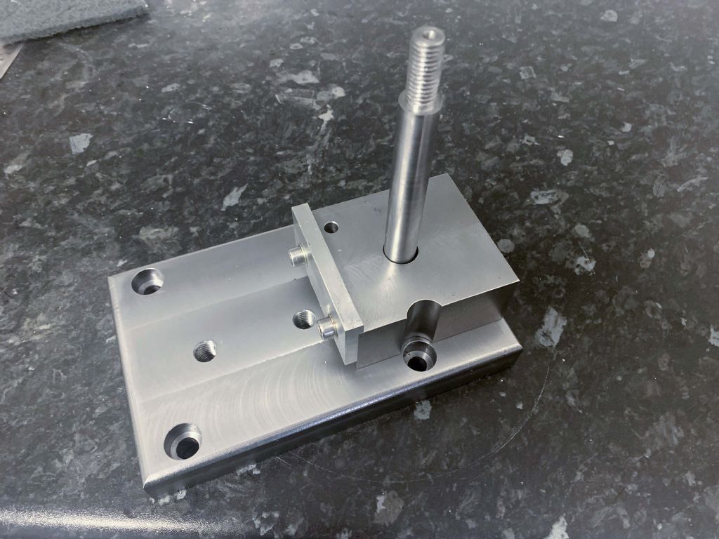

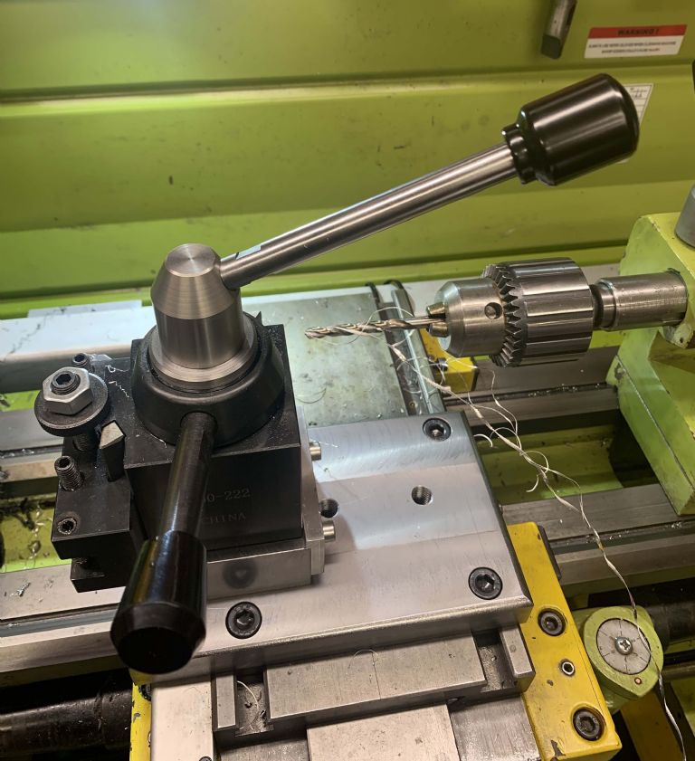

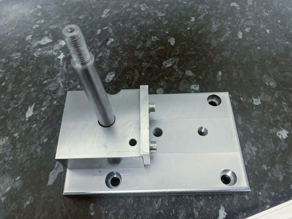

                #635446
                petro1head
                  @petro1head
                  Here we go

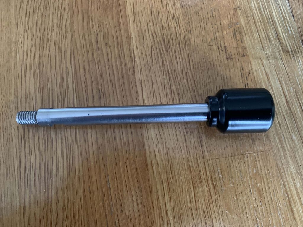

                  #635695
                  petro1head
                    @petro1head
                    Handle
                    First Use, very pleased and very much enjoyed the project.
