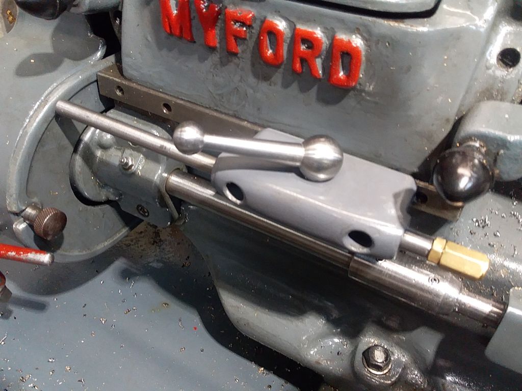

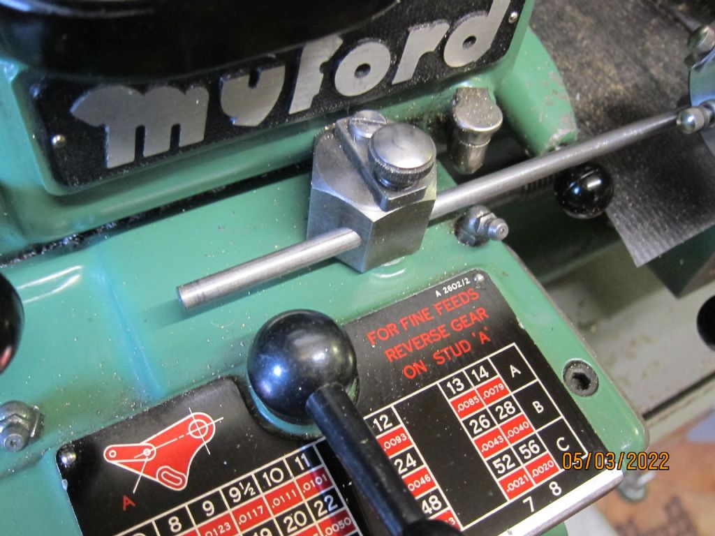

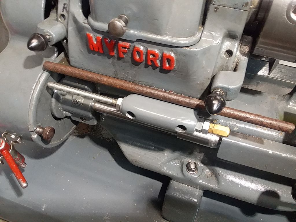

Well, all the excellent examples in this thread have shamed me into upgrading my "permanently temporary" stop with the threaded rod and nuts. So have made a plain rod and a GH Thomas style ball handle and brass cotter clamps bring it up to snuff. A bit more forgiving in the event of a crash as pointed out, and looks better than that bright zinc plated hardware store threaded rod. And its much quicker action to set than faffing about with nuts and spanners. So now I can whiz it out of the way to get the oil gun into that leadscrew oiler at the left.
The finished unit

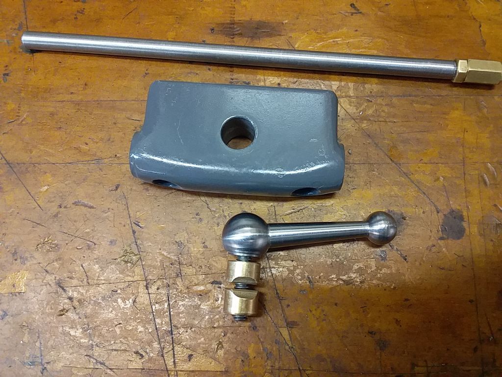

The parts:. Making the ball handle is always an interesting exercise but very satisfying when it's done.
The naff old threaded rod, and the nasty piece of rusted 3/8" bar I had to turn down to 5/16" for the job. Our only steel merchant here does not stock bright mild steel bar under 1/2" and shipping is too costly to buy online so it was out with the moving steady and a big dose of patience. No matter how you set it up, that steady gets in the way, of the tailstock, of the chuck, of the toolpost, of the bolts on top of the toolpost. Eventually turned the first inch or more down to size then set the tool ahead of the steady so the steady followed on the nicely machined surface, not that awful rusty surface ahead of the cut.
