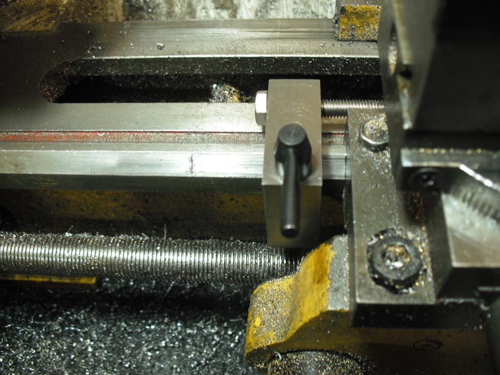

                    @steviegtr
                    It would seem this item will not fit every version of the Myford 7 lathe
                    Here is a photo for those not wishing to watch the build. The serial No indicates 1975 to 1979 era.

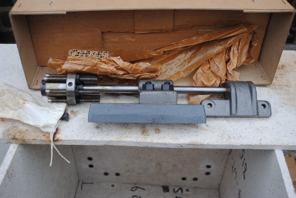

                                    Here is a design I bought from Myford.
                                    regards Martin

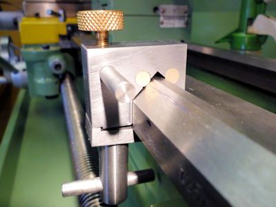

                                      Not a Myford, but my mini lathe.

                                            Here's mine. I thought I'd avoid any flack by not showing the 45 second video I didn't make of me drilling and tapping one 8mm hole. smiley

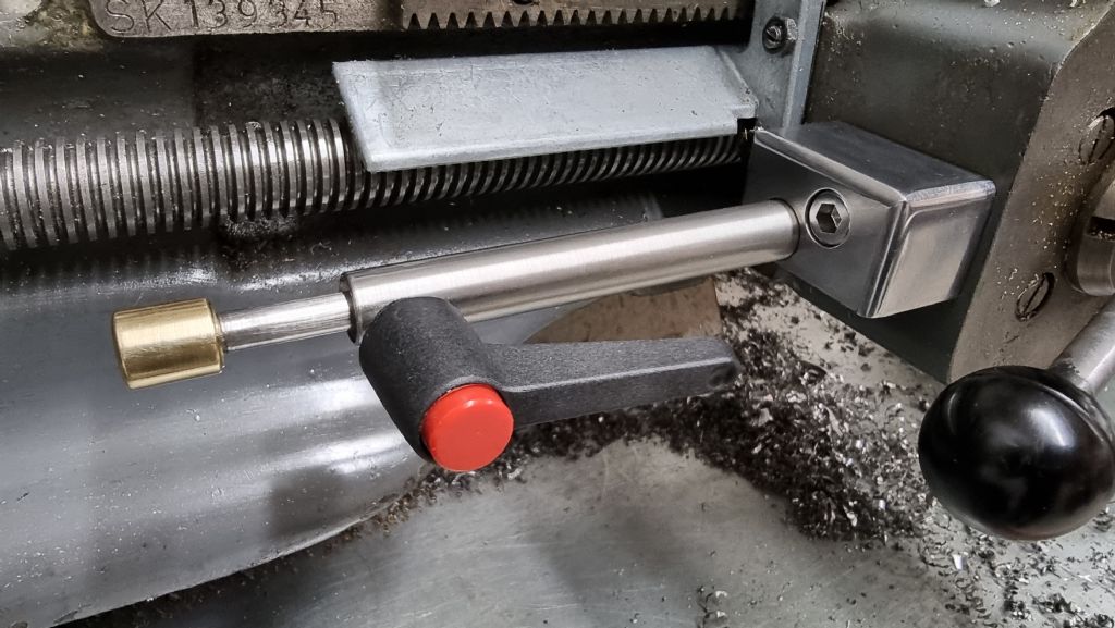

                                                    This is my answer to a gearbox fitted Myford S7 making use of the tapped hole provided for the oiler. It has provided satsfactory service over many tears.

                                                    Steviegtr
                                                      @steviegtr
                                                      Hey Greensands. That looks great. Not seen one like that before. yes
