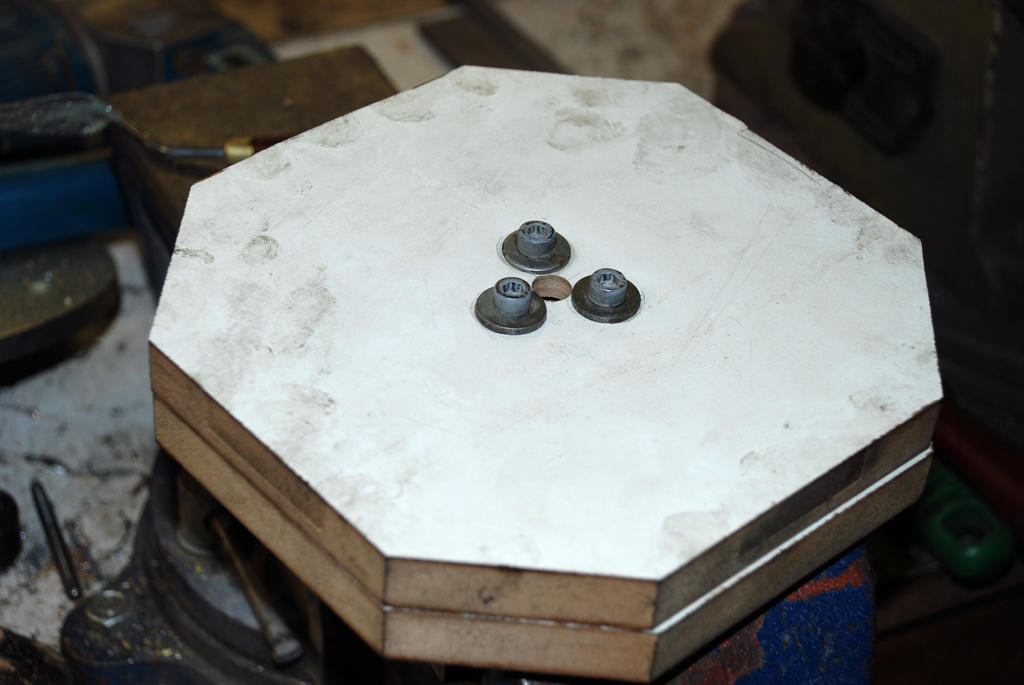

      Some sort of tooling would be required to support the belt and centre it with the steel shaft collar that is to be molded in, the simpler the better. I assume that most likely only one or two units will be required. This is not a commercial alternative process; it is for “One offs”.

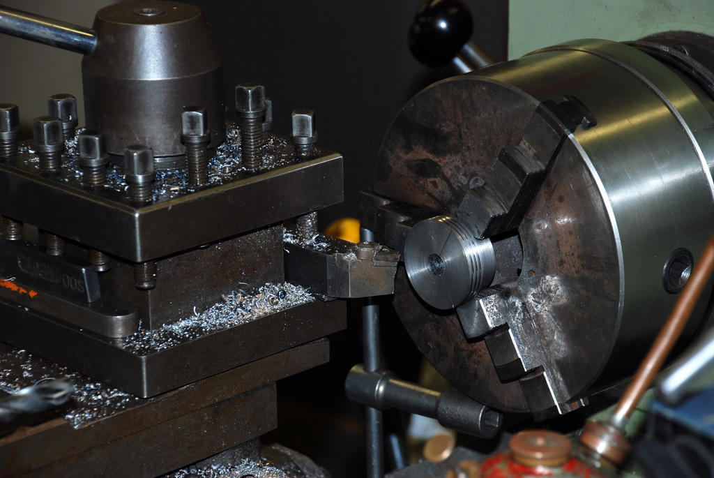

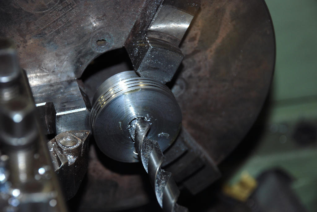

      First the steel shaft mounting collar was rough turned with an undersize bore. The collar was also drilled and tapped for 3 x M6 cap screws to be used to secure the centre in the mould and allow fine boring in position.

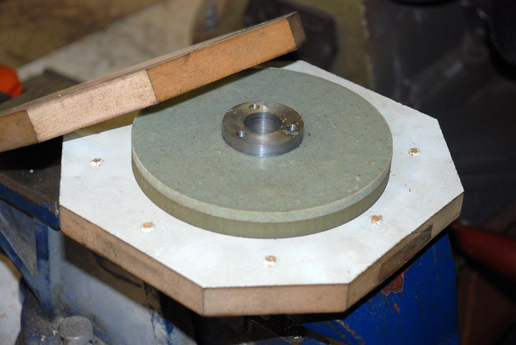

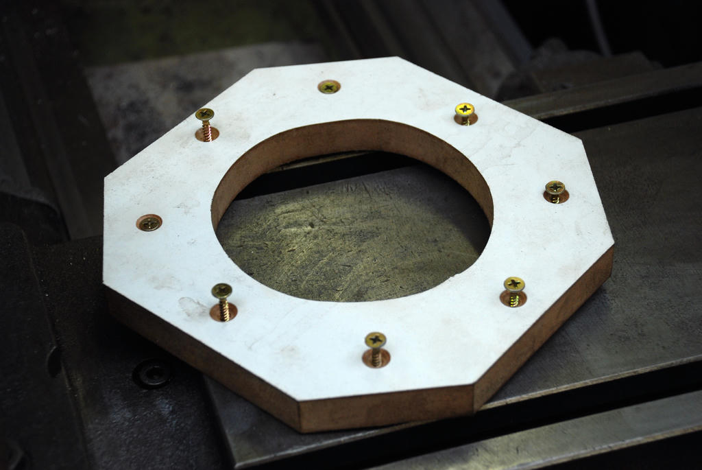

      For the mould I have used melamine coated MDF scraps that were to hand. A backing piece and an edge piece with a large hole (about 10 mm less than the timing belt diameter) were cut using woodworking tools. The edge piece was securely screwed to the backing piece. (Drill a bare clearance hole in the edge piece for the screws and countersink both sides, to accommodate any bulging of the backing piece when the screws are driven in. MDF must always be pre drilled if you want it to sit flush)

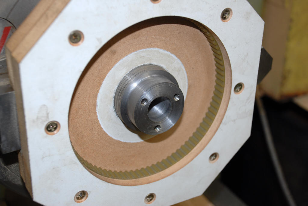

      The shaft mounting collar was then mounted in the centre of the MDF mould with 3 M6 cap screws and washers.

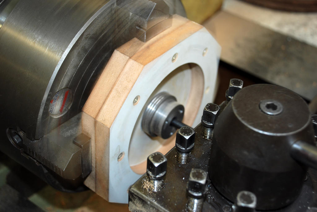

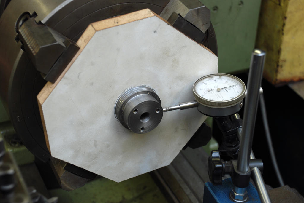

      Ideally I would have liked a face plate to mount the mould on for finish turning in the lathe. I do not have one so used a large 4 jaw chuck.
      As shown in the attached photos the shaft mounting collar was centered in the lathe using a dial indicator. Once set it was a simple matter to bore the steel collar to final shaft size, skim turn the rest of the OD of the collar just to make sure it was dead centre and the faces planar and turn the inside edge of the edge piece to an exact fit with the timing belt. I also skimmed the back of the mold to correct a slight wobble. (I wish I had that face plate).
      The result was that we had everything including the belt concentric, all turned in one setting on the lathe. The belt just slipped in snugly with light finger pressure. Once all was rechecked the pattern was removed from the chuck.

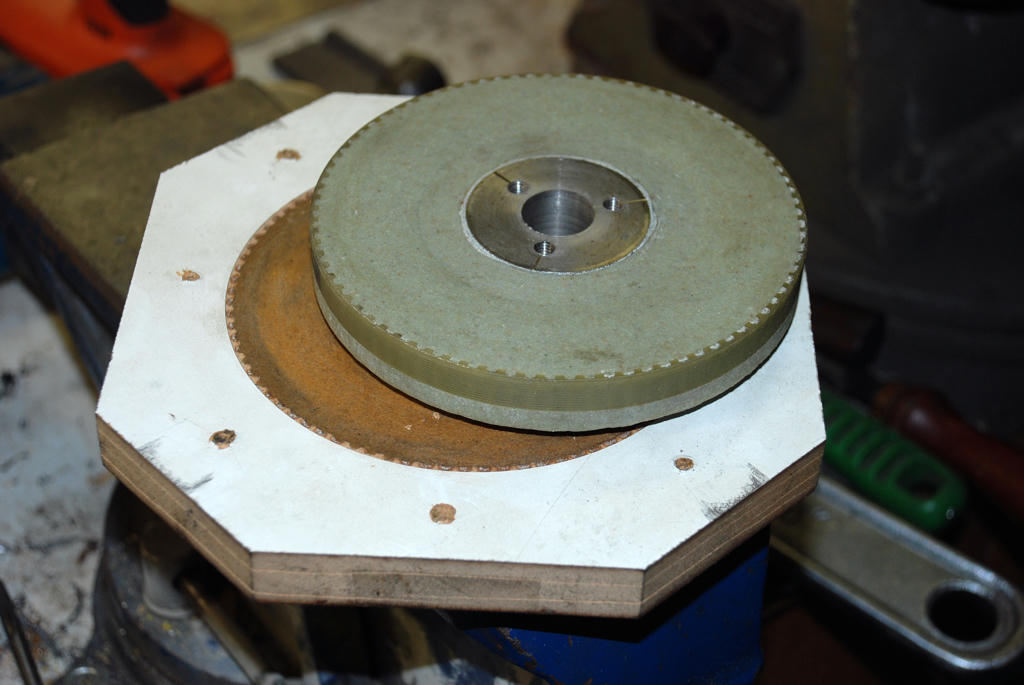

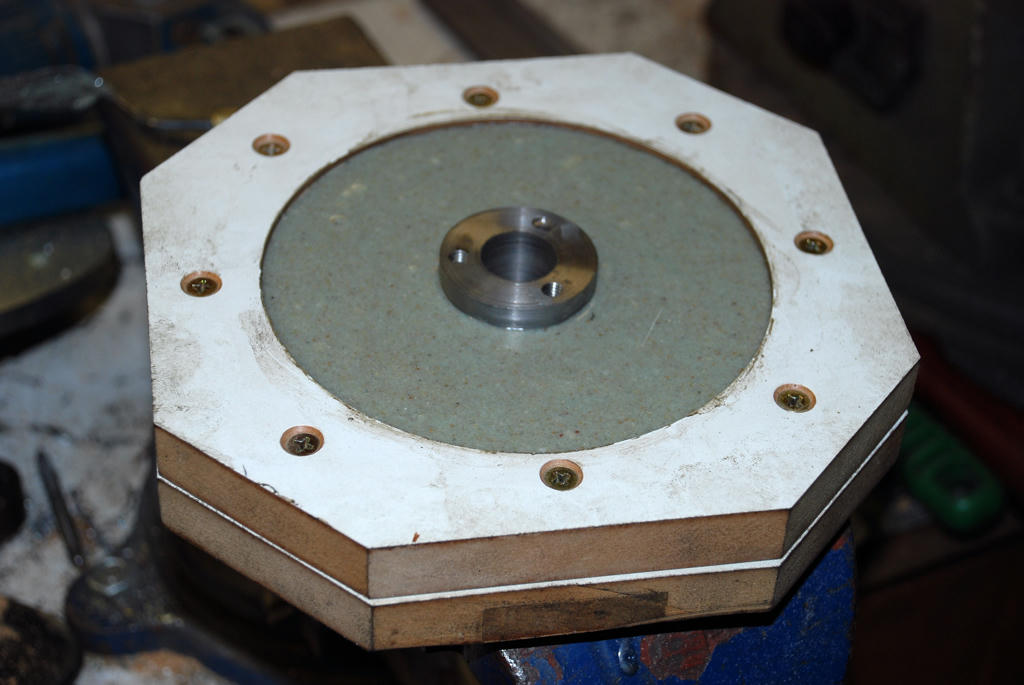

          The Epoxy mix used about a cup of fine washed and dried sand and a third of a cup of Megapoxy H as I have used in other posts. This is a stronger mix than I usually use. Once poured it was placed in a domestic oven at 90 degrees Centigrade for one hour. If you can apply heat you do not have to wait overnight for the cure. For mould release I used PVA glue spread thinly and allowed to dry. For extreme accuracy the preferred method is to allow a natural cure. The part will shrink more on cooling from a high temperature than ambient. In this case I wanted to see the result. However it takes two hands to get the belt back on the pulley the fit is far better than you get on the average commercial pulley.
          Stripping the mould was relatively easy. As usual it was damaged. MDF moulds have to be replaced each time. No problem it was just scrap.
          The most difficult part was the belt itself. Being polypropylene I knew it would not stick well to epoxy. That does not mean it does not stick at all. I had to gently place a small pin, I used a safety pin under each tooth to lift it clear of the epoxy; It took about 15 minutes to coax the belt off.
          As molded the pulley has one retaining lip edge molded in I may need to make another from steel depending on how the pulley is mounted. In this case the belt was in stock and it is only a test. For the next one I will make the retainer from steel sheet, place it in the mould before the belt and cast it in.
          For finishing it is quite easy to turn the epoxy sand mixture on the lathe. A carbide tip that is past its prime is fine, no need to blunt a new tip. As shown it has not been finished, it is “as is” from the mould. I did not add any colour to the mix so the colour is just the greenish sand epoxy colour. There are plenty of concrete colouring oxides (It must be the dry powder type not the liquid type) If you want a special colour. I rather like the colour as is.
          The result achieved so simply is outstanding. The tooth profile is a superb match for the belt.

          Marking shaft mounting collar

            The base plate with collar attached was centred
            Edge plate prepared
            Fine boring the Mounting collar
            Skimming the collar
            The edge plate bored out and belt fitted inside
            Poured!
            Collar attachment screws to be removed
            Edge plate removed
            Removed from the backing plate
            Belt removed….We have a timing pulley.

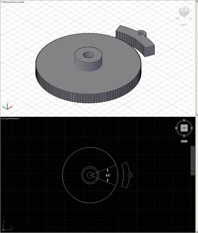

                          One thought that came to mind for an indexing table would be to use a belt or a cast gear with a matching cast “Segment”, I had a play with the test pulley and belt. The test pulley has 120 teeth I found that you can lift off a section of the belt well over a quarter of the diameter of the gear. (The stopping point is when the angle of the tooth side faces reaches the point of undercut) Does anyone want to develop a formula for this?
                          Anyway empirical methods will do for the time being! And getting back to an indexing table concept, the (Cast in filled Epoxy) segment would allow in this case about 30 teeth engaged. If the segment were attached to a table locking mechanism, possibly a pivoting arm or a slide, an extremely rigid connection would result; capable of taking any likely cutting load.
                          After disengaging the lock the table can be indexed one or more teeth at a time. With the accuracy improvement, a benefit of multiple teeth engaging averaging any errors, similar to a “curvic coupling”

                            The tooth angle is 40 degrees included.
                            Cheers
                            #74178
                            John McNamara
                              @johnmcnamara74883
                              Hi All
                              A quick investigation of the cast index lock using CAD revealed that the correct angle is 40 degrees. That makes sense. I drew a design using 44 degrees as the undercut angle on the end teeth is very small and that gave an extra tooth. If there is too much interference that tooth can be filed down.
                              As shown 15 teeth are engaged with the 120 tooth wheel as cast in the first post, maybe that will end up 14 teeth. In both cases a good result. It will create an extremely strong, and very accurate positioning lock.
                              The drawing does not show it but I think the segment should be steel backed with a cast in place reinforced filled epoxy face.
                              The same method can be used with a steel gear.
