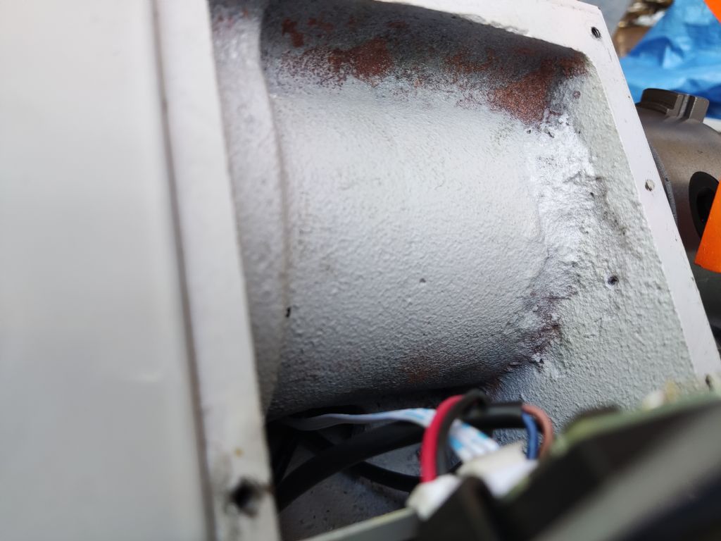

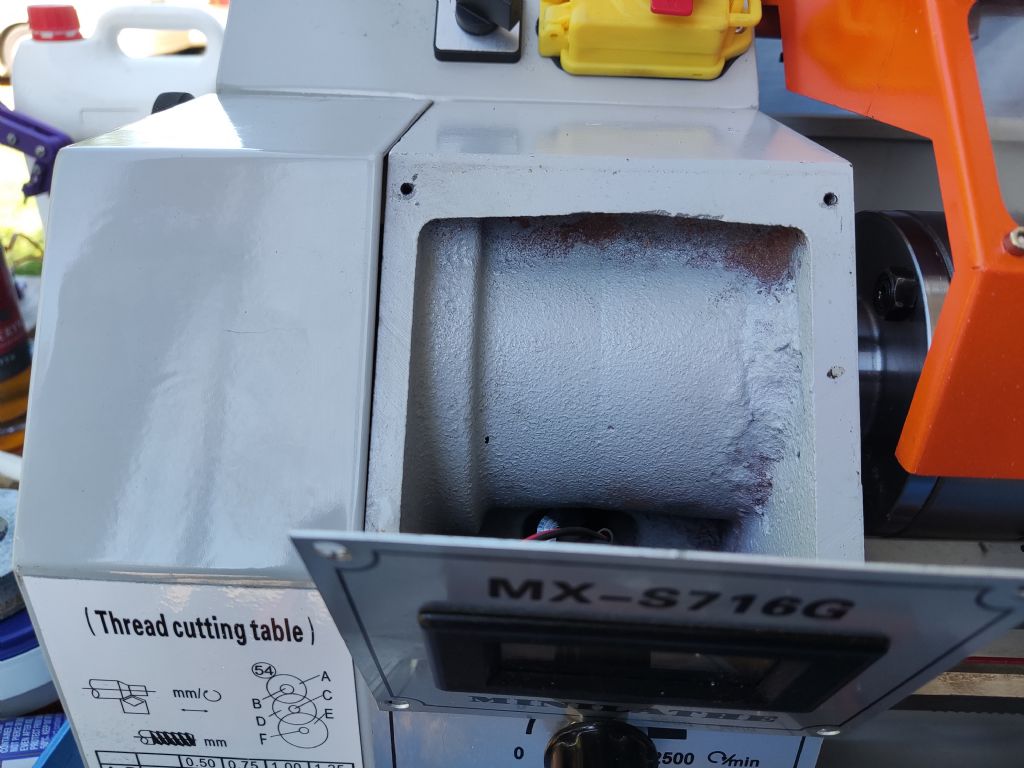

      Thanks for confirming the motor is wrapped around the spindle, if you have time a few photos with the end cover removed would be interesting as would a short video.

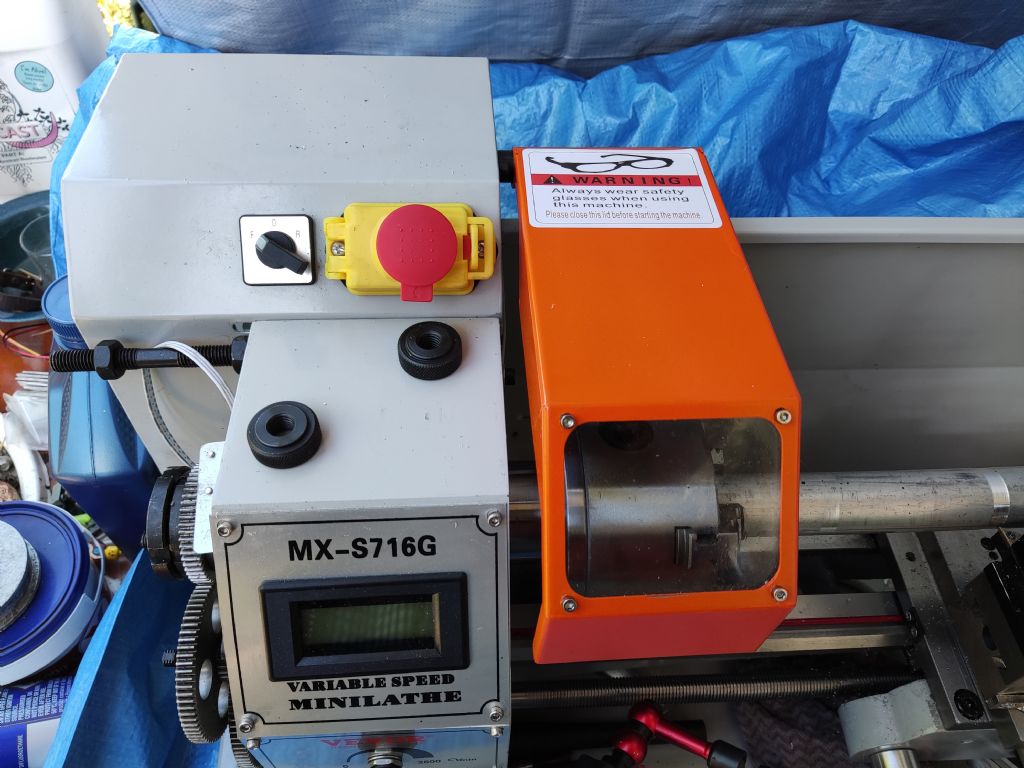

          But…. photo's…
          Given its size, I thought the motor must be in the big box at the rear…
          Box
          But no, it was empty,,,
          It seem the motor is, in fact, around the spindle…
          another angle…
          Small, isn't it? (let's hope it lives up to its hype).

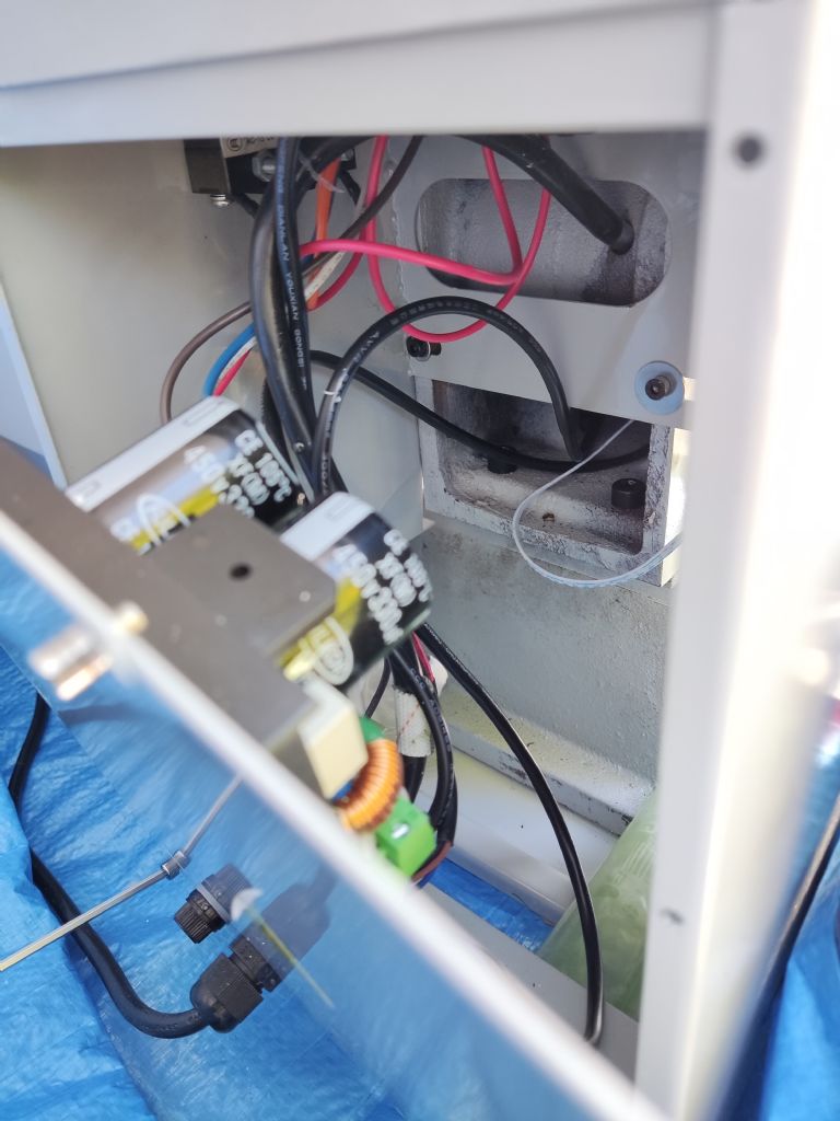

            Such a compact "800W" motor, yet no cooling provision – do they use the headstock casting as a heatsink ?
            Could you confirm how many wires are contained in the cable from the motor. What passes for an electrical diagram in the EU Vevor "manual" only shows 2 wires to the motor, but I would guess 3 or 4 (3 phase motor with maybe an eath direct to the stator).

            #643906
              As it is a brushless motor more likely to be 7 or 8 allowing for the sensors etc. Probaly run as two cables one for power and another for control, 4 cores to each.
