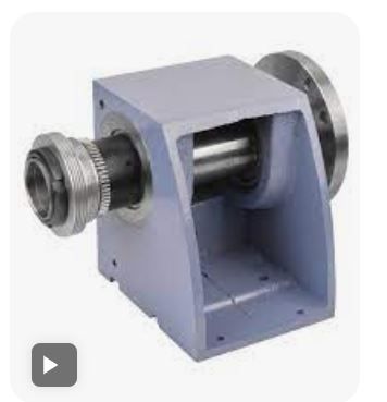

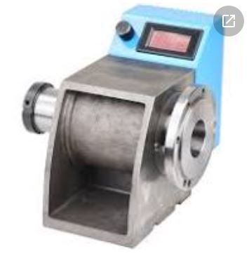

                No sign of gears on the AliX one
                This is the usual far eastern headstock just an empty box with bearing pockets each side
                This is the one with built in motor, note the large hollow housing between the plates and the left end has a large flange to allow motor to fit inside casting. Controls built into the back. Go search for it on google (images will find it)
                Edited By JasonB on 02/05/2023 16:55:23

                      If the spindle has 2 lock nuts or a slitted nut, than it is probably fitted with contact angle bearing that can be adjusted. Unlock the nuts and adjust the play by locking the nut (just use your fingers, no tools). This will apply some preload on the bearings and will reduce/eliminate play.
                      When you measure play, place the indicator on the top of the head stock, not the bed. You don't want to measure bending of the bed or play because the head stock is not tightened to the bed or the chuck is lose.
                      Put a bar in the spindle, lock the spindle and measure the play close at the spindle. Measure the horizontal and vertical play. To measure play, you don't need a lot of force. 2 kg/4 lbs is more than enough.
                      You can also check the documentation about the type of bearings used in this lathe.
                      A picture of a slitted nut, my favourite for locking/preloading contact angle bearing shaft.

                          Edit: __ Check the shiny picture of the motor
                          … I can’t see that having a hollow shaft dont know

                                      But presumably you have not yet studied the illustration of the motor
                                      Edit: __ There is a downloadable manual on the EU web page … But still no exploded diagram

                                        I would not worry too much about the photo, Vevor regularly use ones not related to the actual item.
                                        There are a few more examples on the net not just the Aliexpress one I have mentioned and all look to be able to pass a decent size workpiece through the spindle (assumeing images are correct.) some of the the 8×16 lathes also seem to have this direct motor
