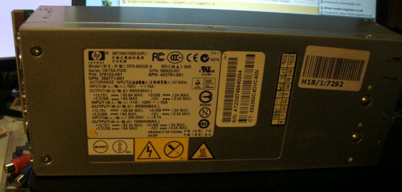

                            psu1.jpgmy own supply was the local auction house – I paid ?50 for 10 HP new 85A server PSus still in packaging – last week I bought another hp type DPS 800GB A for about ?4 – all in a box 250mm x 85 x 50mm – the two small fans are noisy (but you can slow them if you only want a miserable 10-20A – the other slight problem is buying the edge connector – but you can solder directly to the edge connector – you may need to search for the connections however as these don't come with instructions.
                            But just search for hp switching power supply for servers
