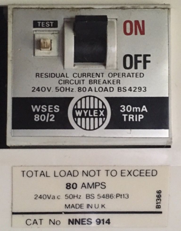

              Michael, you must have a pretty old electrical installation if you still have a voltage operated ELCB (Earth leakage circuit breaker), more modern device is an RCCB (Residual current circuit breaker).
              I suspect you have an RCCB (or RCCD or RCBO) in the consumer unit as voltage operated units were almost always stand alone units.
              Emgee
              #418004
                Posted by Emgee on 09/07/2019 09:30:50:
                You are right, of course
                Disgracefully sloppy of me blush
                For my pennance, I climbed the step-ladder and photographed the grubby device:
                Shall I be forgiven ?
