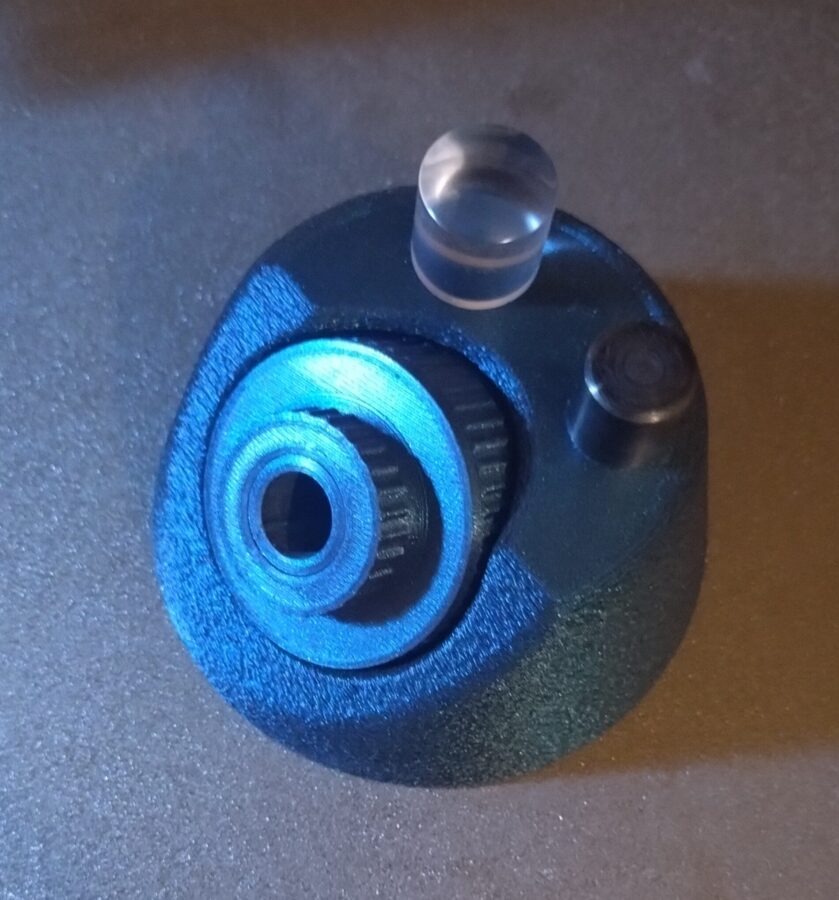

                  I did however make a second shorter one with a slightly larger bore. The reduced height allowed for a a R20 lens with larger magnification.

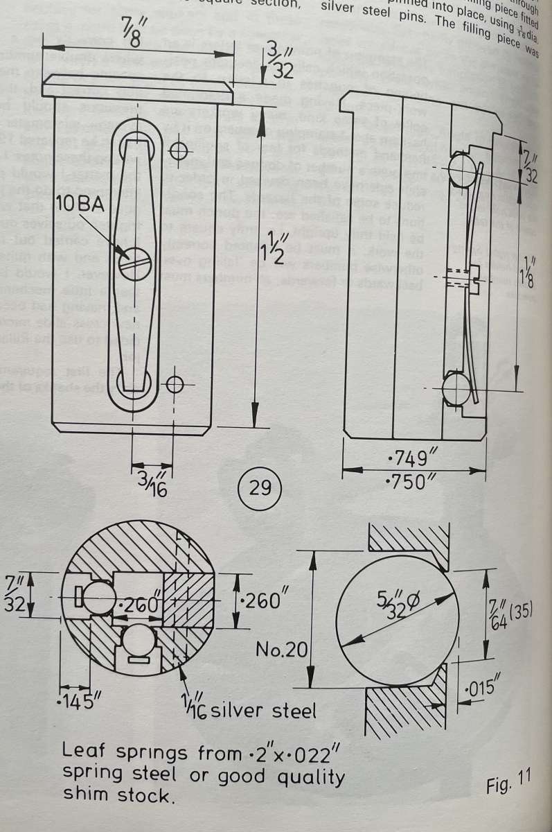

                        I seem to recall that GHT did something clever on punch-holding [in the Universal Pillar Tool book]
                        … if no-one beats me to it, I’ll have a look tomorrow.
                        #785604
                        bernard towers
                          @bernardtowers37738
                          yes its sprung on two adjacent sides so the punch is always used to one corner. I have made it and as you say clever.
                          #785687
                            For info.
                            Not only is this a masterpiece of design and execution, but the drawing itself is an exemplar for what we should be expecting to see in ME&W
                            IMG_0247
                            Credit. __ ISBN 0 85242 785 9

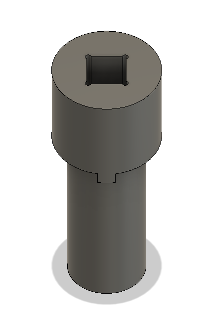

                                Here’s my plan so far, a simple printed guide with a small peg for alignment. I’ll also need a new lens with a peg and a inscribed square rather than the crosshairs on the center lens.
