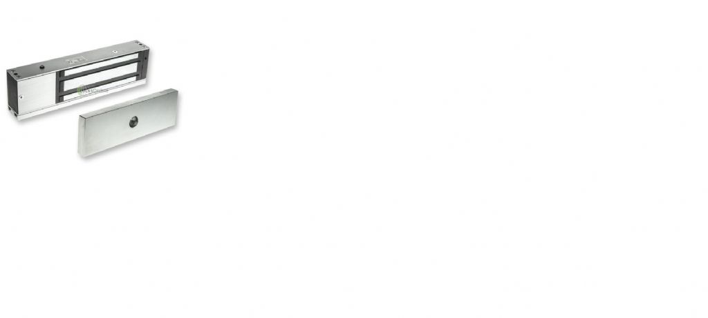

      Just thinking aloud, would it be a good idea to convert a door maglock for use as a magnetic milling vice?
      **LINK**
      I have seen some maglocks with holding power of about 500kg, for thin or irregular shaped work pieces should be more than enough clamping force… To be honest I'm tempted but before doing something silly I would appreciate your thoughts wink

                    Posted by Martin Connelly on 19/06/2018 23:17:59:
                    The lifting power of Bux lifting magnets is very dependant on the thickness of the material it is being used to lift. Thin materials reduce the load that can be lifted. I suspect a door maglock may have similar issues. This is why magnetic tables for machine tools are usually multi-pole. Is the maglock multi-pole? What is the plate used with maglocks like?
                    Martin C
                    I think it's a single pole DC electromagnet magnet, the plate is 16mm thick and on that plate it gives a hold down force of 550kg.
                    It also depends what machining operation is being carried out I think, say, you will not use it to hold a workpiece you're flycutting, but maybe if using a small endmill the forces would be lower?

                                        Here's a bit more Chris,
                                        Another issue came to mind, particularly with what can happen when machining BDMS (bright drawn mild steel). Skimming a surface of a rectangular bar of BDMS can release built in stress sufficient to cause the bar to bend. Insufficient hold down force would allow the steel to lift towards the cutter.
                                        That aside, and since we are talking about an electromagnet, I can’t resist describing the situation in the tool room back in the early 50’s. There were three surface grinders. The chucks on two were electromagnetic, and the third had a chuck with permanent magnets.
                                        The shop’s workhorse surface grinder (with an electromagnetic chuck) was driven from a counter-shaft running the length of the shop. A 10 hp electric motor at one end of the shaft provided the power. Imagine, in the middle of grinding a workpiece, the urgency when there is a power cut. It happened on more than one occasion.
                                        One chap was grinding a line of steel inserts secured to the chuck when the power went off. The chuck let go, and the still spinning grinding wheel propelled the line of inserts against machine’s end guard like bullets from an automatic machine gun.
                                        More food for thought eh?
                                        Sam
                                        #358778
                                        ChrisB
                                          @chrisb35596
                                          Hi Sam, yes that is one of my concerns if I had to consider going that way (which after reading through the replies on here is very unlikely!) But if I had to go ahead, I would for sure connect the magnet to a UPS or a battery, although I would not be much worried about my wm18 with a small endmill on it, ramps down pretty quick when turned off.
